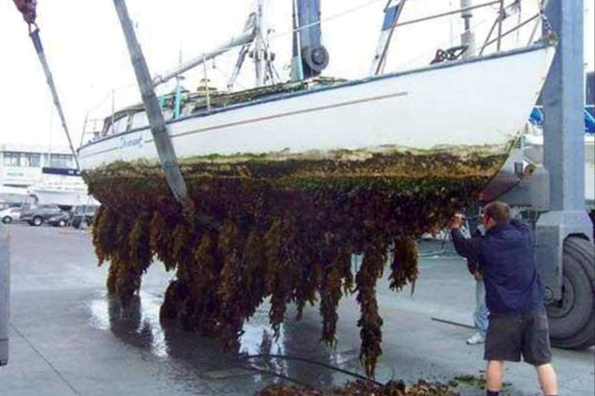

There has been a bit of drift in your question. Images help to give perspective to your question.
Is this the condition of your boat bottom?:yikes:
This would be extreme...
Thauinkfully not my boat:biggrin:
Im guessing it something like this. It was a dock sitter for many years before I purchesed the boat. She was sailed at one point as there is a spinker pole on board. 1974 vessel. Im in oklahoma, my guess is some of it dies off each year when the lake turns cold. Perhaps keeping the growth in "check". I talked about the cleaning the bottom and folks at my club said "just sail it".
At some point the bottom needs attention, right? I imagine I should get a new keel line at some point. I am trailerless at the moment but I have access to trailers to haul the boat out to put on jack stands or hydrohoists are available for inspection and light cleaning. Right now it looks like hydrohoist for a day, then put back in water. I would like to avoid suprises such as "now it can't go back in the water there's a hole in it now"
