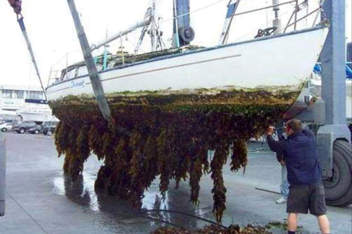

I have a boat that has been in the water at least 10 years possibly 20. On a freshwater lake with higher salinity level. If clean the bottom off, do I run the risk of having to repair it? Is the algae keeping my bottom sealed?

I'm assuming the boat is made with fiberglass. After sitting in the water for 10-20 years, there's a good chance that the boat has blisters on the bottom. If it has a proper barrier coat on it, you might not have any damage. I doubt that algae will seal the bottom. There's only one way to find out for sure. Pull the boat and start scraping.
Algae doesn’t seal it.
After you clean it, you’ll see whatever condition it is in. It’ll be the same as before, just cleaner and youwill be able to see it.

I agree with the others that there is no risk in hauling the boat and removing the algae. At a minimum you’ll probably want to lightly sand and repaint to inhibit future growth. Depending on the condition of the existing paint and gelcoat (whether the paint is peeling or if there are blisters in the gelcoat) you may need to work further before repainting. In any case you won’t be any worse off having hauled it, just maybe more aware of what defects are there.

20 years? Don't touch it! The fiberglass, at this point, has almost certainly been completely replaced by the algae. You will dissolve the hull if you try to clean it. Kidding. You really need to pull the boat out of the water and clean and repaint and fix any blisters. In the meantime clean off the algae in the water. The problem is that, until you repaint it, the algae will regrow on the hull very quickly.
No. If it were my boat, as recommended by the other posters, haul out and pressure wash the bottom, which should expose any necessary repairs, such as blisters, pockets, etc. If that part checks okay, my next step is to prep the hull for two coats of ablative bottom paint. Prep the hull depends upon whether the hull has ever had bottom paint applied. Different steps apply in either case.
