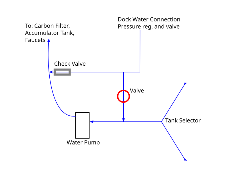

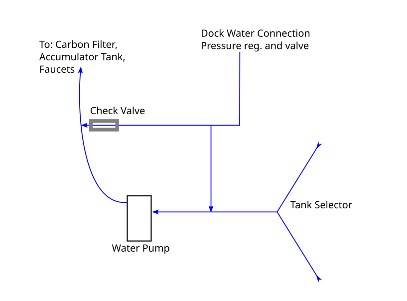

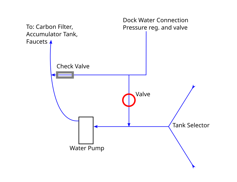

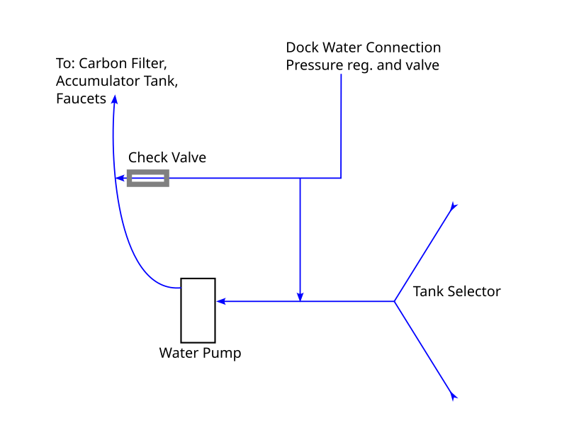

I have dock water plumbed into my lines. Boat connection is in the cockpit, where there is a pressure reducer and an on/off valve
That line connects to the interior host just downstream of the 12V pressure pump. Check valve at the T. Just before that check valve is a T that sends water to the tank selector valve, then to one of the two tanks.
With this system, I can pressurize the potable water system when at the dock and I can use it to fill the tanks (I have deck fills also). It doesn't matter if the 12V pressure is on or off, when the dock water is connected, that pressurizes the system, causing 12V pump to never activate.
Yes, it can sink the boat and one must turn it off; I do whenever I leave the boat. If just quick run to the shore-side head, I turn off at the dock pedestal. When I leave for the night, I turn off the valve at the connection in the cockpit and at the dock pedestal.
Attached is a crude diagram of this part of the plumbing.

4,151
Catalina 30 MKIII Chicago
Does this keep your tanks filled all the time?
Dec 5, 2017
19
Unspecified Unspecified Where it is
No, only when I open valve that allows water to flow. I added it to the revised crude diagram. When I want to fill the tanks, I open the valve (red on the diagram), then select which tank to fill. Once that tank is full, I rotate the tank selector valve to fill the other tank. The tank vents spill into shower stall for stbd tank & dive tank locker for port tank, then to bilge. Once water flows out of the vents, that tanks are full. Or I just monitor the gauge.
