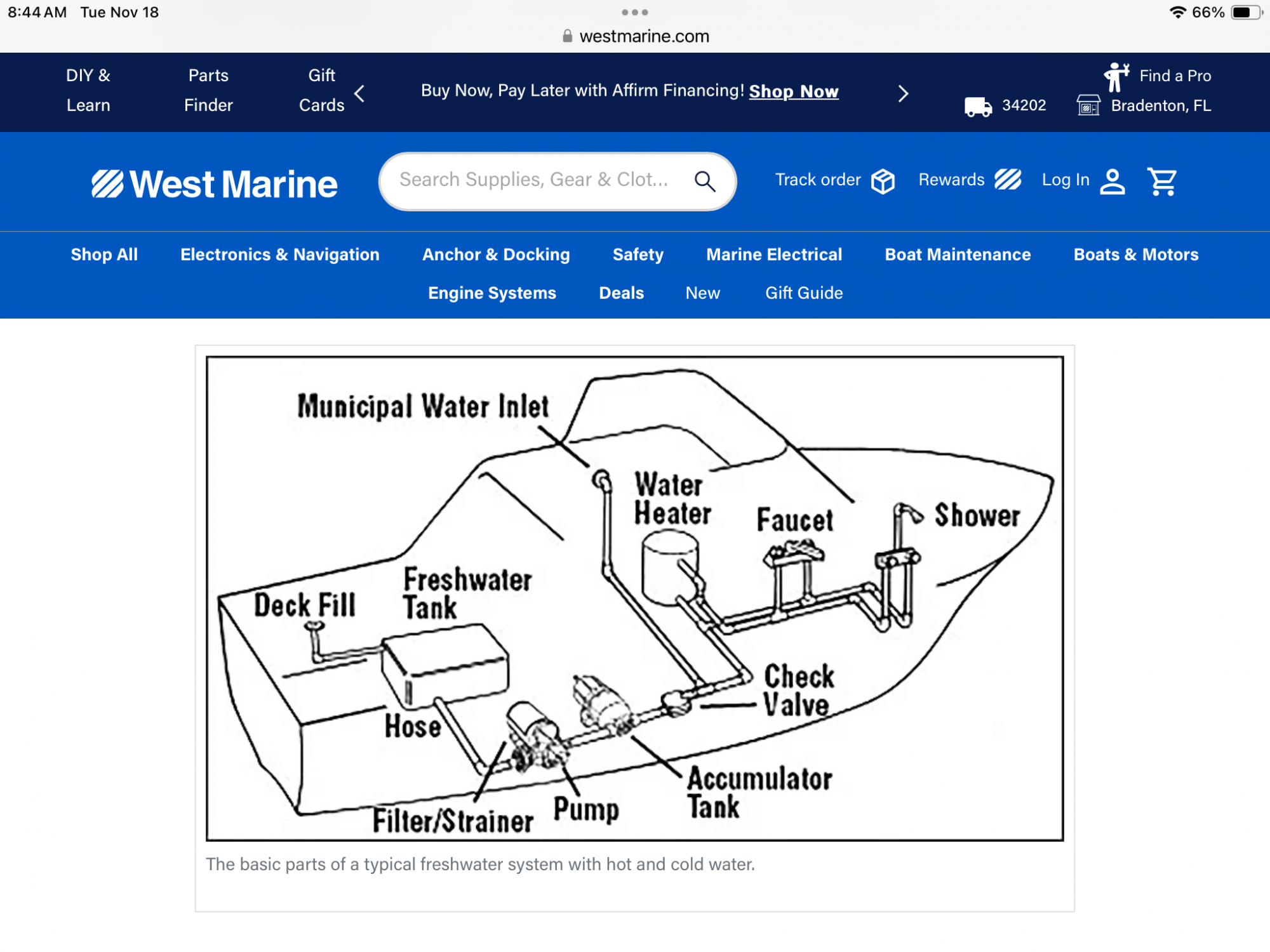

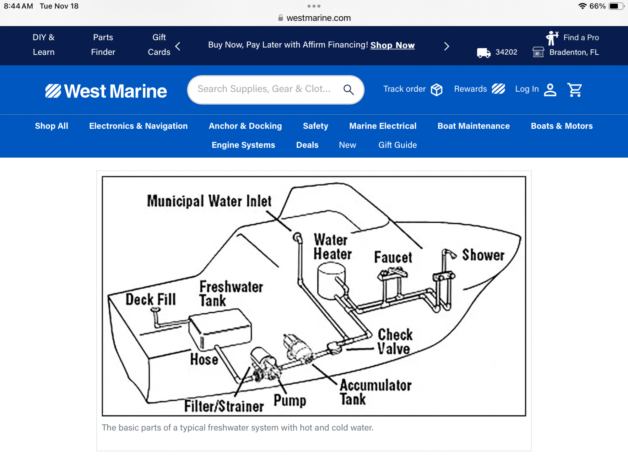

This is a crude diagram but shows where the connection is made. Note the check value to ensure no backflow into stuff which doesn’t like pressure.
while caution is always wise, virtually every boat at our marina has a pressure water connection. IMG_2735.png
