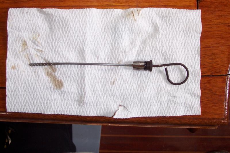

Looking from the front of the engine, it's should be on the Left side of the engine (oppoiste side of air filter) toward the lower rear - just before the bell to the transmission.
Johnb
1,508
Hunter 37-cutter Richmond CA
I will measure mine over the weekend and let you know.
Johnb
1,508
Measurements are as follows
From the end to the shoulder that limits insertion 6 7/8 inches
From the end to the end of the cross hatched section 1 3/8 inches
Diameter of the section with the O ring 1/2 inches
Diameter of the shoulder that limits insertion 5/8 inches

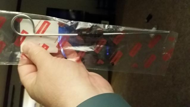

Thank you Johnb!
The first one they sent me was wrong... I ordered another... if that doesn't work perhaps I can make one.
