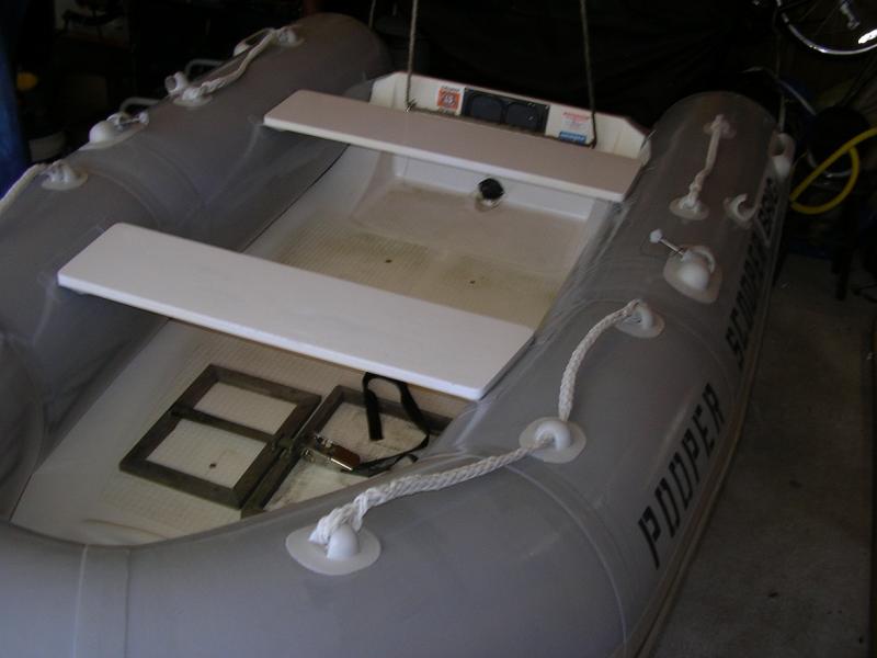

Hi All,
I started to give my dingy a facelift two weeks ago and have a picture of how we're going to use it this summer. I had a problem was with the rubber coating sticking fast to the tubes. I emailed Inland Marine who advised stripping it again and wiping with toululene before applying the rubber coat. The manufacturer may have used a silicone based product on it to make it shine. We'll do the strip next year. BTW they're sending another quart, no charge.
I painted the seats and the boat name, and only have to clean the floorboard.

Nice job, looks great. What did you use to stencil the name with?

"Nice job, looks great. What did you use to stencil the name with?"--Bob
I used the Inland Marine stencil kit and paint, pretty good for my hands.
