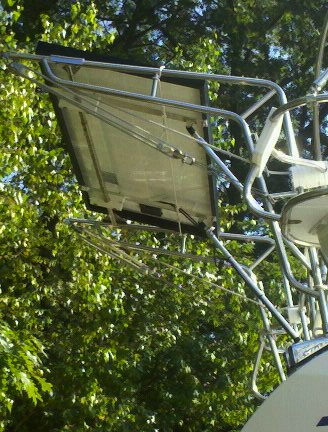

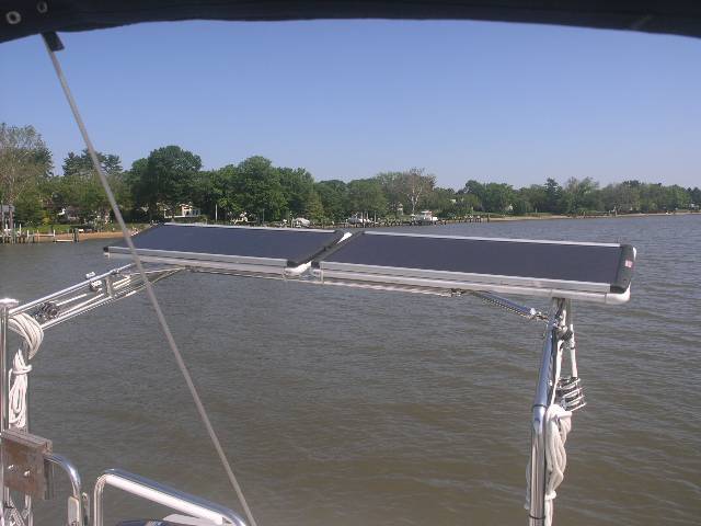

I installed Mar-Tek davits and hang a Walker Bay 8 on them and mounted a 135W solar panel on top. The 3.3 HP Mercury OB usually sits on the stern rail, but we will occasionally hang the boat and motor just off the surface of the water at night, for security and to dry out the bottom of the dink. We have cruised quite a bit with this setup and are very happy with it. Next on the list is a Torqueedo electric OB.

My solar panel adjusts so the it can be angled forward or aft. When we sail, it remains horizontal, and we haven't had any adverse effects from wind. At anchor, we get a couple more hours of power per day by angling the panel. I like the davit location because there is no shadow on the panel, and it is out of harm's way.

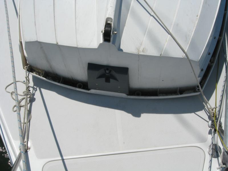

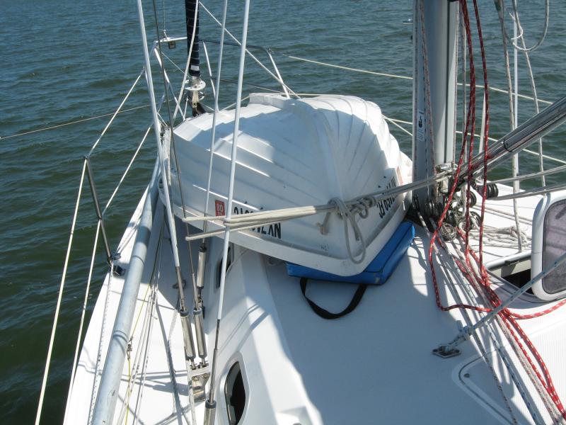

Jesse, my Walker Bay 8 fits in front of the mast, but the bow of the dink still sits on the anchor locker. I have been able to access the anchor locker by lifting the bow of the dink with a jib halyard. By the Dinghy Tow system, do you mean a bridle for towing? We tried towing an inflatable during our first cruise up the East Coast, but ran into numerous problems, mostly weather related. We usually ended up putting the dinghy on the foredeck, but then my wife couldn't see where she was going. Anyway, we now have the davits, and find them preferable. It's actually quicker to deploy the dink from the davits than from the foredeck, and, like everything else we do on the boat, it becomes easier with practice. Lately, I've been using the davits to hold the dinghy away from the stern when it is in the water. Saves wear and tear on the transom.

Ray, you could definitely set up some kind of brace to hold the bow of the dink, especially if you were just anchoring over night. Space gets kind of tight there, no matter what you do. I was able to raise the bow of the dink with a halyard to give myself more room, then stabilize the bow with lines to the pulpit.
I should also mention that without the inflation collar on my Walker Bay 8, I can move the bow of the dink over to one side to access the anchor locker. Might be something to consider if you don't need the added capacity the collar offers. The Walker Bay is still a nice little boat, unadorned, so the speak.

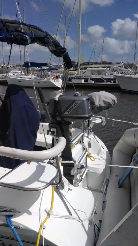

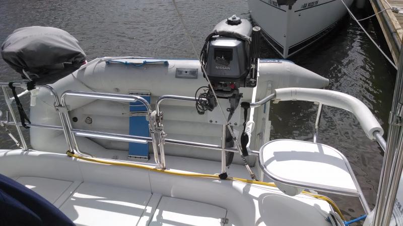

Thanks, Valcour, great pics. I never thought to turn the Walker Bay around like that. I should mention that one time I had the WB facing forward with the stern lashed down just forward of the mast, and with the bow of the dink held up and level with a jib halyard, I could open the fore hatch, with the dink keeping the rain off the hatch.

I was reading this thread about dinghies, davits and all the options and finally found some pictures that I wanted to post. One low cost option for carrying a dinghy might be the "Dinghy Sling" from Harbormenmarine.com in Mass. I ordered one for $245 and installed it on my Cat 310 (hull #1) and the attached pictures show how it carries the dinghy. Like anything it takes some practice to figure out the best position and then how to use it deploying and retrieving the dinghy. I have to say that I have not done extensive cruising with it yet but have made a two day ocean sail and it was very stable. Dinghy is a 9.5 foot Boat US model and is pretty heavy. But the system carried it very well and it was steady. I am downsizing the OB to a 2.5 hp so it is easier to handle and will use it again on another cruise in March or April. Just thought I would share this with the group as a possible low cost option to carry the dink.
