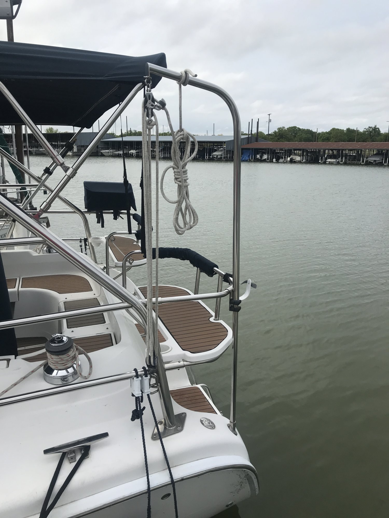

We had a motor lift on our H356. I don't remember the brand. It was mounted on the starboard aft cockpit. If I remember correctly it fit in a hole in the transom outside the rails but not on the aft lazzerette lid, of course. I think it was removable or at least part of it was. We used it for a 4 hp 2 cycle. I would have called it factory mounted but I'm not sure it was. I'll look for a picture

No pic showing the hoist. But one showing it not being there. So it was removable. I'm thinking now there was some sort of anchor on the aft deck, maybe a ball and a keeper on the rail. The post would be slid thru the keeper and terminate on the anchor.

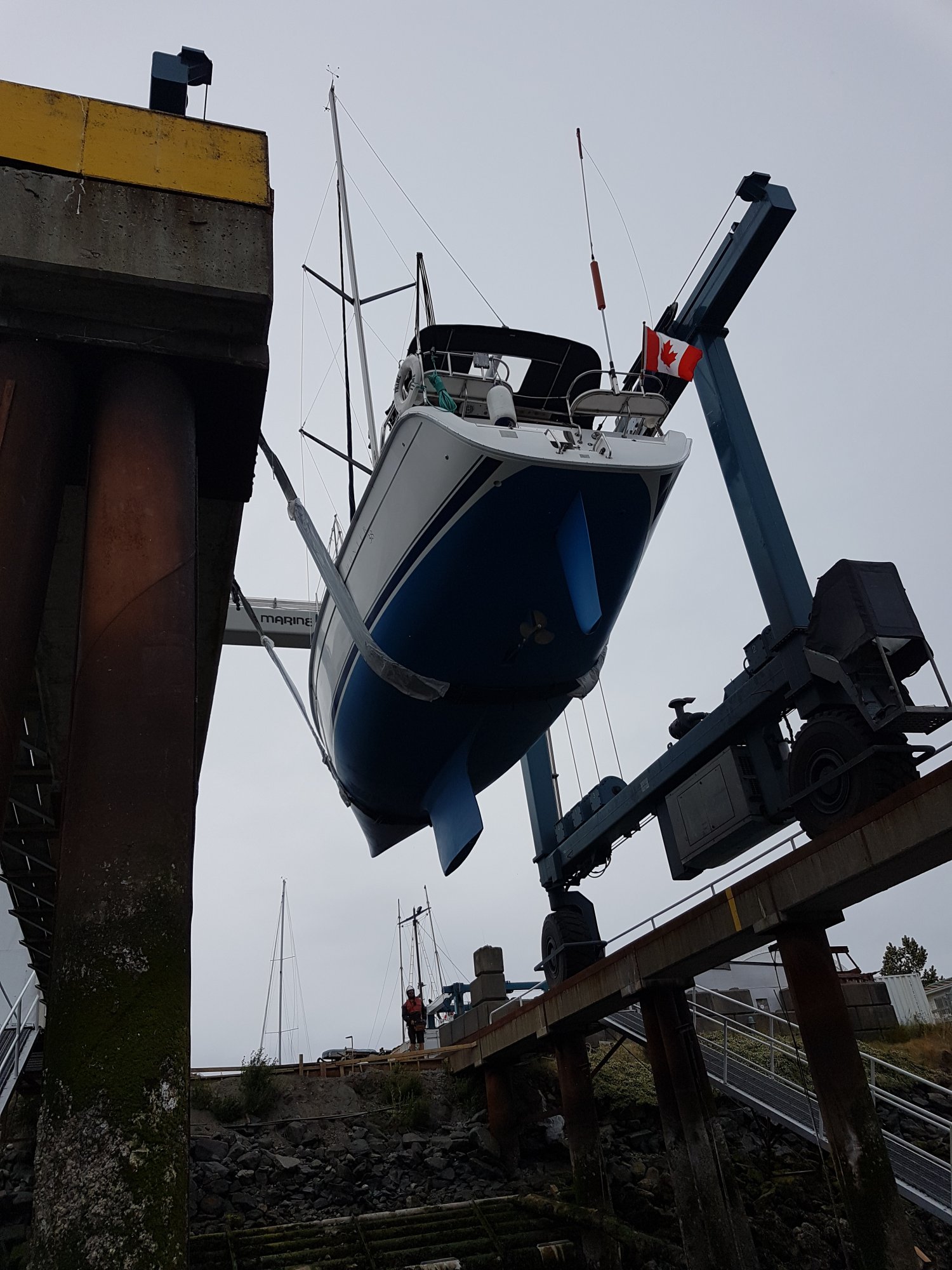

I have an Ocean Marine Systems motor hoist mounted on the port aft cockpit of our H38. The base plate is screwed into the "deck" just below the waste tank access and supported by attachment to the rear seat rails. It is a model M20;
This is the only picture I have showing it - you can see it behind the life ring as the boat is being lowered back into the water. Works well - I can do the job by myself if necessary although my height helps. I move the dinghy to the rear port side of the boat and swing the motor out, then lower.

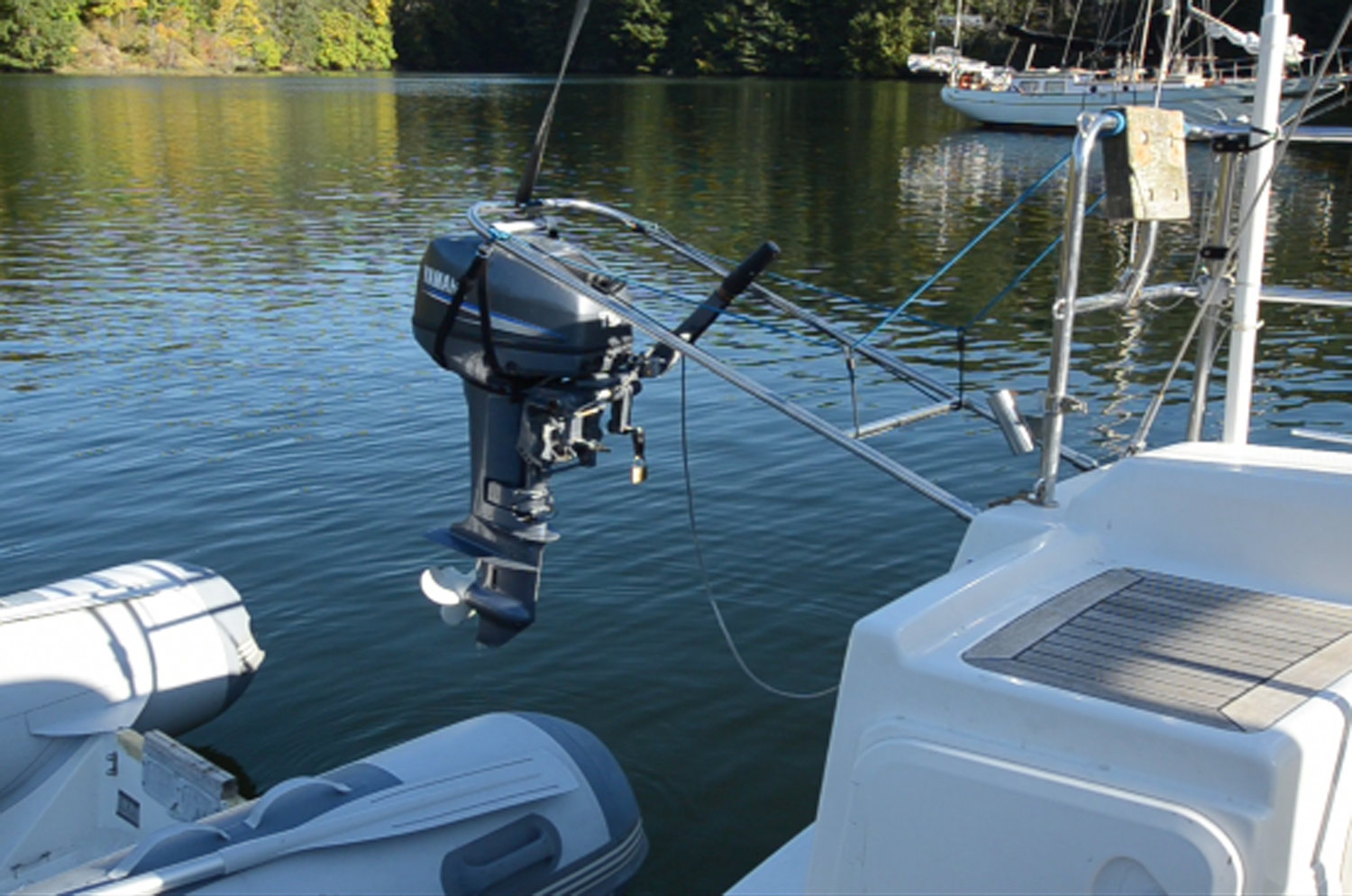

I bought a 2006 Hunter 38 this winter which has a motor lift davit. I think it is a Kato Marine product.
They have pictures of an H36 install on their website:
Hunter36 | Kato Marine
