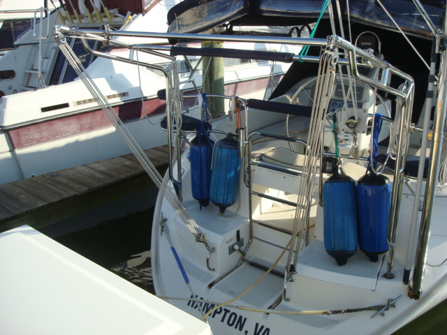

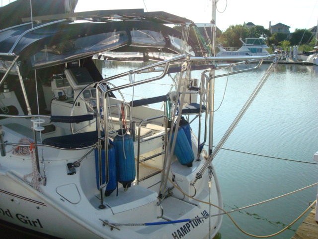

90
Hunter 40.5 Hampton,Virginia
On my 40.5 I went with Garhauer and could not be happier. They will build to custom dimensions and are all made of 1 1/4 SS tubing and comes with all hardware. Best price of all I quoted.
