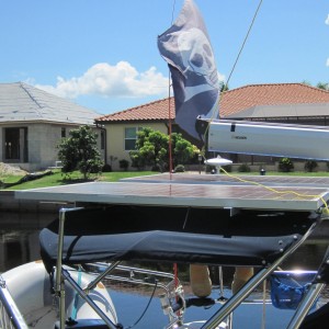

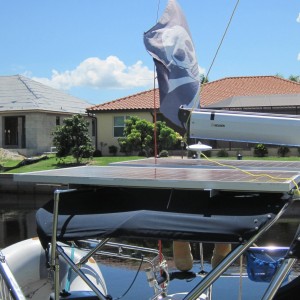

Anybody thought about or have input on bimini mounted solar panels?

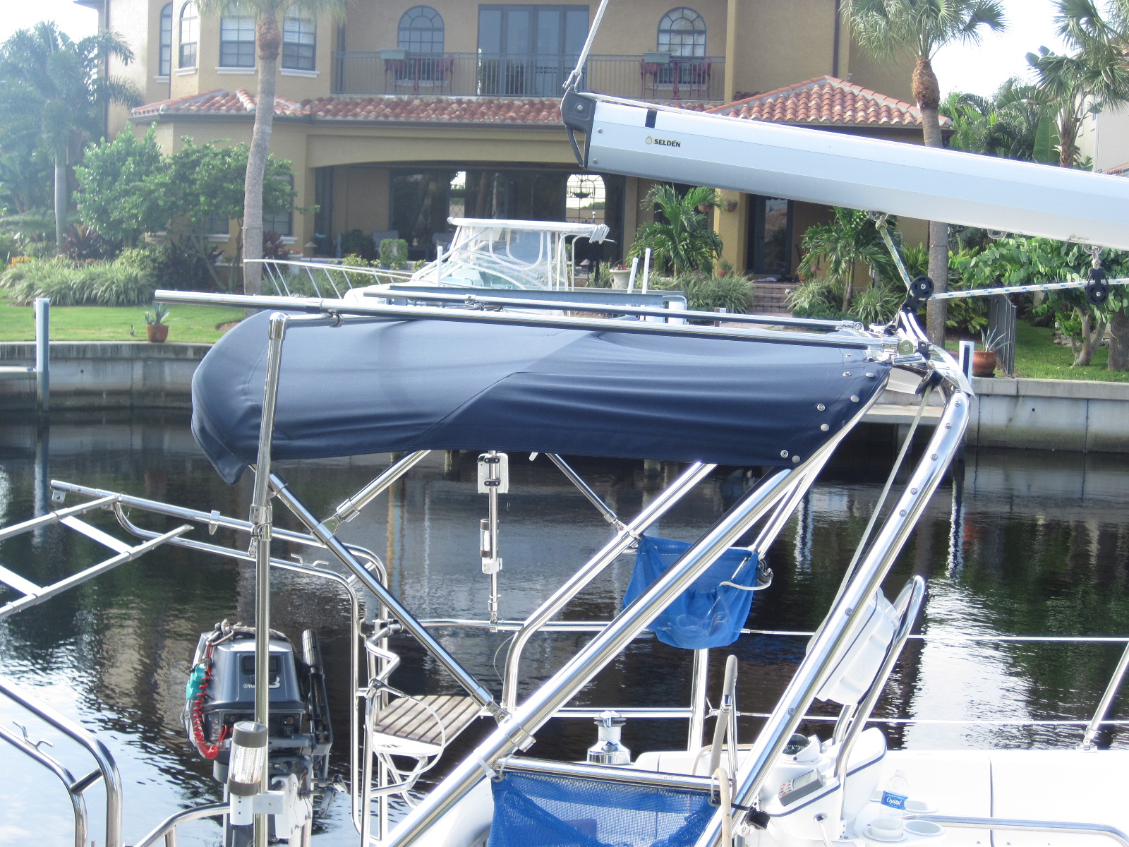

Installed arch from Atlantic tower NJ holds 10rib with 15hp 4 stoke,radar,antennas and me standing inside the dink without a problem.don't do this with the other Davits Thayer will break for sure.

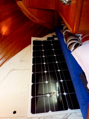

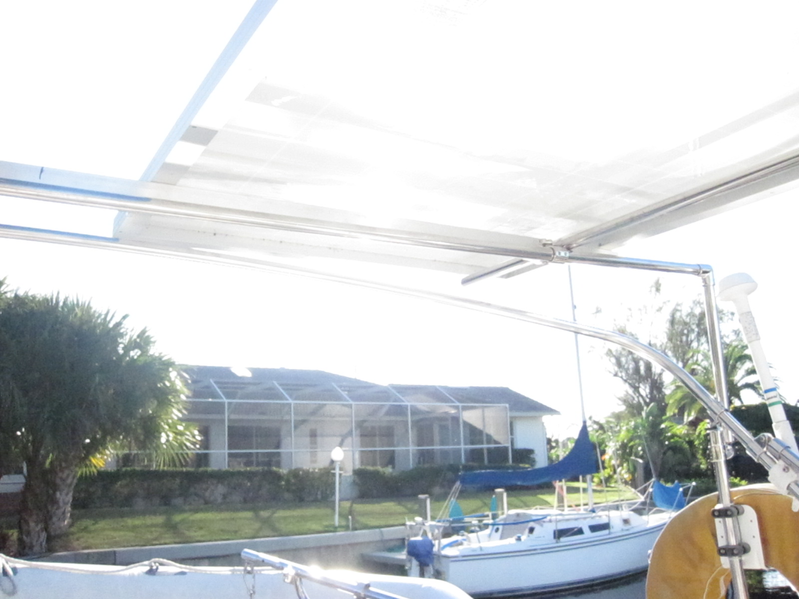

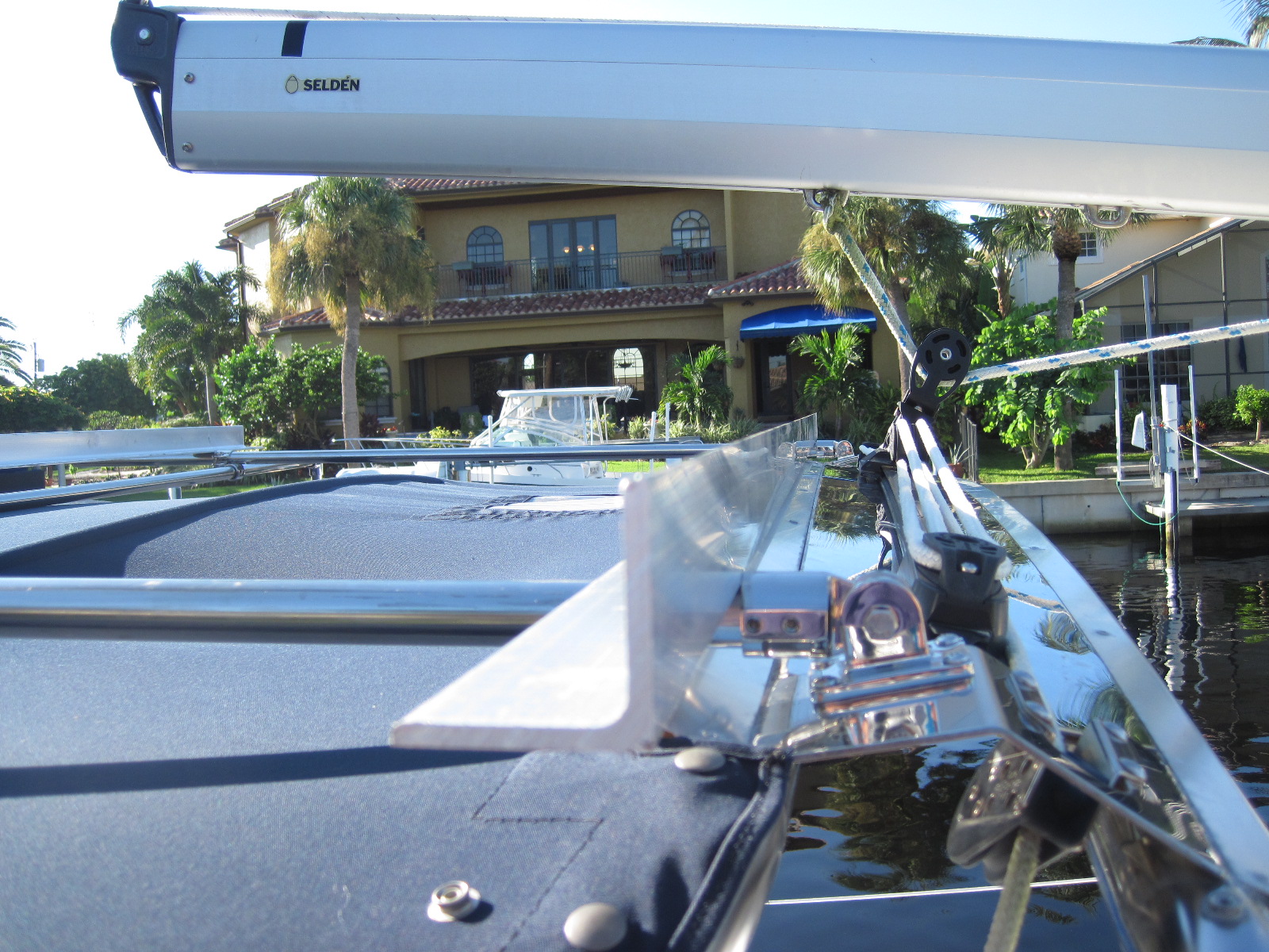

Use these. You can sew zippers or velcro to them and attach them directly to your bimini. They're a bit expensive, but you save the cost of having to build a frame or arch, and you can remove them, roll them up and store them below in a storm.
http://www.emarineinc.com/products/Solbian-125W-Flexible-Solar-Panel-.html
As for the gentleman with the davits, I think you'll find that to mount something that can carry 350+ lbs plus a safety margin, you're looking at custom made. I don't think there are any off-the-shelf systems that are really intended for those types of loads.
NEVER, EVER "roll up" Solbian panels unless you want a big fat hole where your wallet used to be.!!!
Solbian panels are "semi-flexible" monocrystalline panels not "roll-up", elcheapo, horrible efficiency armorphous panels.....
Stow them under a berth cushion instead and you won't even know they are there..

Last week, Sailrite posted a how-to on mounting flexible solar panels to a bimini. It looks like a good system. My aluminum- framed panels are bolted to SS tubes.

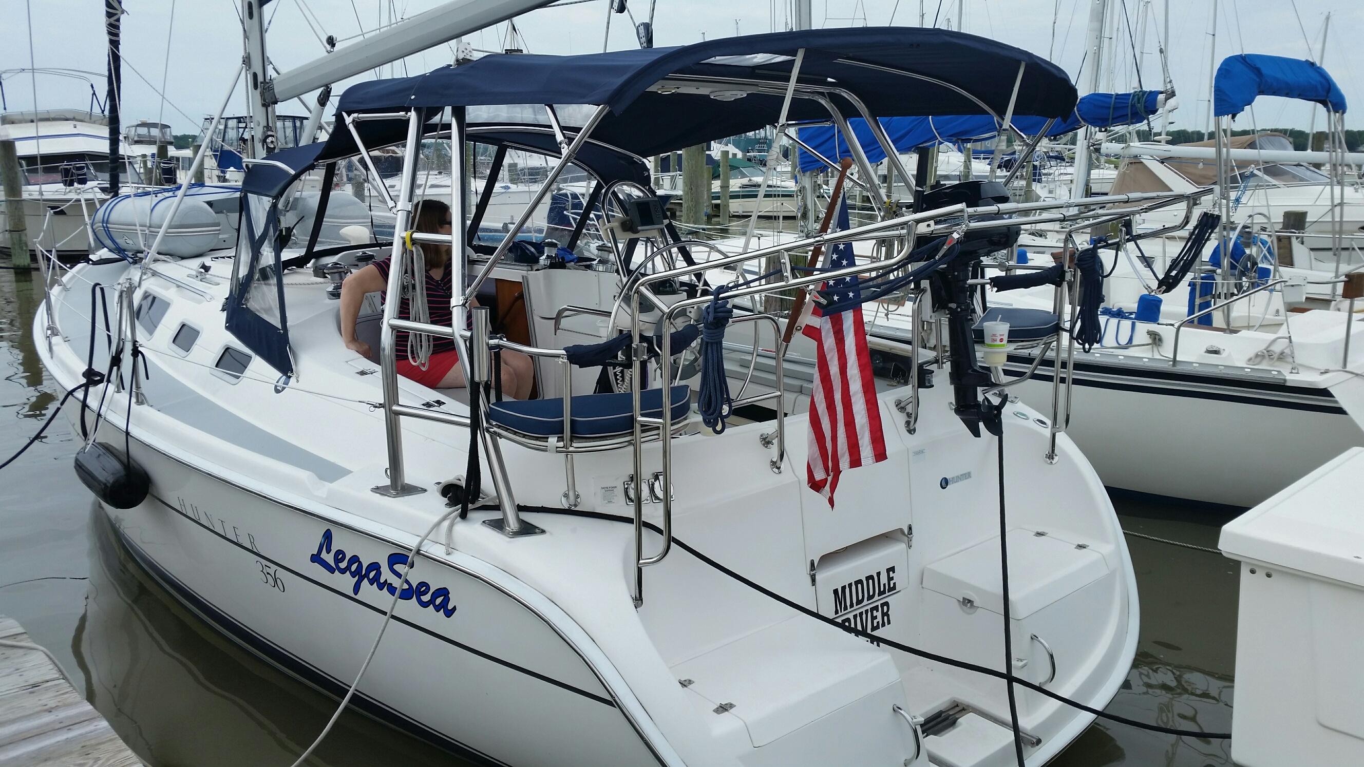

Have a 2003 356 and went through having a 9'6" Achilles on the front deck and using the spinnaker halyard and rope bridal to lower , was a real pain and kept us from using the dinghy as much. Wife wanted the davits so now we have them.
Also went with Ocean Marine Systems Davits which I recently purchased and installed and are very happy with the result. Makes traveling and using the dinghy much more usable and enjoyable. Got the 6:1 block on the stern/engine side which makes it a breeze.
Will be going on a 11 day trip down the Chesapeake Bay soon and it will be used often as we anchor out a lot.
Now I need to just get a longer slip:banghead:
Some times Mike @ OMS is hard to get a hold of but he will get back to you.
Jeff
