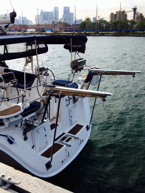

Well, this wasn't a trivial project. It took the better part of last summer to perfect it.
I wanted together best possible set of Davits for a 49, and here is what I came up with.
There are built in winches with dynema line. Approximately 10:1 ratio on them, and you can crank up the dinghy with minimal effort.
You can definitely haul up a dinghy with outboard on these, and not worry about rigidity.
FYI, I stiffened up the stern with internal 3/8" glass.
For an initial test, I put someone in a bosun's chair, and cranked them up from the water surface. Literally two fingers on the winch for cranking 150 pounds was all it took.
Fantastically successful project

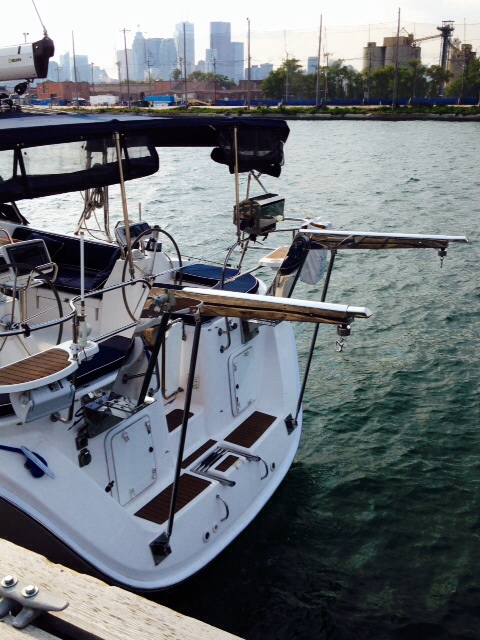

Here's a higher resolution photo

Yes. That is the case
Art I am jealous of your Davits. Mine are ocean marine and work Well and I lift my AB 9 VL with 2 stroke 15 hp the only problem is in big waves the boat is hard to secure to avoid the stress and strain of movement. Do you crank yours to the point where the boat is firm against the bottom side if the davit?
I have mourned two rubber block on the dinghy which nests the width arms.
So, the dinghy locks into the Davits at full lift

Extendible arms
Also, if you look closely at the photo, there are arm extensions at the end of each arm. You pull these out and lock with a friction knob
This stabilizes the other side of the dinghy

I agree with you
I don't know what are Best. All I can say is that I have St Criox rotating ones and I don't like them (but my money is spent so am going to live with them)
You have to live with what you've got.
That's why I put off installing davits for years. I just wanted to do it right, with minimal compromise. It ended up being a big job, but they are very solid.
You have to appreciate that the sterns on these boats aren't built a to take a lot of flex & strain. So you really have to think carefully on how you are going to support a fair bit of weight.
I spent a ton of effort on mine, and I'm very happy.
But,, it wasn't as simple as just ordering a pair off the shelf
