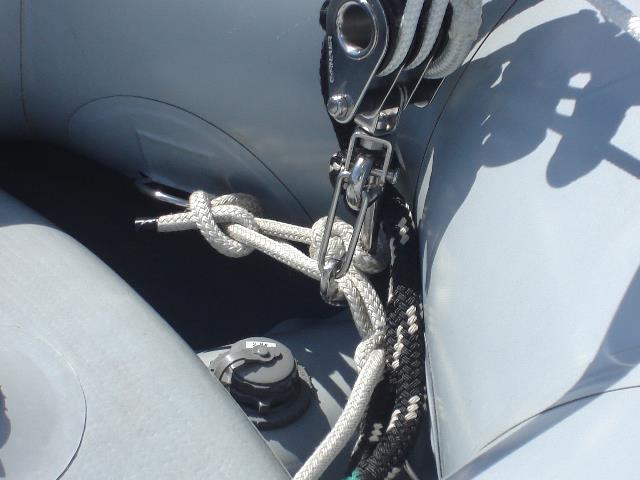

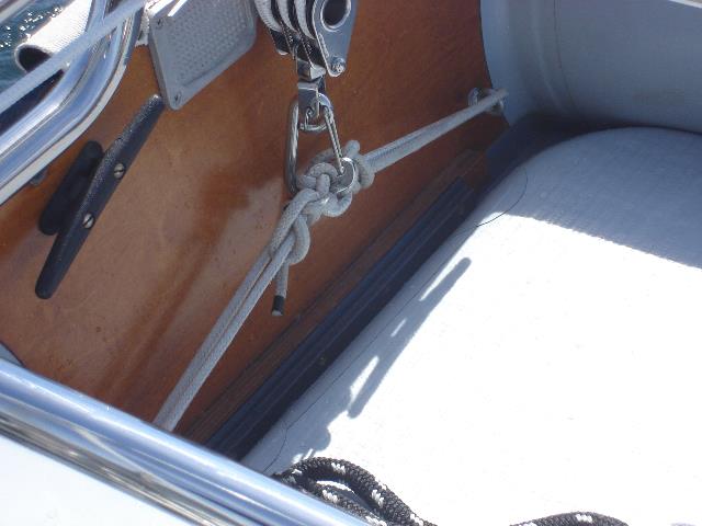

Hoist points for an inflatable dinghy
Nick,
My Achilles has an inflatable floor and it did not have rings on the inside of the bow for lifting. I added rings on both sides using the largest ring and pad available so that the load - even with some water- would be spread out. I used two eye-bolts in the transom. See pix below.
