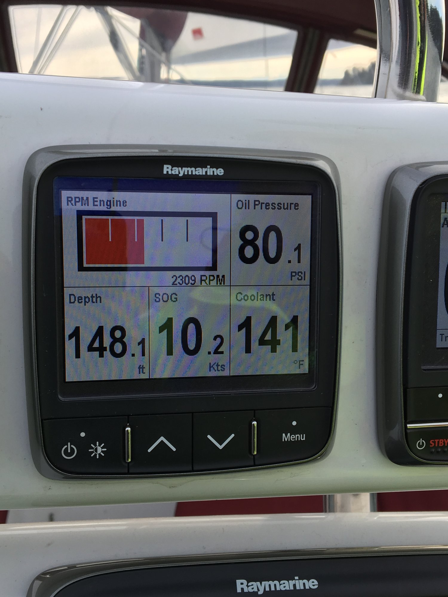

BS. Both the RS11 and EMU1 can put vital engine data on N2K. I see oil pressure& temp. Coolant temp, RPM and voltage on my Raymarine CP and i70s.
can you use a J1708 to NEMA converter you directly read this data from the engines cpu?? No - they don’t have CPU’s like a common rail diesel. But you can piggy back on any sensor on the mechanical engine.
look at the PGN’s these devices support, the EMU is easier to configure and has more pgn’s but also more expensive.
here is data from my Universal M25 a 1983 engine with no computer. I also have this data available (including engine hours) via a web page on my phone or iPad.
look at the PGN’s these devices support, the EMU is easier to configure and has more pgn’s but also more expensive.View attachment 181721
