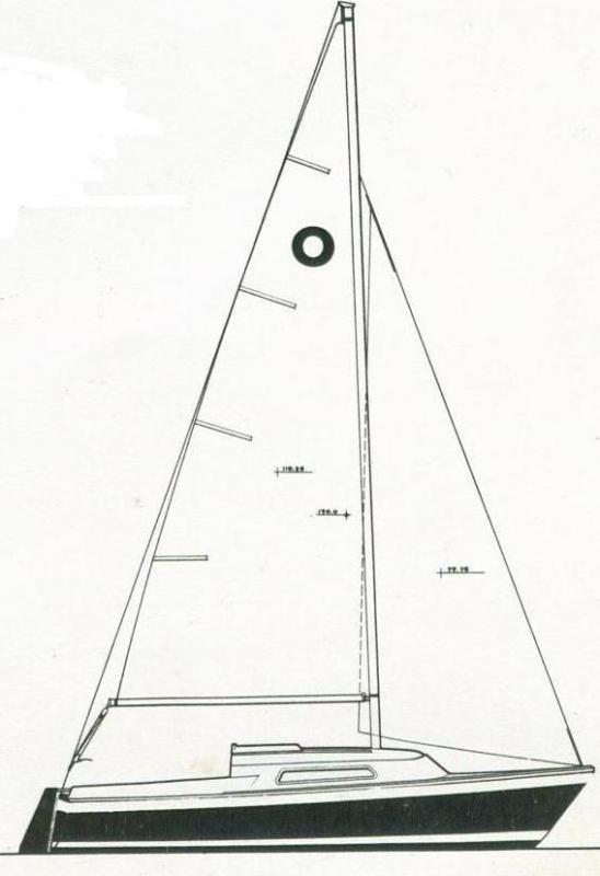

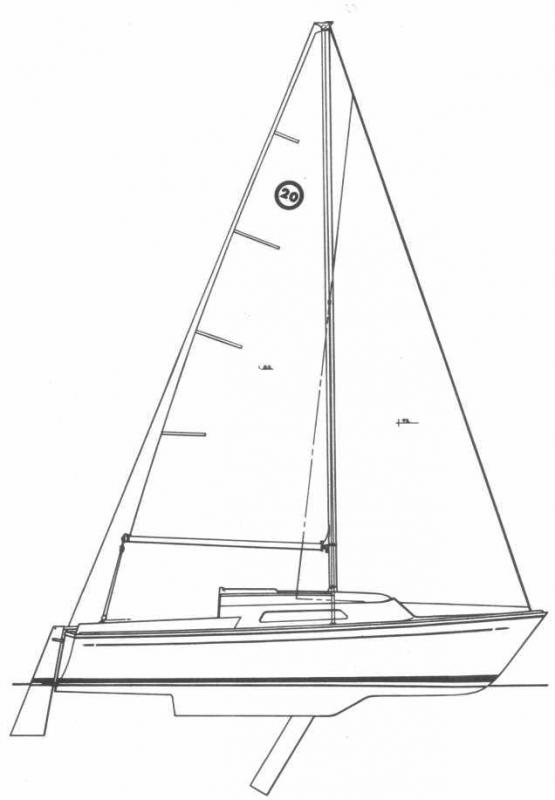

Virtualy no difference in rigging between 1977 and 1978 O'DAY 20. Ditto for the 22, HOWEVER.... the 1979 model was the last year for the masthead rig 22 and 1980 was the first model year for the fractional rig 22. 1979 22 was first year for the K/CB version of the 22 (1'3"/4'3" draft instead of the original 1'11" fixed keel).

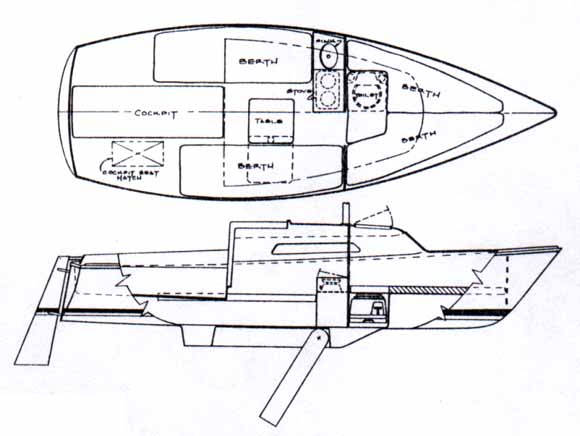

O'DAY 20 rig was changed for 1976 model. The 1973 to 1975 models had the masthead rig, 1976-78 models had hte fractional rig. The interior layout was also updated for 1976, going from the original layout that pretty closely matched the interior of the 22 with a bulkhead between the V-Berth and the main cabin to the more open layout of a pair of galley counters with space between for the head.
1978 was the last year for the 20.

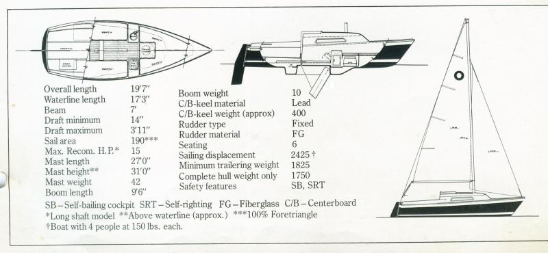

Joe, 27' is not unusual for the length of the mast on a 20' boat. the CAL 20 and the CAL 21 both had a 26' mast.
