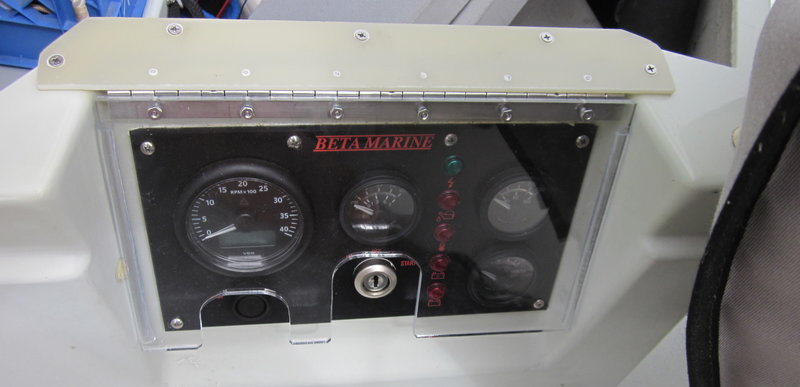

Regarding the comments about possible water damage to the switch, I have a possible idea to limit that in the future.
Does the boat already have some sort of hinged or similar rain-and-spray cover for this panel?
I built one for ours, with a fabric cover for when the boat is at the dock.
Two related projects; just click on each link.
So far, so good. :)
Sidebar: friend of mine used to say that each project should justify one new tool (!), and yours should now deserve a jetted hot tub!!

Fast - It does not have a cover for the engine panel, other than the bimini. I though about adding one. though.
I'll check yours out. The links are currently not working, site appears down.
Thanks.
Apologies. I forgot that the site is being upgraded, and that access was being stopped for everyone...
It should be back on line Monday am.
