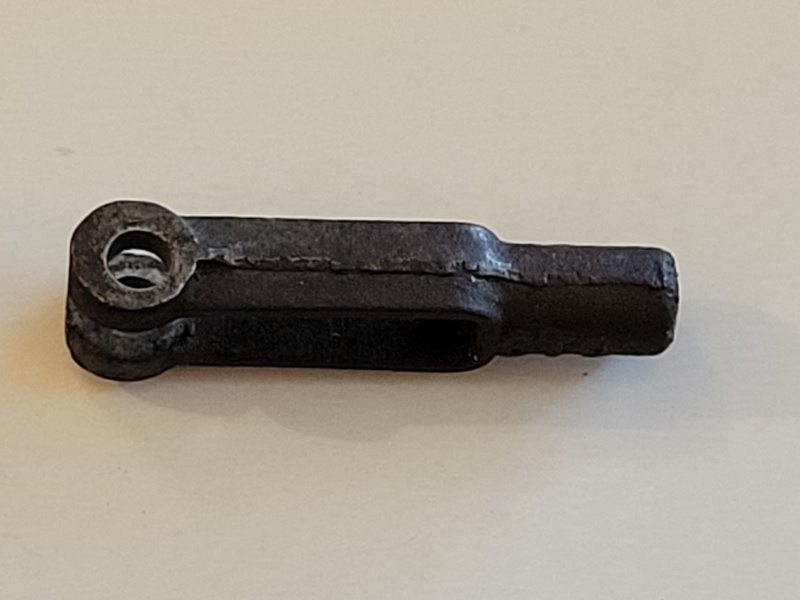

Well, some of what you say makes sense, some doesn't fit. I cannot feel any detent position on the throttle lever. It is possible the detent is worn beyond usefulness. The regulator lever has a bracket for a kill cable, but there wasn't any cable connected. The "universal" cable won't connect to this bracket. That the clevis is not slotted confirms that C&C modified this, probably to create a single cable operation, but the stop pin, and lack of detent make maneuvering in close spaces like a marina much too exciting after accidental stalls. Granted I am used to steering with the engines, but this boat doesn't have 2 Chrysler 360's, and only 1 screw, so that's out of the question.

Ok, I see where the stop cable would mount. With the stop cable a detent would not be necessary but a slot in the clevis would definitely be required. The idle position of the regulator lever rests against the stop spring, the control lever would over travel this position, putting the clevis pin towards the cable end of the slot, and rest on the control lever stop. When the stop cable is pulled it compresses the stop spring and the return spring pulls the regulator lever towards the stop position. This movement is allowed by the free play in the clevis slot. No detent required in the control lever.
You may have to purchase a clevis and modify it to get the slot. Here is a possible candidate:

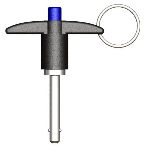

Here is my less fancy two lever throttle and recently installed "stall inhibiting detent device" (formerly known as a modified hard rubber doorstop). It's embarrassing, but effective for now.
If I cannot come up with a suitable 2 cable arrangement I may simply drill a hole and insert a locking pin as a stop.

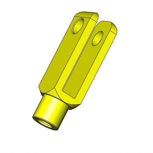

Continuing the updates. Removed the old clevis fork. It is non metric (10-32 thread), so highly unlikely it came from Yanmar, and was replaced when the non-metric throttle cable was installed or replaced. That means a search for the original is pointless, so the search for an appropriate clevis fork began. I was able to find several with the appropriate #10-32 thread, and the right measurements in all other aspects except when closely examining, the "arms" are similar to the original (below)
where the pivot hole (some manufacturers call this the bore) is larger than the "arms" and trying to elongate the hole wouldn't work.
After some additional searching I found Midwest Control Products Corp. BTC-187L Clevis and Yoke Ends Female 10-32 RH (below).
This shape should allow for the modification.
In a couple days I will let you know if this works.

They were one of the first places I looked. While they had clevis forks with #10-32 thread, and other critical measurements, their clevises were similar to the one I removed, and unsuitable for modification (changing pivot hole to a slot). Notice on the sketch of the one I ordered the "arms" are uniform in width from end to end so elongating the hole is possible. Now look at the original and imagine what would happen if I elongated the hole. I only wish I had a better feel for how much additional regulator lever movement is necessary to go from idle to stop. I'm hoping as little as 1/4" extra travel will do the trick (though this clevis fork will allow me up to 3/4").

Sorry this took so long. I finally got out to install the modified clevis fork, and stop cable. Had to adjust the throttle cable so that at its physical limit the regulator lever is being pulled by the return spring, but resisted by the stop pin. Throttle now will reduce engine to idle, but will not stop the engine. A slight pull and hold of the stop engine knob stops the engine every time. I did make some adjustment of the stop pin so that the engine idle is low enough. But the modification works like a charm.
