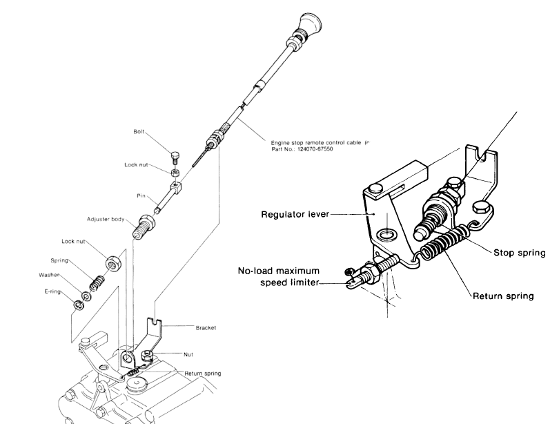

The engine stop cable on your engine allows the regulator lever to rotate past the idle position and stops the engine independently of your throttle control. A small spring (called return spring) connected to the regulator lever actually moves the regulator beyond idle to stop. Adjusted properly your engine throttle control will allow your engine to operate from idle to full speed, a range of 800 to 3,250 RPM. It will not stop the engine as it is adjusted to only operate between 800 and 3,250 RPM. To stop your engine, move your throttle control to idle position (800 RPM) and then pull the stop cable to allow the return spring to move the regulator lever further and the stop the engine. This last pull on your stop cable does not require you to move the throttle control.

Thank you. When looking at the diagram of the engine stop, regulator lever, and return spring I thought that was the intended design. However, physical examination suggests that the return spring has to move both the regulator lever and pull the throttle cable connected to the other end of the lever which would otherwise oppose the lever action. The return spring seems to lack sufficient strength to do that, and additionally the spring loaded pin in the stop assembly does not seem to actually stop lever pivot even when not retracted by a stop cable. So hearing you concisely restate my original understanding of how it should work and confirming it actually does work, is what I needed to hear.
I will connect a cable to the stop pin as needed, and try to make the adjustments accordingly, because frankly right now with no cable attached to the stop pin, the throttle seems uninhibited by the stop pin (which is why it now can kill the engine), and the stop pin adjustment seems to already be at its limits. I didn't want to spend a lot of time on something that wasn't going to work anyway, so thank you for your confirmation of the design, and I will continue to work on the application (the difference between a design on paper, and its implementation in the real world).
On further examination it looks like if I pivot the stop pin assembly bracket a few degrees CCW it will increase tension on the return spring, AND change the contact angle between the regulator lever and the stop pin so that it presses the pin sideways (no motion) instead of depressing it like a spring loaded button (as it seems to be doing now).
[This will help those of you without the images see what we are talking about]

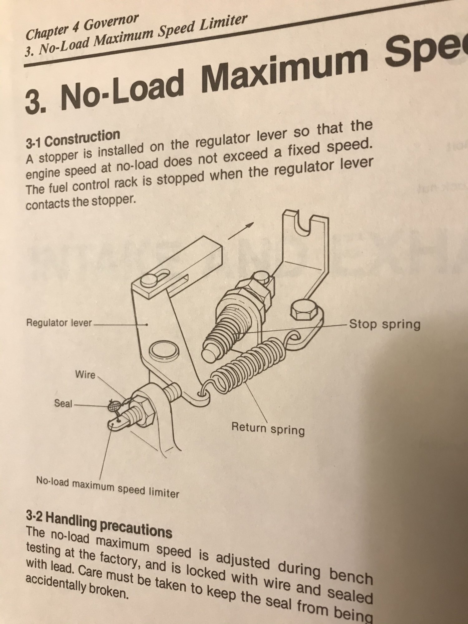

The return spring does not have to pull the throttle cable. What the drawing does not show is that the throttle control cable end has a slot that allows the regulator to move beyond idle to stop. Regarding the return spring: that spring is no longer available from Yanmar. No matter, you can find a suitable spring elsewhere. It need not be a robust spring as very little force is needed to pull the regulator past idle to stop after you have compressed the stop spring with your stop cable. The throttle control cable end should be adjusted so that there is free movement of the regulator arm at idle within the cable end slot. I do not think you should have to rotate the bracket from the factory position unless it has been moved to an odd spot. Once you get this right you will never have to look at it again and you will never stall while moving about the marina.
What you describe does not seem to comport with what I observed. However when examining the push/pull of the throttle cable I was unaware of the "slot" action you describe, so the severe maladjustment of the cable may be what's overriding the intended operation. Assuming that slot, adjusting the throttle cable so that when the throttle lever is at its physical limit the push of the cable stops at idle. In which case the spring and pin on the stop assembly need only be strong enough to overcome the pull of the return spring until the stop pin is retracted. All of which says messing with the bracket is ill-advised. Observing that the slot action (allowable motion of the regulator lever without corresponding cable movement) is uninhibited (not stuck) is easy enough to check.
For those whose eyes have glazed over, what Roy is saying is when the throttle cable pushes the regulator lever as far as the cable is physically able, the return spring can then pull it an additional couple degrees, but the spring on the stop pin pushes the lever in the opposite direction, and being stronger wins that tug of war. When the stop cable is pulled the pin is retracted so the return spring can now pull the lever that last few degrees. It's not working now because a maladjusted throttle cable is allowed to push the lever too far.

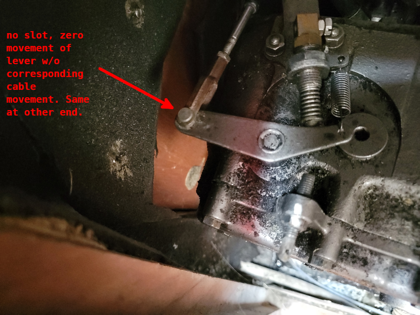

Special ordered cable came. It wasn't correct because though the knob end was acceptable, the engine end was bare cable and conduit ( the stationary housing, inside of which the cable moves). It did not have a threaded, adjustable terminator on the engine end of the conduit. However, close examination shows it would not have worked even if it did fit correctly.
The clevis is not slotted, thus movement of the throttle lever and the governor lever are fixed in relation to each other i.e. neither lever can move without corresponding movement of the other. This means the governor lever cannot move beyond what the throttle cable has already pushed it.
The return spring is not strong enough to pull both the control lever and the attached cable. Additionally the stop spring will not stop too much cable push.
Being as there is no slot action, there is no point in finding the "correct" cable. I could try to find another clevis with slotted pivot holes, then find a cable with both ends properly terminated, but I think I will just haywire a mechanical stop at the throttle lever that can be easily moved to allow the additional lever movement needed to stop the engine.
