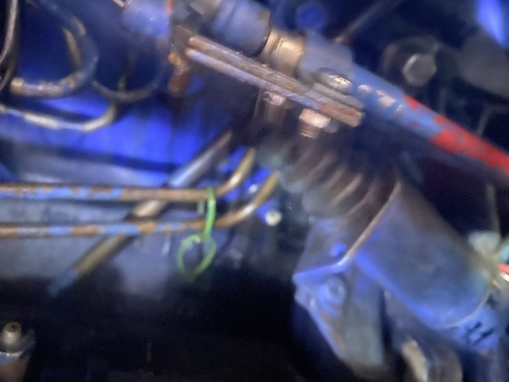

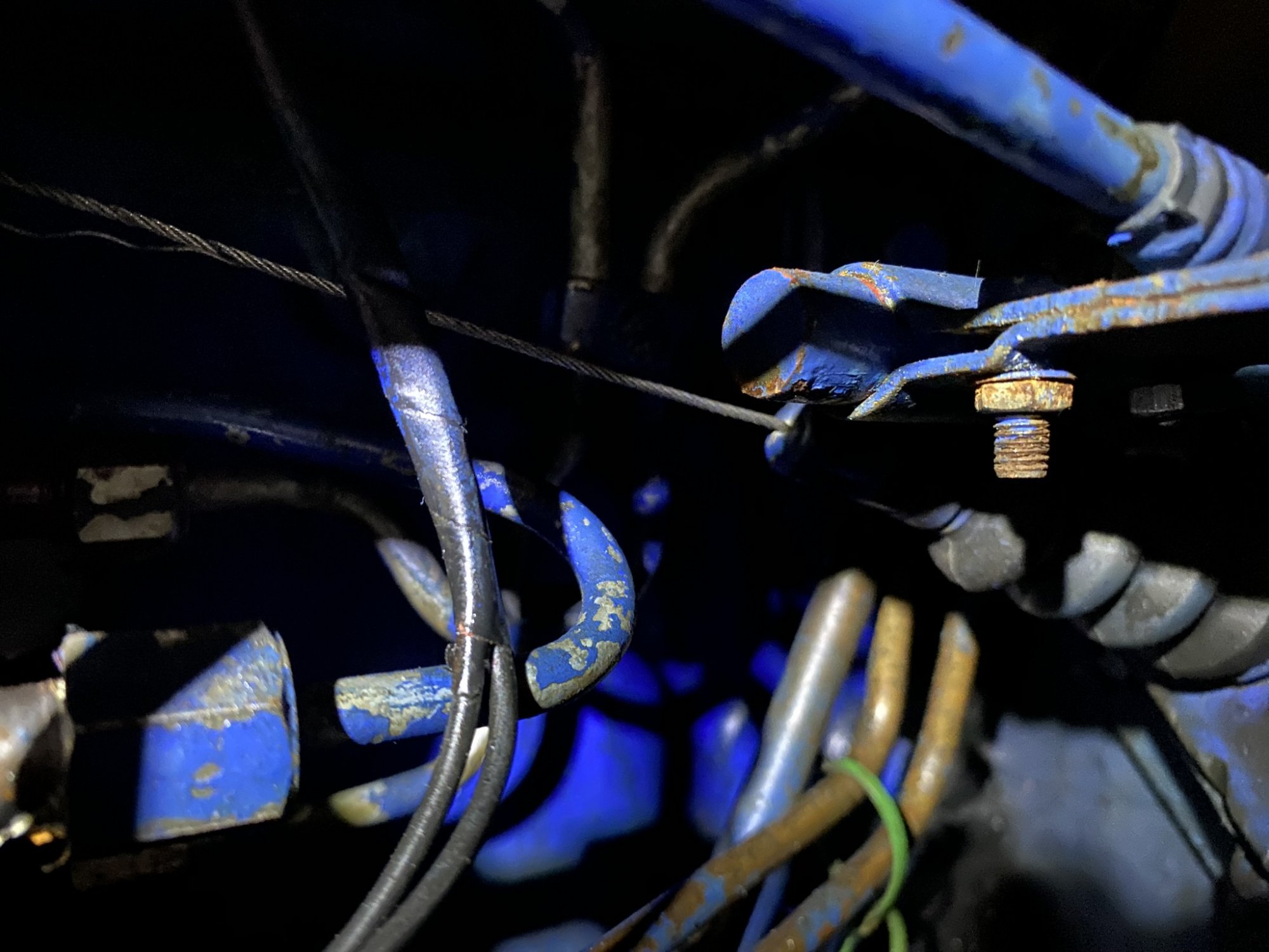

F09FBD47-F69A-489E-B378-EA8FCF99E3C3.jpeg1A4B3F1D-99D6-4358-89CE-DFD137057177.jpeg Don, I was down at the boat and decided to take some poor and hard to see photos of my shut-off solenoid. Very hard to see but the rubber bellows you see is on the solenoid and the cable runs to the injector pump. Moving it by hand I would say 2 1/2 to 3 inches. Solenoid is mounted off one of the starter mount bolts.

Which model Yanmar? Are you certain you have a Yanmar, all the Yanmars I have seen are gray.
Regardless of how you run the cable, it needs to be replaced. One strand is clearly broken.
I don't think you have a solenoid. A solenoid is an electrical device, the starter has one, the Yanmar injector pump is mechanical. My understanding of the stop cable is it simply closes a valve in the fuel flow from the injector pump to the engine, that's why the engine rumbles on for a few seconds after the cable is pulled, the engine uses up the fuel in the injector lines and then coasts to a stop.

‘Definitely not a Yanmar. It’s a Perkins 4-108 but the valve arrangement to stop the engine is similar. Was the same on the Kubota in our last boat except it was a pull stop. You can see the wire coming off the back of the solenoid ( red and white). Thanks for the heads-up. I didn’t notice the frayed wire.
