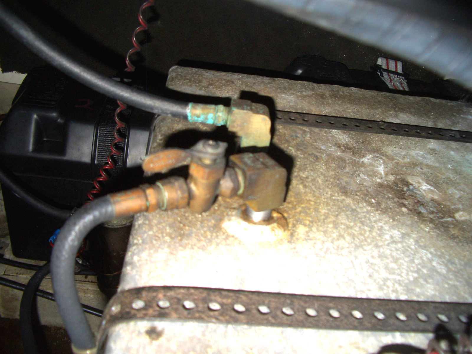

May I ask how you dealt with the first line from tank to pump? On my boat the tank has a special fitting for a special piece of hose, I imagine an OE part. Did you replace that as well?

Sorry, my question regards the fitting at the fuel tank end, not at the pump. Doubt that is a NAPA item.
I replaced my tank at the time so I didn't have a problem, Can you post a picture of your fitting? It should just screw into the tank pickup tube and you can likely get a barbed fitting with the thread to match? Also you should change your schematic so the first line goes to your primary filter, then to the pump, and then to the secondary filter. The pump has a coarse screen inside but you don't want all kinds of crud from the tank gunking up the pump, better to let the primary filter deal with that. Most Racor filters specify they should be on the suction side of the system so fuel is being sucked into them. If it is on the pressure side of the pump it is not to manufacturers specifications. You may have a different filter arrangement. When I pulled my pump apart it was a real mess after years of OEM arrangement.

Here is a photo of my fitting, actually two of them, one being for the return line. I guess both should be replaced but cannot see these parts on the Universal M12 schematics.

Your tank set up looks just like the one I replaced same crimp style hoses, valve, etc. See if you can unscrew the hoses from the pick up tube fittings. Then get barbed fittings to replace them, same on the filter end. Then you can use regular fuel hose and hose clamps. You'll find those hoses are hard and brittle after 30 years most likely. Just bring the hose ends to a marine or hardware store to match the threaded end
