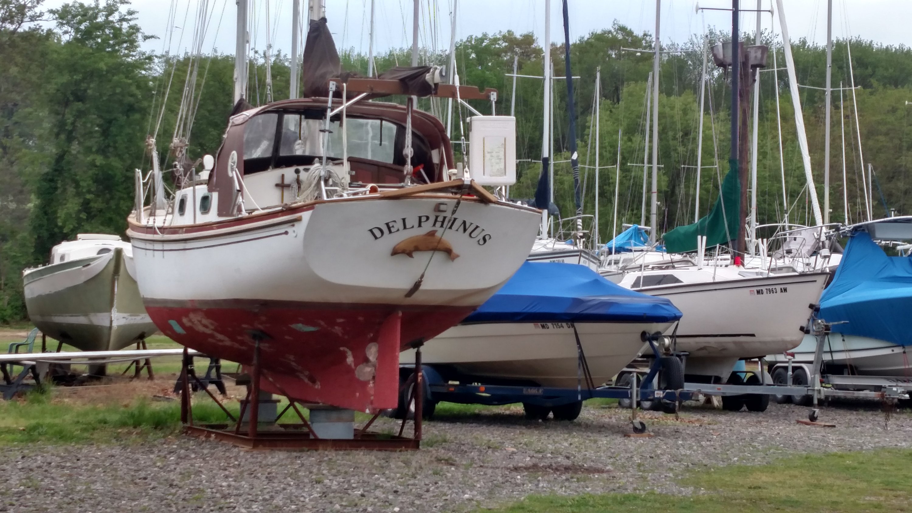

Well, worked on lights today, still not finished. Also met some very interesting nieghbors today at the marina, let's see who knows the story behind this old beauty...IMG_20180506_191844129_HDR.jpg
