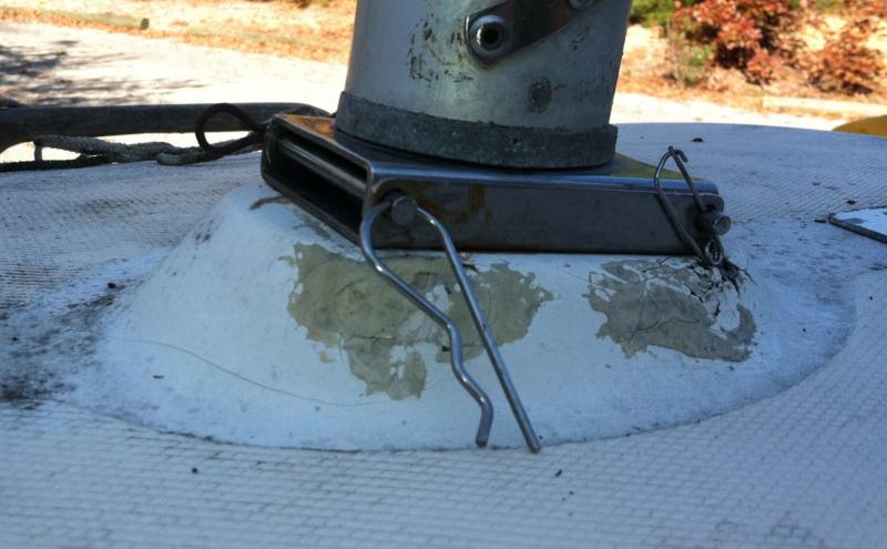

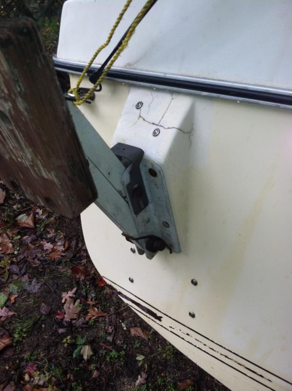

PS I attached photos of the mast foot damage and motor mount cracks.

The mast step does not look too bad, I would sail it as it is. The motor mount looks a bit worse. This is your first boat. Use a little lightweight outboard or electric trolling motor and sail it. If you like the boat a lot, repair the motor mount, or sell it and buy something nicer. Don't over thinek it, you are not crossing the ocean on it.

Before anything else, I'd check the mast step. If the core is rotted there from water intrusion where it is cracked, it could be too weak to hold the substantial load once the boat is rigged and the stays lightened. After than a thorough inspection of this area, if it appears structurally safe, rig the boat on the hard and tighten the stays and then wait a day or two to see if they have loosened - a sure sign the mast step is sagging.
Hope that isn't the case.

It's hard to tell from pictures but it really does not look that bad. Don't spend any money until you have acertained the condition of the boat. Go ahead and step the mast and tighten or tune the riggin and go sailing. If the shrouds and stays do not loose any tension right away then there might be no urgency to repair the mast step. It may be that it might take months for some loss of tension to show on the wires but heck is not a new boat so just retighten them and continue sailing. As far as the motor mount, it only has to be able to be able to sustain the weight of a suitable engine and a few extra pounds for a safety marging. Try to find a small 2 stroke engine as they are the lightest but it would have to be used as new ones are no longer sold in the US. Just grab the motor mount with your hands and pull, push and lift it and if nothing breaks I would trust it to put an engine on it. In some boats the transom will flex under the weight and thrust of the outboard engine. Unless the flexing is continuous and excessive it should not be a cause for concern. Your boat could probably work fine with a 2-3 or 4 HP engine. Anything beyond that would be a waste of money and fuel. Rowing a small sailboat may prove quite difficult so consider borrowing an engine or getting an electric trolling motor to test the boat.

One thing you can do regarding the mast step is to make sure the compression post is in good order. On a deck stepped mast, there will be support under the deck to take the mast strain and transfer it to the keel or sides of the boat. Sometimes, instead of a post there will be a reinforced arch at the critical point.... but the main thing to remember is that shrouds and stays will keep the mast upright, the baseplate area and compression post are there to support the downward pressure caused by the supporting guys.
With that in mind, you can look for additonal ways to give more support to the mast and spend that $1000 on new sails instead. If there is no compression post.... make one from a piece of pipe and build a wide keel step to spread the load around the bottom/keel area...at the top of the post, craft another block to give support to the area around the deck step.... in your driveway, rig the mast and tighten down the stays and see what happens.... make adjustments in necessary. Learn to work with fiberglass ...it ain't that hard. It's the gel coating and buffing that is expensive, and I'll bet that's where most of the expense is from your repair estimate.....'cause that picture you posted is not a thousand dollar job.

As far as the motor mount...... move it to the other side. Make a big backing plate out of plywood and bolt the mount to the other side of the transom.

Reinforce your transom with some epoxy coated 3/4" plywood and paint it if you are worried about your engine falling off. I like the lightweight older 2 stroke engine idea or electric trolling motor previously mentioned. If you will mostly be on lakes a trolling motor makes a lot of sense and will weigh very little - the battery to power it will weigh a lot more though.

Make a plywood or aluminum backing plate and through bolt the mount. You'll need angle wedge in the inside. Now the mount can't depart from the boat. You can get SS bolts of just about any length or use a threaded rod. The rest you can do a little filling and touching up. Same with the mast step. It appears sound enough. Check the compression post. Put one in if there is none. Again cosmetics. In one of my older boats, I removed the balsa core and made it of solid glass by applying multiple precut pieces of fiberglass. Sand, fill, tape off and paint. DIY!

Apply weight to the engine bracket and see if there is any flexing.... that will show you right away if there is more trouble.

Besides all of the good advice above, put a safety tether on your motor that attaches to a different point on the boat, maybe a cleat on the starboard side? I don't think the motor mount looks that bad, it's just for a backup.

The mast step now sounds easy. I decided I can fill the crunched areas with thickened epoxy. I may also add a couple of layers of fiberglass on the underside to strengthen the dome area and use oversize washers under the lock nuts. (It does not have a compression post, no sign of one being removed.)
I have put all of my 232 lbs on the motor mount. There was a slight flex in the transom, under the wedge, but the cracks on top did not visibly open up. I think I will grind those cracks and fill with some thickened epoxy and give that a try.

If there are any signs of the fiberglass or mount failing, I like the idea of epoxying plywood on the starboard side of the transom and installing a new mount bracket there.
