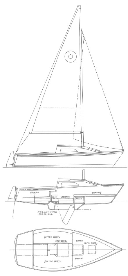

Doing a dry run and setting up your boat is a smart move. It will give you time to make sure the lines are running free.
As @Will Gilmore shares, the 192 is a fractional rig. The sail plan below confirms that.
