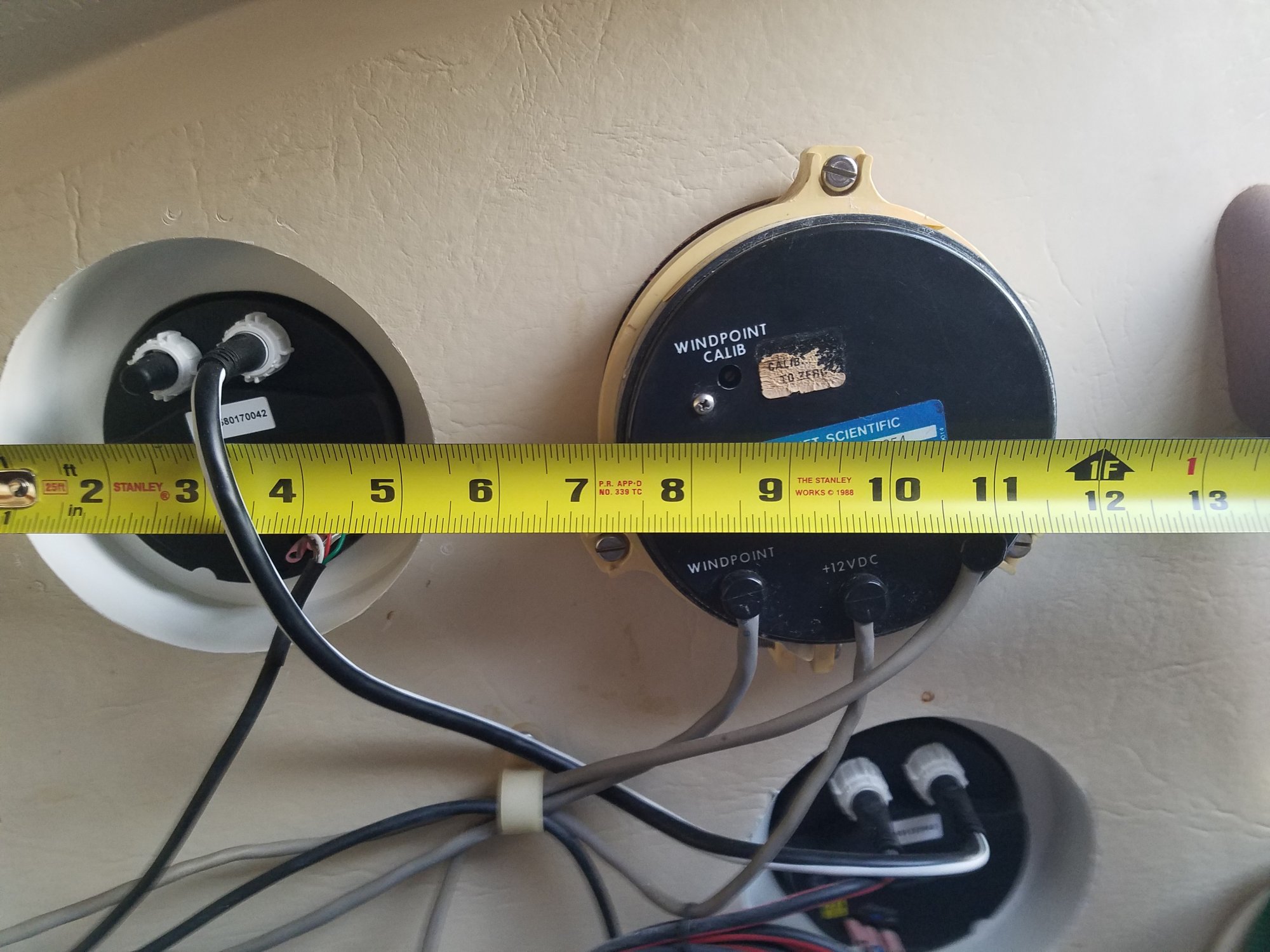

Hi all! I am sure this was discussed somewhere but am unable to find the thread. We need to replace the depth sounder on Catalina 30. We want the new one to fit in the old cut out, if possible. It is round with 4@ diameter. Anyone found any matches? The modern instrument all seem to be with square/rectangular or smaller in diameter than our current instrument (by Signet Scientific).

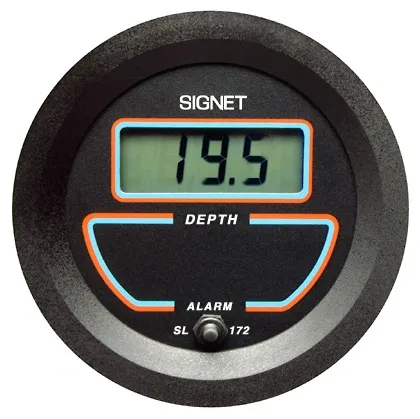

Is this what you are searching for?
If so they are found at SL172 Depth Sounder
Listed at $619, they are not cheap. A lot of alternate ideas are being used by sailors to identify and report their the depth.

Yes! This looks exactly like ours. Is this worth the price? Or if we are spending this much, should we go with the more commonly available Garmin or Raymarine? If we go with the instrument that is different in size/shake, what to do with existing cutouts? And could you please elaborate on the alternate ideas we should consider?

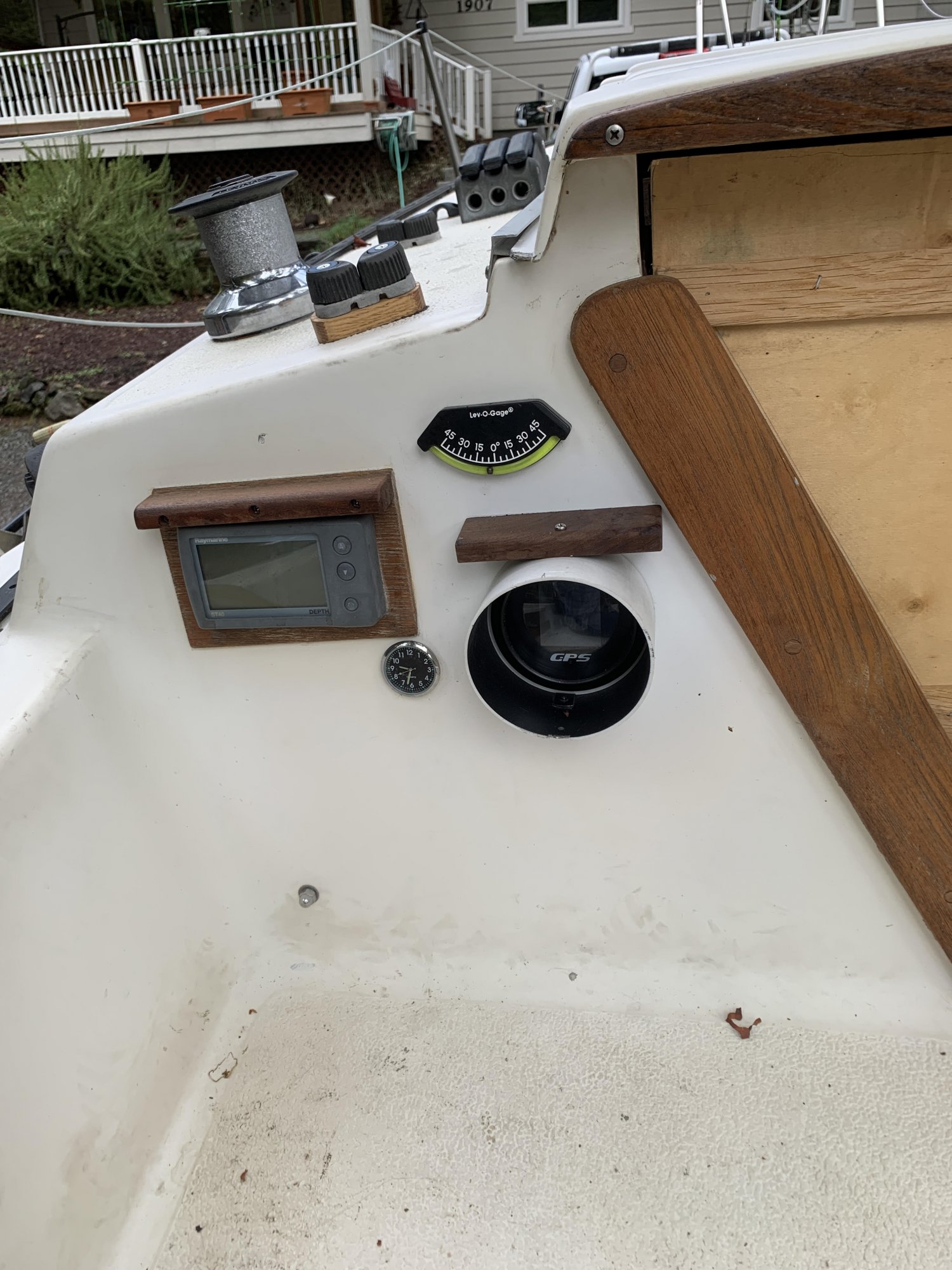

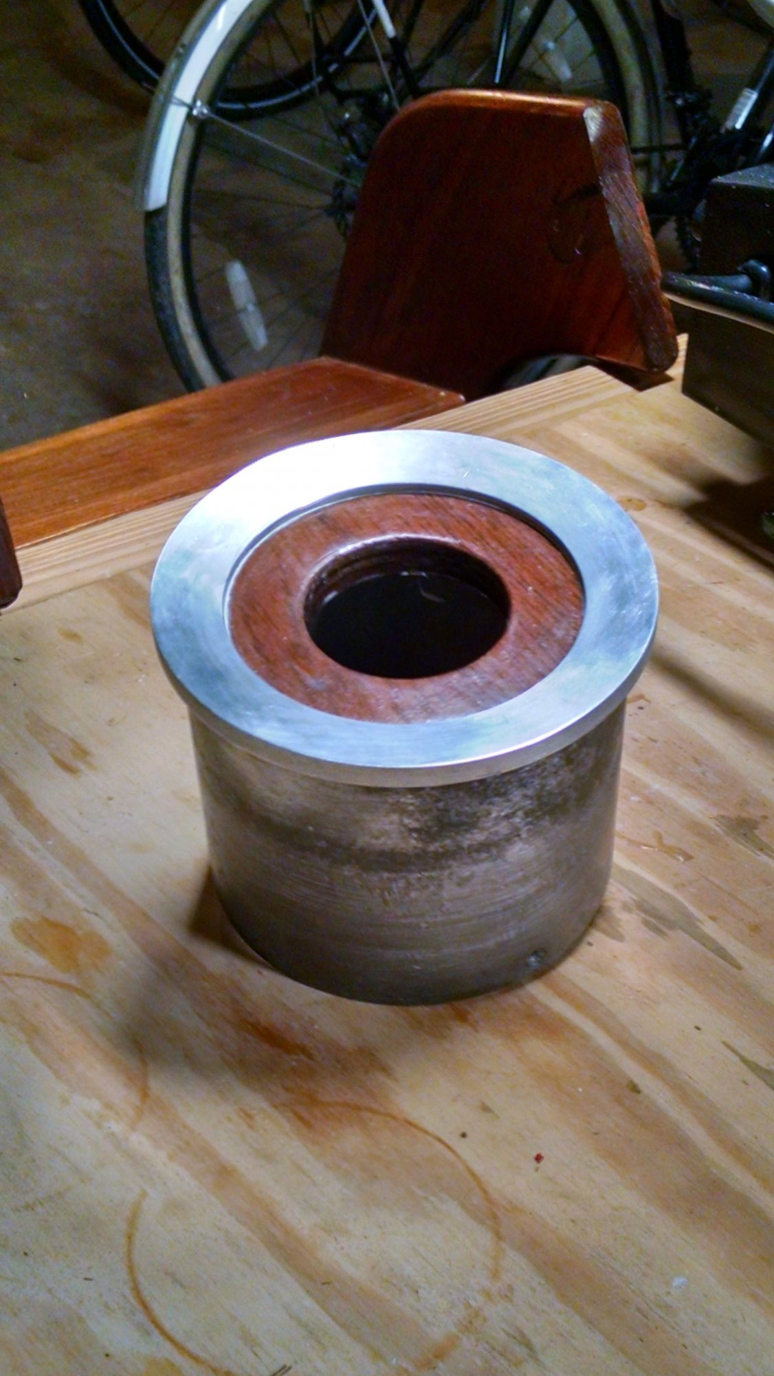

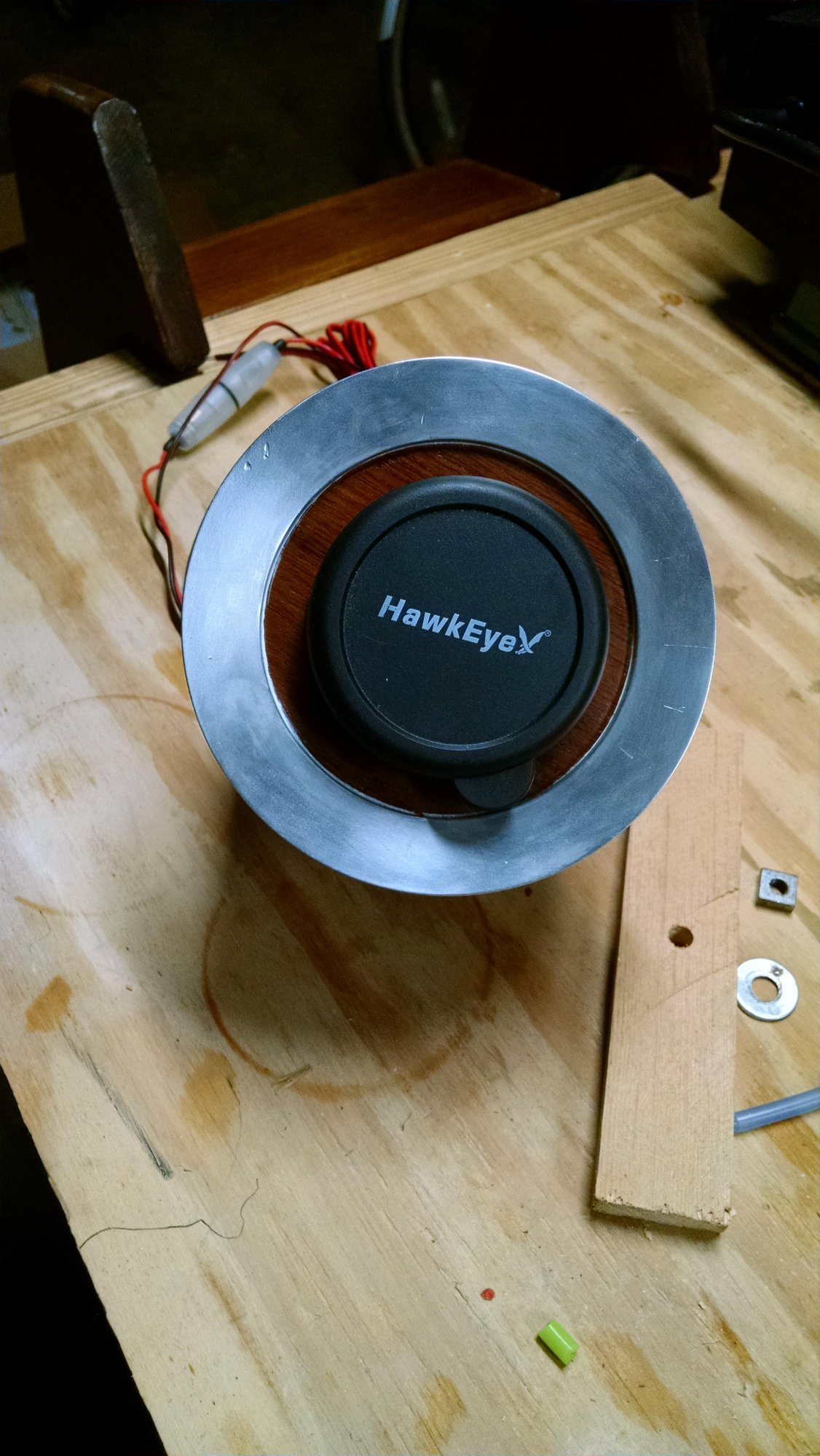

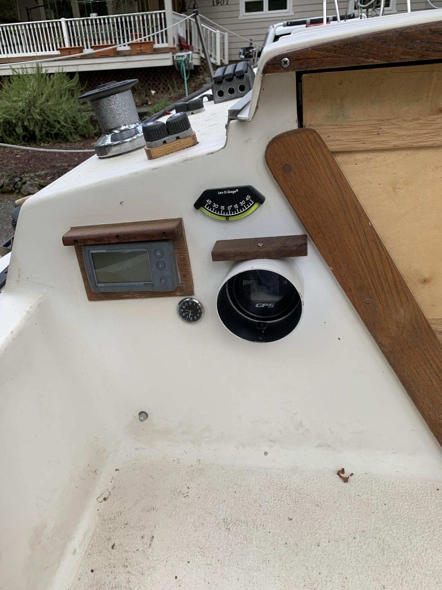

easy enough to make an adaptor ring for whatever size hole your new unit requires if you're unable to do the fiberglass work.

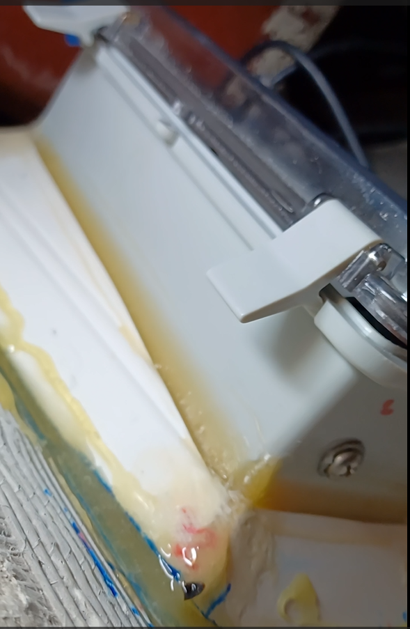

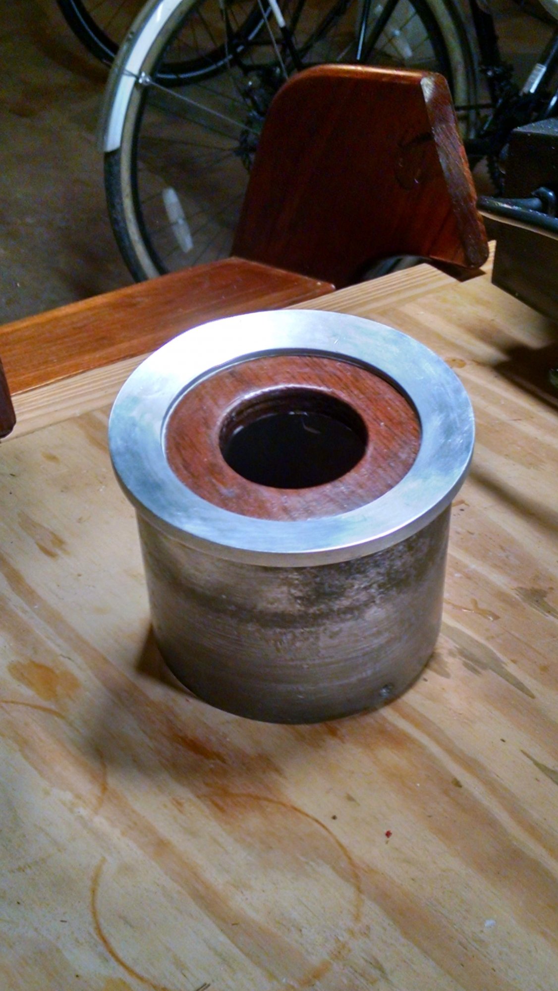

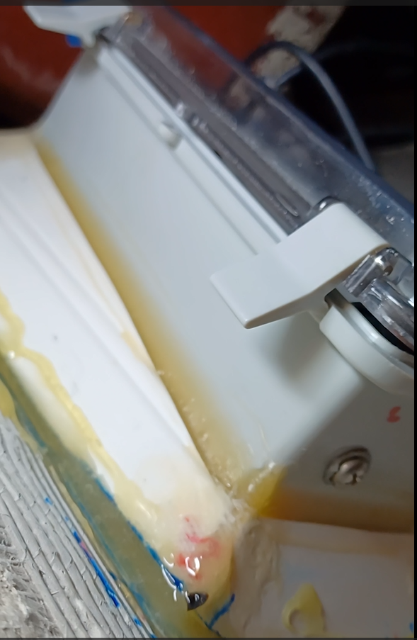

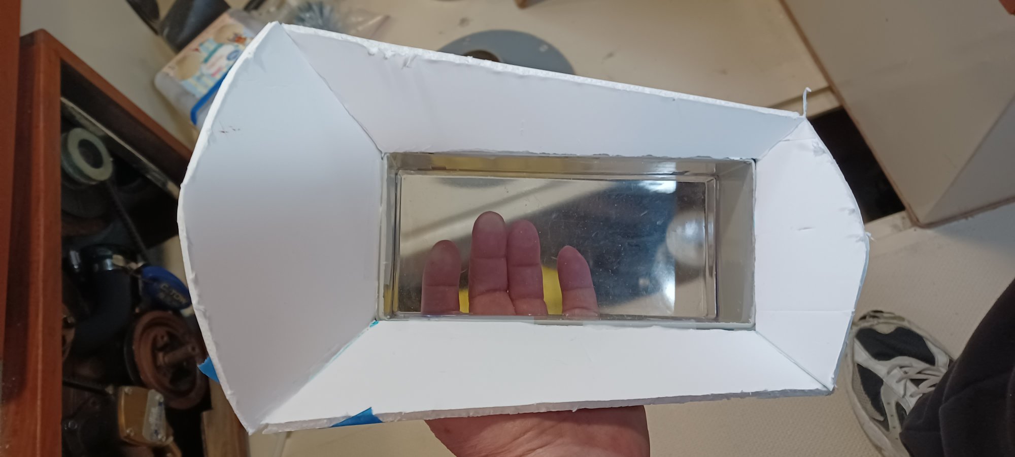

I had that same depth gauge on my C30 but went a different direction. I replaced it with a Garmin GMI-20 repeater. It can display most of my chart data or wind info.
I installed a Garmin chart plotter which also has depth on it. The Clear-vu transducer is mounted inside the boat on centerline just forward of the keel in the compartment under the vee-berth. It is mounted in a "water-box" that I made from a water-tight" electrical box and some plastic sheathing. I glassed this to the hull and filled it with Propylene Glycol antifreeze.

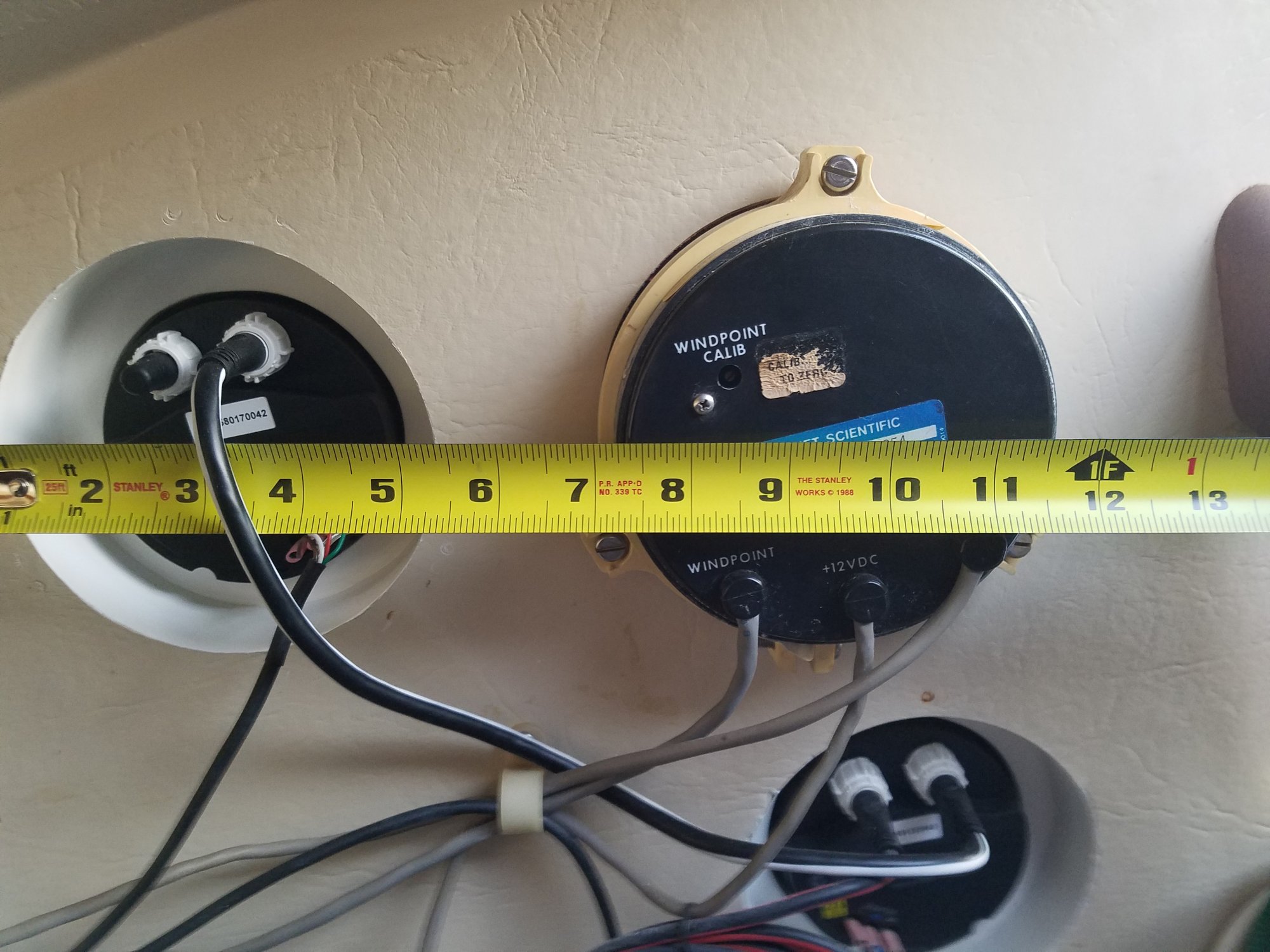

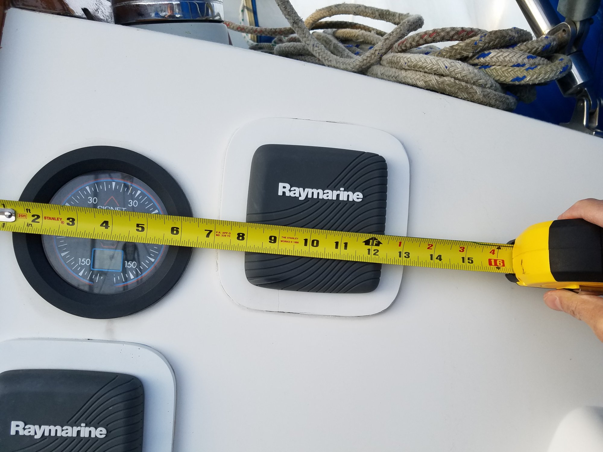

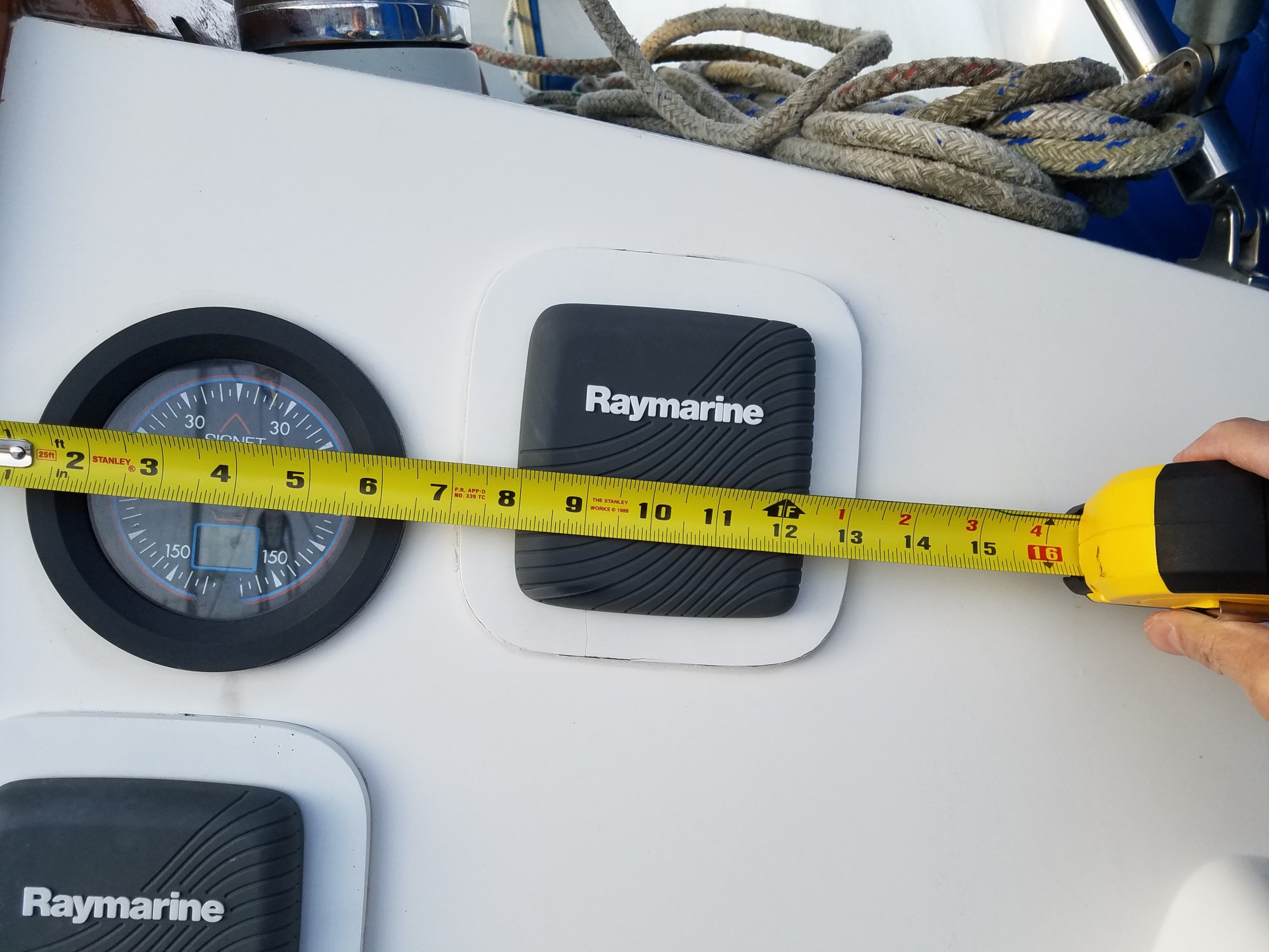

I have an 87 Catalina 30 whose signet instruments gave up the ghost. For the panel instruments I cut a mounting plate to cover the old hole and mounted the new displays (except the wind instrument which I haven't mounted on the mast yet). As a test I used some scrap 1/4" plywood painted with outdoor latex paint, so I could see if I like the look or not. I now have three new mounting plates ready to install made of 1/4" HDPE Plastic Sheet, Starboard would also be a good choice. These pictures are from 2019, I really need to replace the wind instrument.

This looks very nice!
What Raymarine model did you replace Signet instruments with?
Did you have to replace transducer as well?

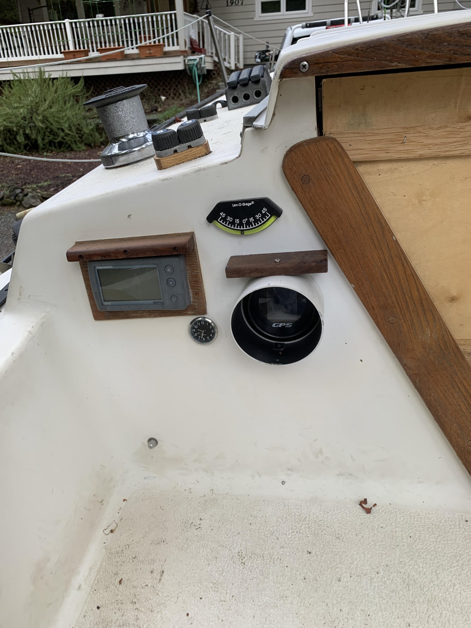

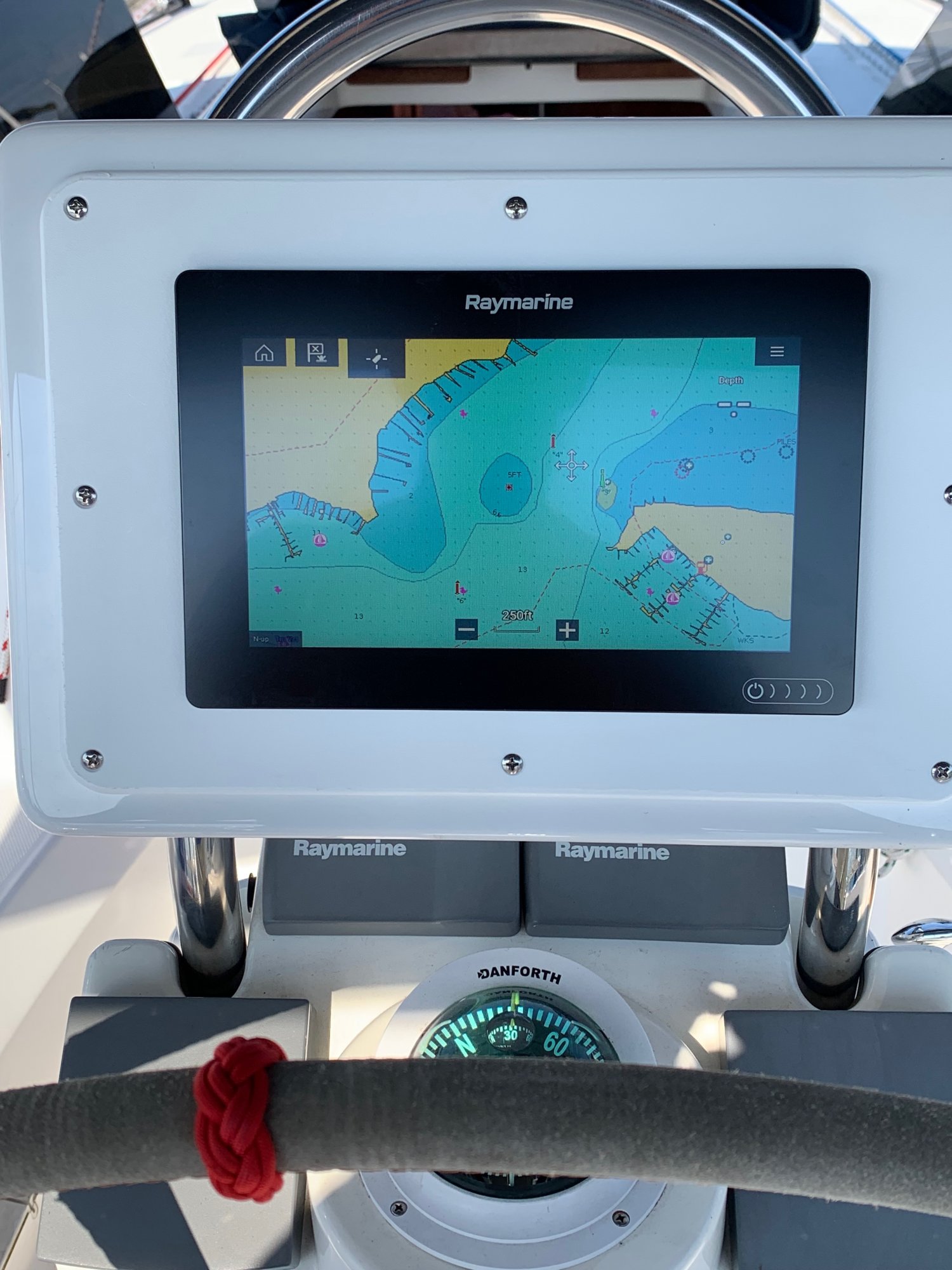

There are companies that will cut the starboard to your specs, bevel the edges, and round the corners, all for not much money. I did this when I replaced my chart plotter, to make it fit in the existing navpod:

I have the Raymarine i50 depth and i50 speed instruments (and the i60 wind instrument, not mounted yet). The depth sensor has to be replaced, but it wasn't too bad to do as I recall. I replaced both the depth and speed sensors, one was easy and the other turned out to be just as easy once I decided to drill it out from under the hull. You will need a hole saw drill bit, a drill and some sealant. Maybe a hammer to pound out the sensor, I used it on one the sensors. If the old sensor is in a bad spot you can add this one in a better spot and leave the old one alone, but then the old one becomes one more thing to worry about. I have my sensors installed in front of the keel and behind the front water tank cutoff valve.
