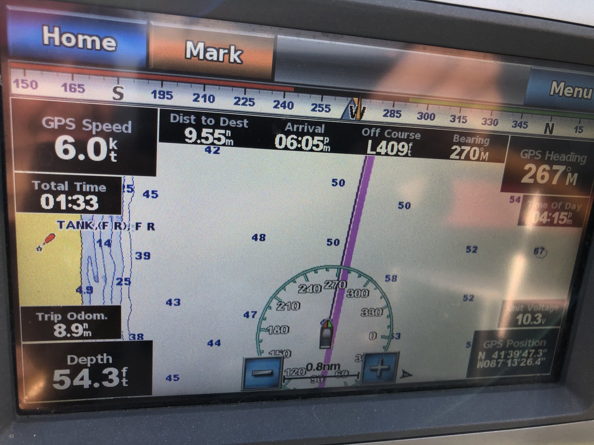

You can see a few different screen layouts on my Garmin Chart plotter in these shots...depth is always available to me...
upper right on this screen...
lower left on this one...
the screens on my Garmin are customizable, so I can move the depth info where I want it.

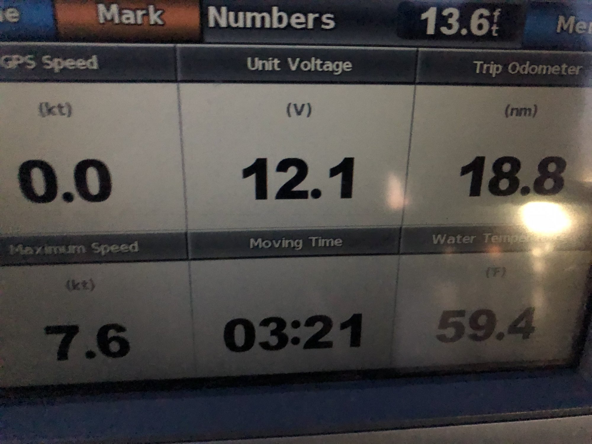

And one of the cooler functions I found on the CP is the ability to show the system voltage...
so now I don’t have to guess or check the battery gauge at the Nav station.
Greg

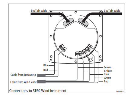

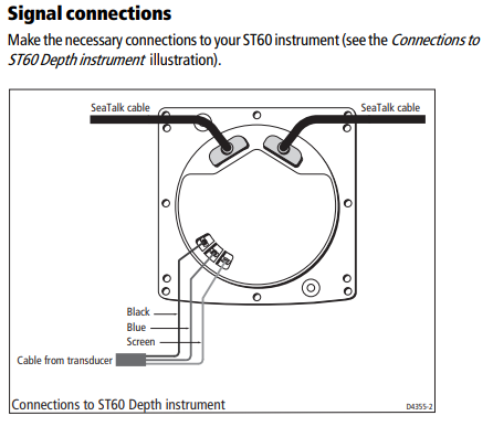

Note that the older Raymarine gear, basically anything that is Seatalk, requires that the display unit be connected to the transducer. I believe that the display unit converts the signal from the transducer to seatalk and puts that data onto the seatalk network. I don't believe the output of the transducer (depth, speed, or wind) is NMEA0183 or Seatalk. I believe the output of the transducer needs to be converted to before it's put on the network.
For ST 60 Depth
And for ST 60 Wind
I don't believe the output the transducer is NMEA.
The newer transducers may be NMEA 2000 but the older ones are not. Anything SONAR that is CHIRP or high resolution will not be NMEA. Same with RADAR.
Barry

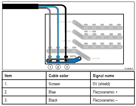

I took an old transducer that was in the boat. My guess it was a 80Mhz unit from about the mid 80's. I connected it to a RayMarine iTC5 box.
Three leads from transducer.
Colors for the 2 leads are dependent on the transducer..
Positive to terminal 2. Negative to terminal 3.
And then powered up the iTC5. The box powered the transducer and received the depth signals in pulses. The box converted the pulses to SeatalkNG (183 messages) and placed the data on the backbone. I pick up this data on my Vesper XB8000 and transmit the data in the backbone to the iPad running an App that reader the data and shows it to me in a GUI (i.e instrument image) that I can understand. It shows depths up to 300feet then it reports garbage (signal too weak or taking too long to return from the bottom).
Yes you can use an existing transducer if you make proper connections (wire the system correctly) and can then translate the data into a usable signal (a black box) your hardware can display to you in a manner you can understand (your MFD).
Pretty simple really.
