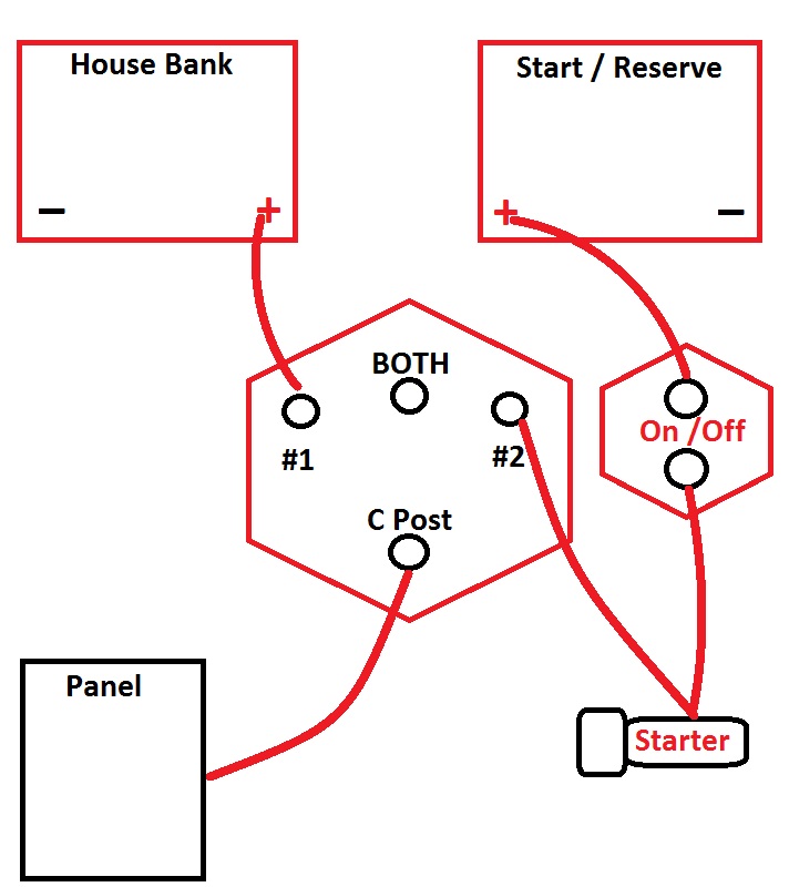

Maine Sail: quick question (I hope). I'm planning on rewiring our Catalina 310 and using this dedicated start battery wiring scheme. Would it be a bad idea if the On/Off switch was next to the battery, and not easily accessible? Or should it be in plain view, and turned off when not on the boat? Logistically the former is easier.
Feb 6, 1998
11,722
A switch could easily be flush/back mounted on the front or side of the settee where the batteries are located. Battery switches should always be easily accessible for emergency use.
Nov 16, 2012
1,055
Catalina 310, 2000, #31 31 Santa Cruz
Got it. Thanks!
