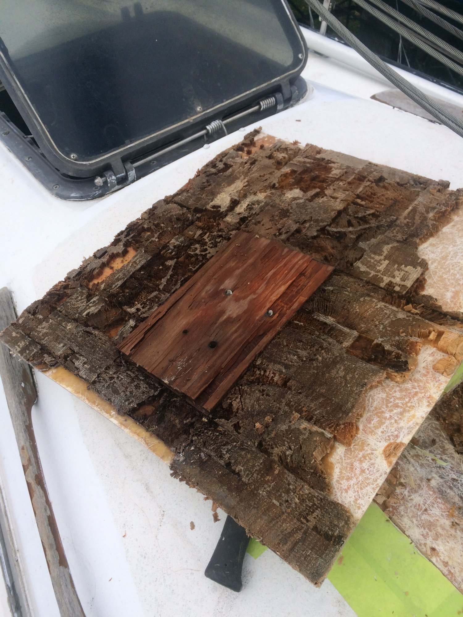

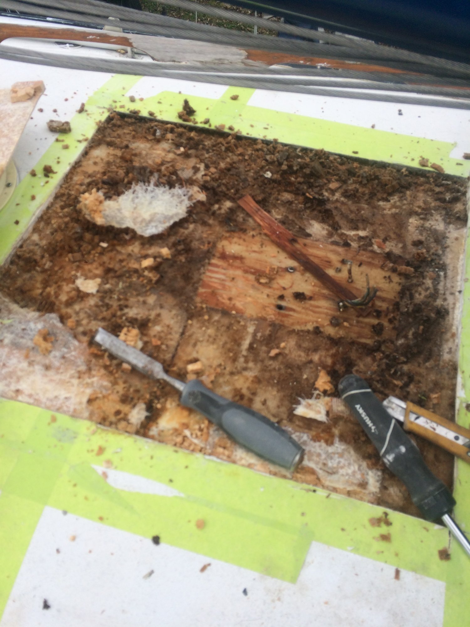

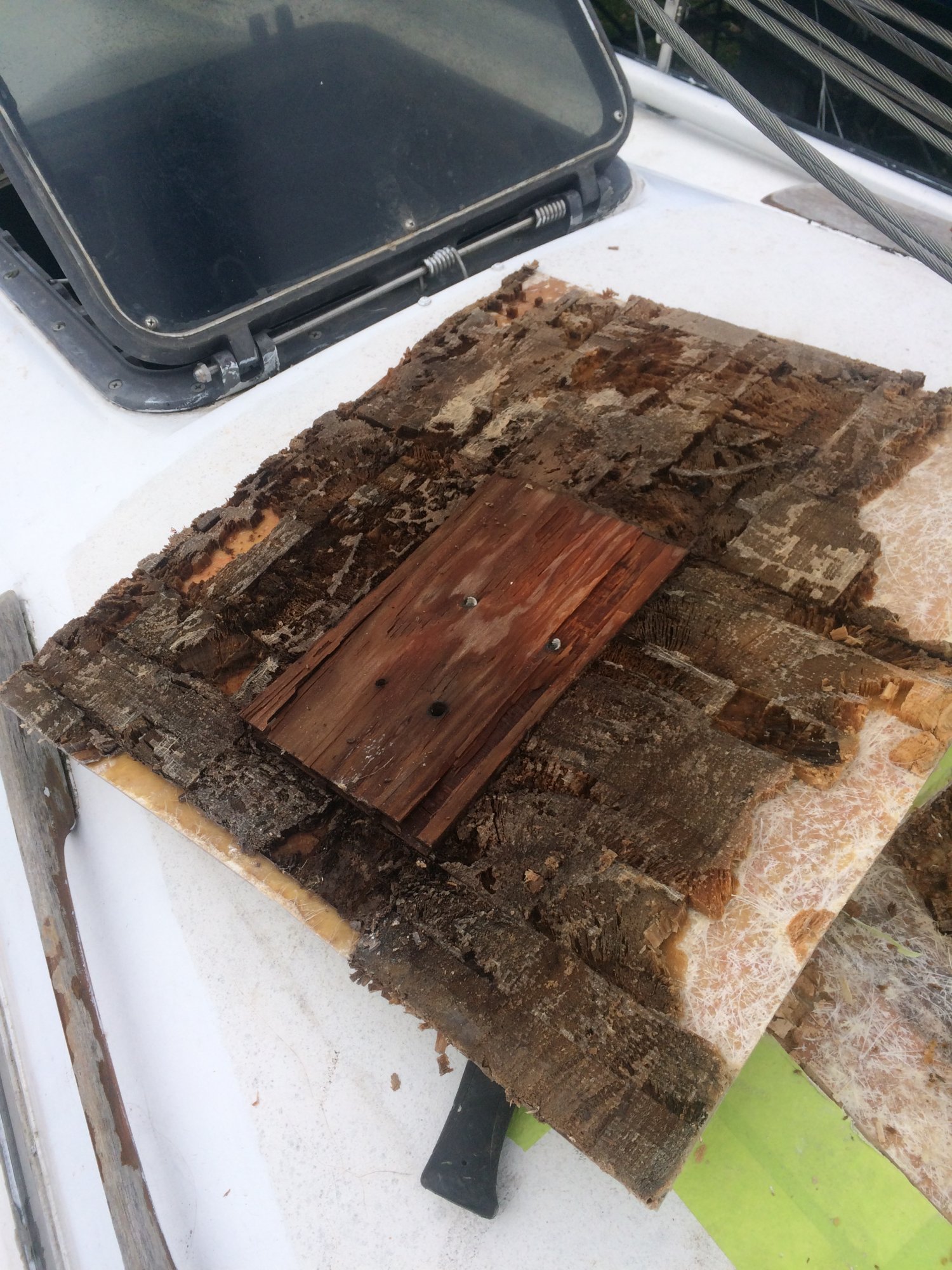

looking for recommendations on repair material.
i have removed the tabernacle fiberglass skin and wet core from my c&c27mkiii and found what was left of a piece of marine ply that was sandwiched between the skins under the mast step.
do i use another piece of marine ply? stainless plate? or build up solid glass?
any recommendations would be appreciated thks.
