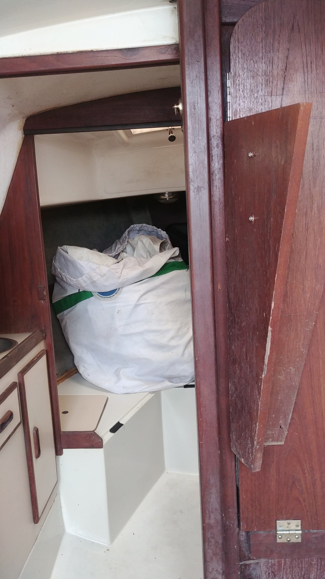

Thanks for response. Have looked at other posts and have an idea of what I'm getting into but, I guess, am looking for best approach. Haven't looked super close yet but will look at step at base of post. I'm guessing post sits down inside the raised portion of cabin sole. I'm going to have to remove bulkhead so, guess I'll see how to access everything. I will have to look again but, believe the deck is raised where the mast steps to deck. Could be settling there.

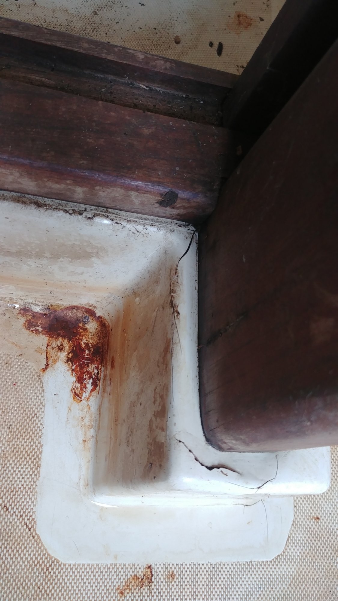

Thanks for the response. Went out and looked at it some more a couple of hours ago. Not knowing what it looked like before, looks like it may have sagged at the base. The cabin may have dropped a little also. The sliding door doesn't close so, that may be the cause. The compression post doesn't appear to go to the keel rather, it's in it's own glassed box, above keel, like your referring to if I understand your post. Top and bottom of post are both covered by a cosmetic gelcoated cover. Guess I'll have to cut them, hopefully in a way I can gain access then, glass them back in. Think I'll have to start on the bottom.

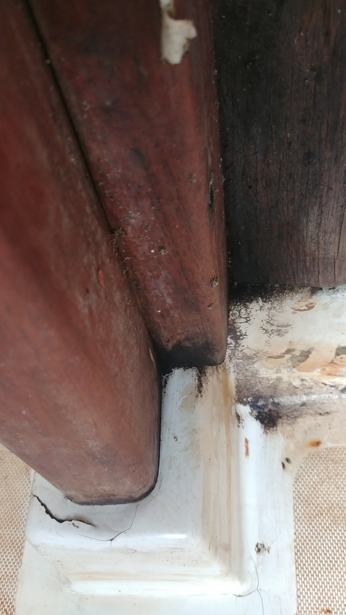

Am probably going back tomorrow and will take some pics. Need to clean at base of post because there is dirt in where it appears to be dished also. What I can't figure out so far is whether the post sits on top of fiberglass raised section, with all support underneath or, Does it pass through. Definately does not go all the way to keel.

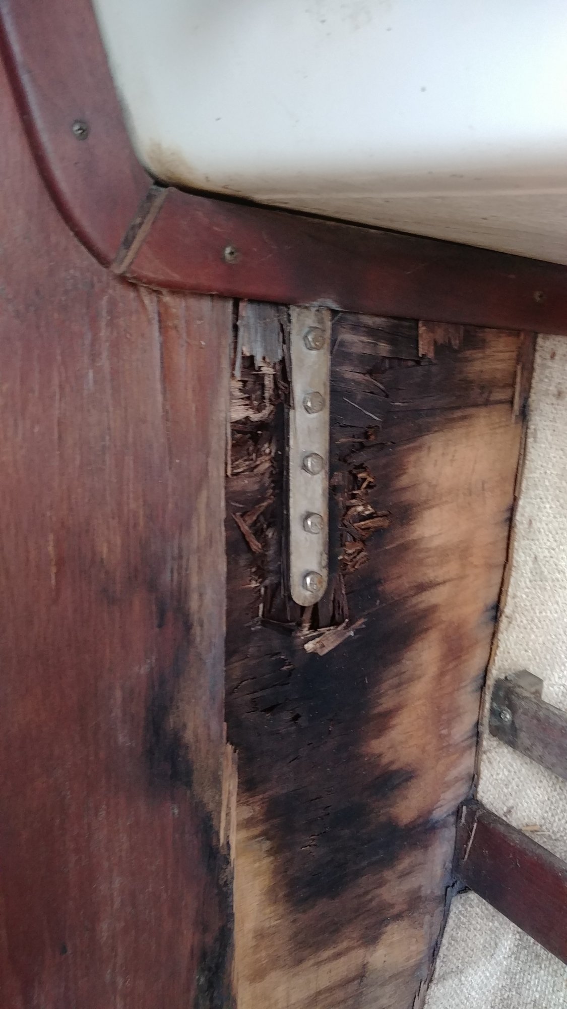

Think I've found my problem. I'm guessing but, not sure, that the base of the post sits on top of the extrusion. How it's attached, I have no idea. Don't know if you can see in third pic but, the whole post looks twisted and possibly not centered. My guess would be to remove post and cut and repair extrusion base. Could use some insight. I'm sure it's leaking thru deck and chain plates. Pardon the mess but haven't put any time into cleaning yet. Gots repairs to do. Bulkhead not doing much.

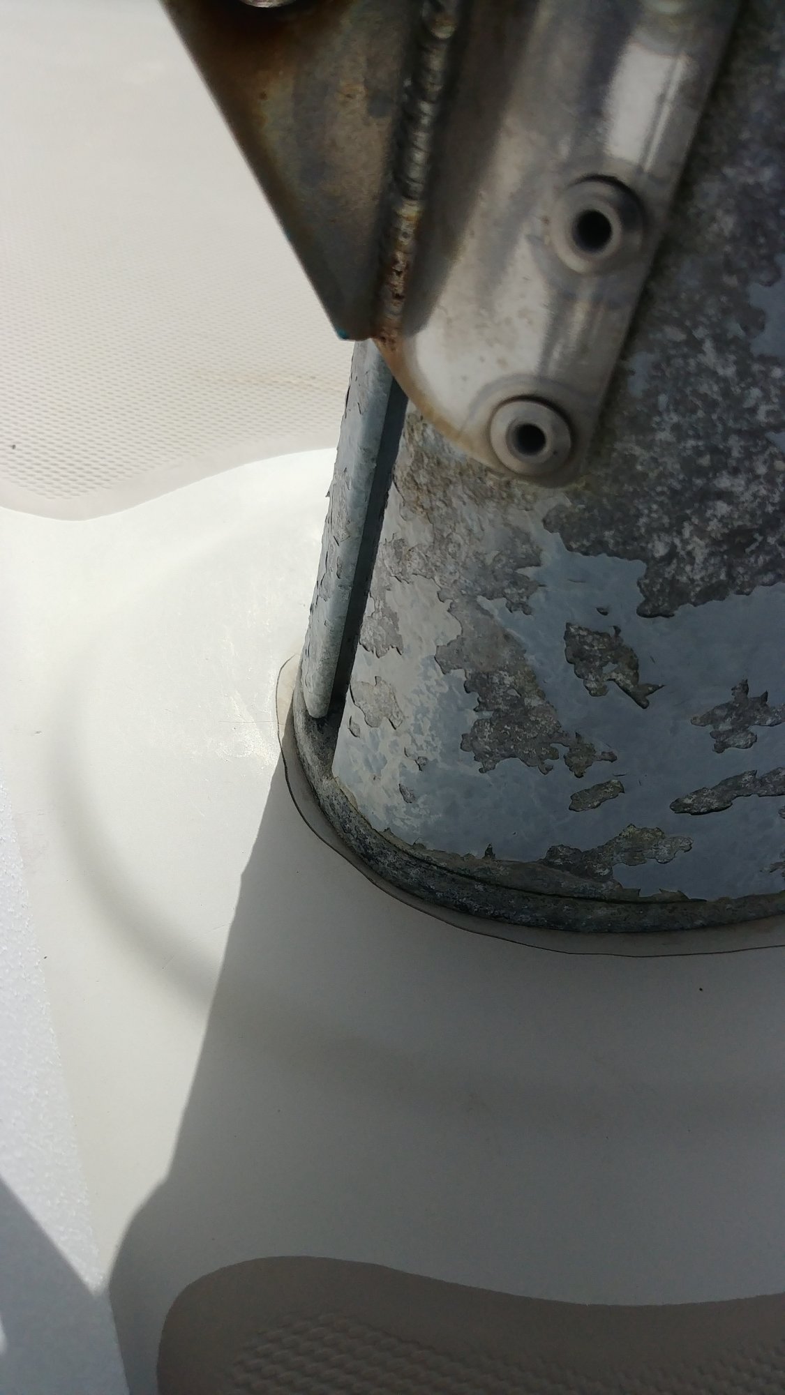

Deck cracked and dished. Guess I better get the mast down soon. Was thinking to at least back of stays and jack it up some.
