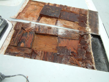

great pics!!!!
MATHURIN2
The pics are truly great!!!.... I can see what to expect in the deck and know that the job is "doable"....

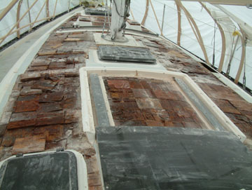

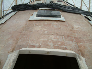

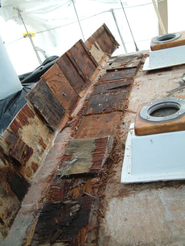

From the pics, I see that the plywood appears butted against each other - and that there is no separation between blocks.... is that right? is that a "Marine Plywood" as well?
When looking at deck cores, good choices seemed to boil down to End Grain Balsa or Corecell... Marine Plywood or a specific version of Cork would work - but I am not so happy to use them...
I would give the "nod" to plywood for strength.... but it might not be necessary.... Balsa just keeps coming to the top of the list for bending and cost reasons...
cutting the sheets of balsa into squares and then laying them down with a small gap - filled with Epoxy does make a lot of sense to me...
Also... another test to do this week would be to hit the deck with a rubber (Harder type) tipped hammer - and do an accoustic/"feel" type test.. if there is separation - I would think to hear or feel the difference.... I will do this on my "grid" pattern - at about 6" intervals...
On the deck hardware - where there is a structural need - I had planned to use layers of 8oz fiberglass - stacked up. Might be a good place for some other weights as well.. Anyway - its a plan at this point......

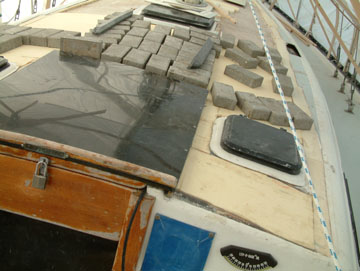

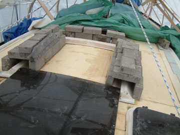

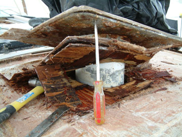

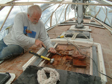

As for core removal, here is what I suggest:
-A grinder with a 6in blade to cut the top skin (removal of the skin should be straight forward, on mine adherence was minimal everywhere) Make sure you cut the skin within 2.5in from the side to keep the shape.
-A flat prybar to remove the old core
-A 6in twisted wire brush (on the grinder) to remove the core in the sides
-A scraper to remove most of the leftover core
-A 6in disc with 36grain paper (on the grinder) to remove the bits of wood remaining
-As for core I went with core-cell, and denitively suggest you go that way.
-For the cabin top, I went with 4'X4' sheets (precut in 1in squares)
-For the side and the cockpit I used 6in wide strips
-Note all core is 3/4in tick except around the cabin top wich is 1/2in tick
-Remove the hatch slides and enclosure
-Remove the forestay rail
-If I had to do it again I would remove the dorade boxes
-If you have the money and the time go with epoxy. If I had knew how much resin I needed at the begining I would have saved buying a 45gal drum of epoxy instead of buying polyester in 5gal batch (I ended up using 40 gal).
-Buy at least 10 pounds of tickener (I used Aerosil)
-I used bricks to hold the core down
-Don't keep the old and leaky top skin, lay 3 coats of new fiberglass
-Use of rollers to lay the fiberglass is a minimum if you don't vacuum bag, this is what I did.
-I used tickened polyester to faire the whole deck.
-I used a stucco roller on tickened polyester for the nonskid (this significally reduces the need of fairing in the non-skid areas).
As for tools:
-A paint mixer to put on a drill
-An old drill you don't mind getting rid of at the end
-Some fiberglass rollers
-A bunch of wooden handel paint brushs (paid 1$ for 5)
-Plaster trowels
-Grinder with 6in sanding pad (36grit)
-Straight line sander (this is a must, 36in grit, 80grit)
-6in orbital sander (80grit)
-Fairing file
-Stucco rollers
-Lost of empty ice cream buckets (4liters ones)
As for primer and paint, I used a roller this is the way to go if you don't want to spend months fairing...

WOW Big Project. Thanks for the photos. Super. And you did this with the stick up. I would never have guessed that the whole deck was originally blocks of ply. Is that balsa coring I see? What laminations did you use to build the deck back up?

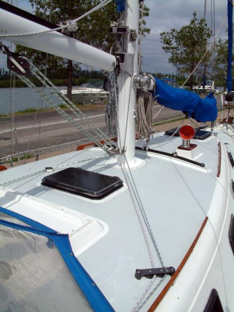

I used 1810 (18oz biaxial (0/90) with 10oz mat, 50" wide) 3 to 4 layers, by the way you will almost need a full roll (50yd if i remember well). No balsa core was used only core cell (it's precut to follow the shape better) only downside is that it takes a bit more resin to fill all gaps.

Sorry if I missed the answer above. But how did you deal with the main source of water ingress on the H37C, the toerails? It is hard to see how the coring fits under the toerail.
Sep 10, 2009
194
Hunter cutter 37 1981 St-lambert
Toe rails aren't an issue (from what I saw), as the toe rail is screwed trought solid fiberglass. Core stops about 1 inch before the toe rail, then the bottom layer merges with the top layer. The only concern in that area is that the top layer is really thin (scary thin if I may say so), in some area there seems to be just one layer of fiber. Removing the toe rail and adding a layer all the way to the side would be a good idea if someone is planning to do a perfect job, but for my part, I left it that way (I took in consideration that if it lasted 25+ years this way, and removing the toe rail didn't fit in the tight scedule)
As for planning, I would say that being retired is a big plus if you plan on doing a job like this (it'very time consuming 1300h +). As I live in Canada, where outhaul are necessary during winter, I decided to use that time out of the water to work on the deck.
I decided to do a full deck recore because after inspection, the cabin top was 100% delaminated, the sidewalks 75% wet/50% delaminated, and the cockpit was 100% delaminated. So instead of playing the guessing game on where the rot stopped, I decided to open the whole thing. The only rot left is on the cabin sides, as I've not decided yet what future I reserve to the cheap plastic portholes....
