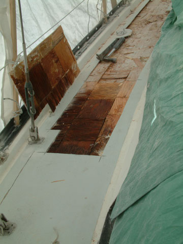

I am "scoping out" the work necessary for complete Deck Recore. I think how you approach this in terms of work and cost - can vary TREMENDOUSLY.
So I am seeking advice on some elements... It may be beyond my skills or budget - and certainly is new territory..
Background:
I have a H37C Katrina boat that took some damage. The Cabin and Motor appear in very good shape - and is certainly something I can work with. As a 25+ year old boat, it would normally be taking some work at this point anyway... so new thru-hulls, paining and such could be expected. There is a lot more to however.....

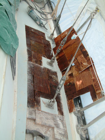

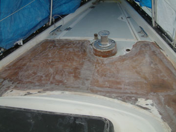

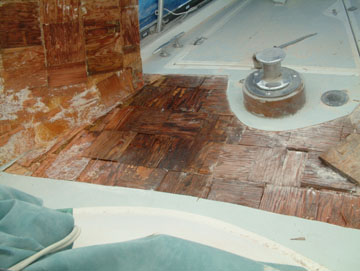

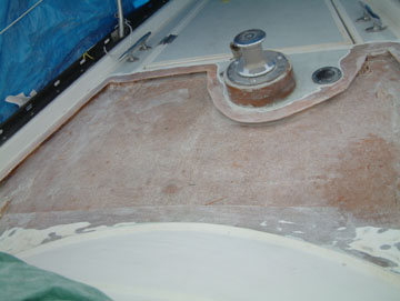

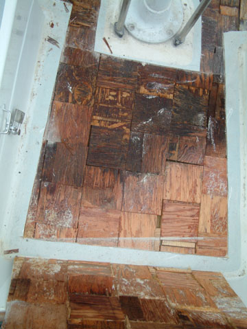

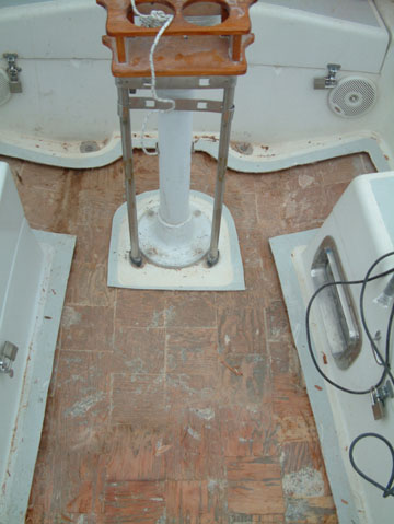

I have transom damage and deck/hull separation on one side. As a result, there is a lot of water to the core damage... With a moisture meter, I measured the deck and marked (with a white board marker) the moisture numbers... first in black - then switched to 3 colors to get a sense of relative in-deck moisture.... The results are pretty grim. Looks like it would be a lot easier to just recore the entire deck - as well as repairing the two major damaged sections. Because of material age, Epoxy would be the working adhesive....
Question.... Deck Recoring Material

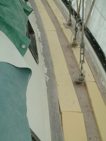

I have seen a lot of materials mentioned with some success... Has anyone any real preferences based on recoring substantial areas?
Marine Plywood - I had about ruled out.. but done right, it might work out OK.... Ditto for NiidaCore - But I do want to look at it first...
I have seen favorable reports for Core-Cell, ProBalsa Plus, and some others - these seems to be well thought of.
Each material seems to have pluses and minuses.. I am concerned about the bend radius for cabin and cockpit.... Also about structural contribution to deck strength.......
I just want to figure out if I can do this work - I think I can at least - but pick the "right" deck core material to work with.... I also understand bout making local "strong points" around all mounting hardware and chain plates...
suggestions are deeply appreciated.. I have Vaitses's books - and a few more...
I also read the link at:
http://forums.hunter.sailboatowners.com/showthread.php?p=458436

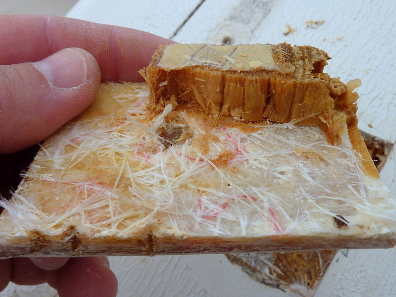

That said - it seems like an electric scraper or an air driven chisel would be a great help in stripping off the soggy, "ex-plywood" materials.. I would not attempt with a hand held scraper or 7" sander... suggestions??
Thanks all for your input.... It's always hard to really scope out a big project like this - and decide if I want to tack the full cost and time required...
--jerry
