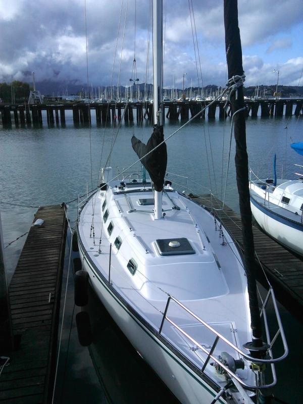

My thread similar experience was last summer when seven years after the first application of Interlux Perfection (2-part polyurethane) on the smooth sections (not the non skid) of my cabin top and deck, I did the same again. The second coat of the new project was applied too late in the afternoon so condensation that night caused an inconsistent gloss on the sloping forward section of my cabin top. Too avoid excessive sanding, each subsequent coat has to be applied within a specified period. From memory that window is not later than the Next Day.
Here I am doing the work at my berth in the San Francisco area during the summer months. Chance of unforecasted rain on any summer day is like .001%. But for my painting window, the forecast had like a 5% chance of rain for 50 miles north. Not expected at all to move south. So I went to add another coat mid-morning. Just as I was half way done, huge rain drops started to hit and disfigure the still tacky paint. And I had to keep going to maintain a wet edge. I remembered that I had a tarp down below. Just get it out to tension over the stanchions and life lines and I might be OK for the rest of the painting. What I didn't remember is that I had last used that tarp for carpentry work. When I went to open it, the prevailing wind blew the sawdust still on it right on to my paint's still tacky surface.
For several moments, I was tempted to open all my seacocks, cut the hoses and be done with my boat for good. Common sense did prevail.
The next morning I sanded smooth the best I could and applied yet another coat. Not the new car finish I was hoping. However no one seems to notice but me (photo attached).
As for the rain. Not another drop from the moment I covered my still wet job with sawdust.
