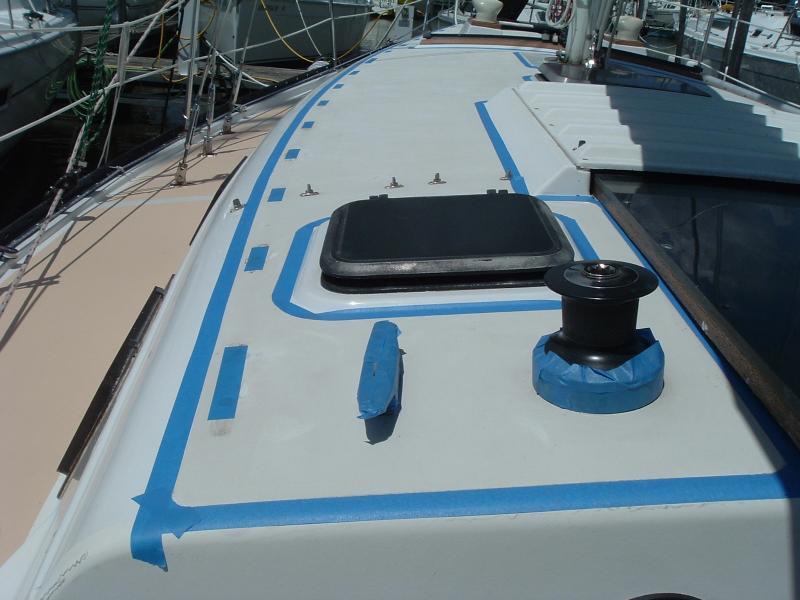

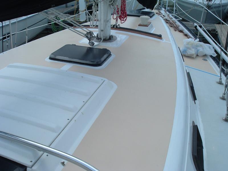

Are you asking about the entire deck, both the white gelcoat and the non-skid? For the white I also used Interlux Toplac. Now that I have experience with two-part I would use Perfection after the Interlux Epoxy Primer. There isn't that much white on my boat, mainly the cabin sides, so keeping a wet edge would not be that difficult.
For the non-skid I used Interlux Interdeck the second time around. I mixed my own the first time and did not like the results. Some, like Kiwi, are too agressive for me.
what color did you use there.. i like it. Right now my nonskid is all grey like yours apparently was.

My non-skid Interdeck is the "Sand beige" Billy. When I did the smooth I mixed 2/3 white and 1/3 off white of the Toplac. I think the reason we see no Toplac is because they improved Brightside to the point there was no longer a difference. Still I would go with the 2-part Perfection. The "smooth" is easy because the only masking is the portliights. Mine were out at the time so I free handed the whole thing. Only had to be careful at the toerail. All the other edges are covered with the non-skid. For that lots of taping.
When I did the white I painted a two inch stripe down the middle of the boat, from the anchor locker to the spray hood. That way I only had to do half the boat at a time. Much easier to keep a wet edge. Oh, and also did an angled stripe near the shrouds. This gave me a place to stop and to walk so I could get off the boat.
