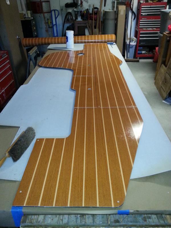

I'm actually redoing the cabin sole on Eagle right now using Lonseal teak and holly. You apply the epoxy with a notched trowel, and once you roll out the vinyl, you have continuous contact. Even the edges are tight and well-adhered once I trimmed them flush. Truth is it really looks pretty darn good, and shouldn't require any of the future care and maintenance that wood needs. I'll post some pictures when I'm finished in a week or two.
It's not a cheap solution though. For our H336, I think we have about $600 tied up in the job, and that's doing the work ourselves. We'll have some left over though, if anyone's interested in making an offer. I ordered 11 lineal feet from Defender (it comes in a six foot width) and for some reason the nice people there sent me 14 feet. So I'll post the dimensions of what's left when I'm done, but it should be big "L" shaped piece that's about two feet by 14 feet the long way, with the short side being about 3.5 feet by 6 feet.

I ran home at lunch and took a quick pic of what I've done so far. This is about 2/3rds done, I have three more sole sections to do. Not looking too bad, and it will be nice not to have to worry about getting a little water on the sole, because it's vinyl over epoxy. Oh, and no more varnish!
Dang Robert, that's looking really good! Did you re-use your existing sole panels or make new? If re-using old, did you have to do any removal of old material so as to not build up additional thickness?
Props on the job!
Ken
I used the old panels. They were still solid, they were just ugly. The previous owner had stained them a dark walnut color, or maybe even used brown paint, I'm not really sure. They looked terrible though. I took the finish off with a belt sander and then applied the Lonseal. None of the sole panels in a 336 have to slide under any interior cabinets or fixed furniture, so any thickness issue should only consist of the sole standing just a little (maybe 1/16th of an inch or so) proud around the outside edge where the panels set in molded recesses in the floor pan.

Robert -
Nice! How are the panels reattached to the floor - wood screws and finish washers?
