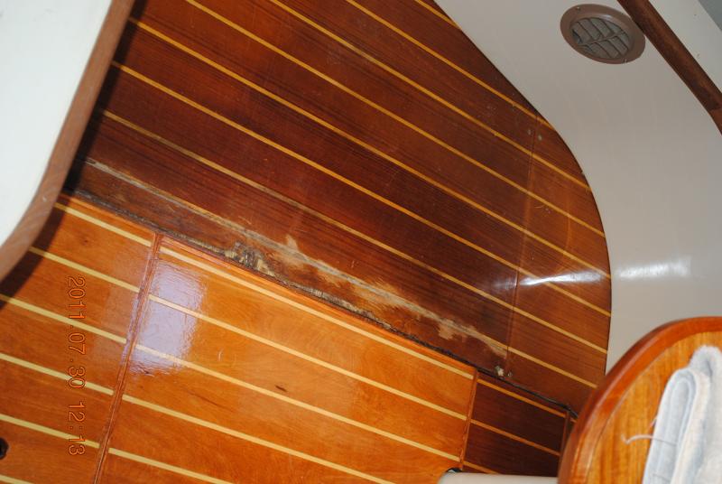

Jun 6, 2006
6,990
DIY flooring for less
Home depot 3/4" oak ply
3/4" aspen
1/4" router bit
jack plane
circular saw
table saw
can of teak stain
sort through the ply for a piece with straight grain that looks like teak
use the old floor as a template and cut out the new piece.
mark the places for the "holly" matching the old floor
route out 1/4"' groves for the aspen "holly" 1/4 deep
rip the holly 1/4" wide by 3/4" deep
stain the oak plywood avoiding the groves
glue the aspen in the groves, it will stick up 1/2"
after the glue dries hand plane the aspen down to the level just above the plywood
finish with water proof sealer of your choice
The new section is in the sun on the right.
