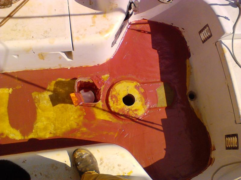

on my 1980 33 the plywood core was way beyond injecting epoxy, the core resembled mud in some places. the diesel fill in the center of the sole was the main culprit. maybe only the 1980 model had it there...i replaced the sole with "coosa" a fiberglass reinforced closed cell foam core and raised the pedestal mount to prevent future leaks. The diesel deck fill will be moved to the side deck but the efficiency of the little yanmar hasn't made it much of a priority......
Oct 25, 2011
115
Hunter 1980 H33-C Annapolis
oh and the aft extension of the "pedestal platform" will be to prevent water from sitting around a plate to cover the rudder head for emergency steering

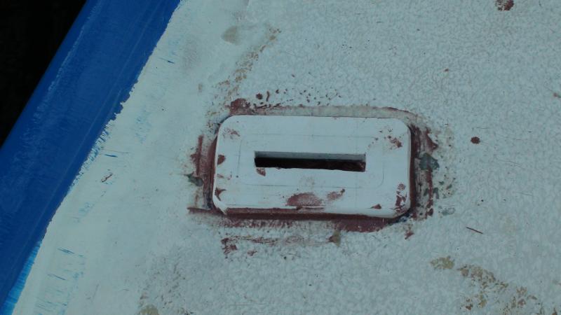

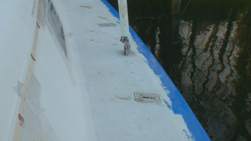

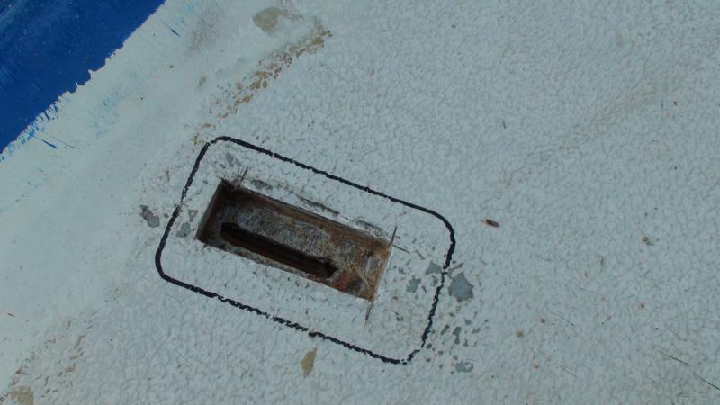

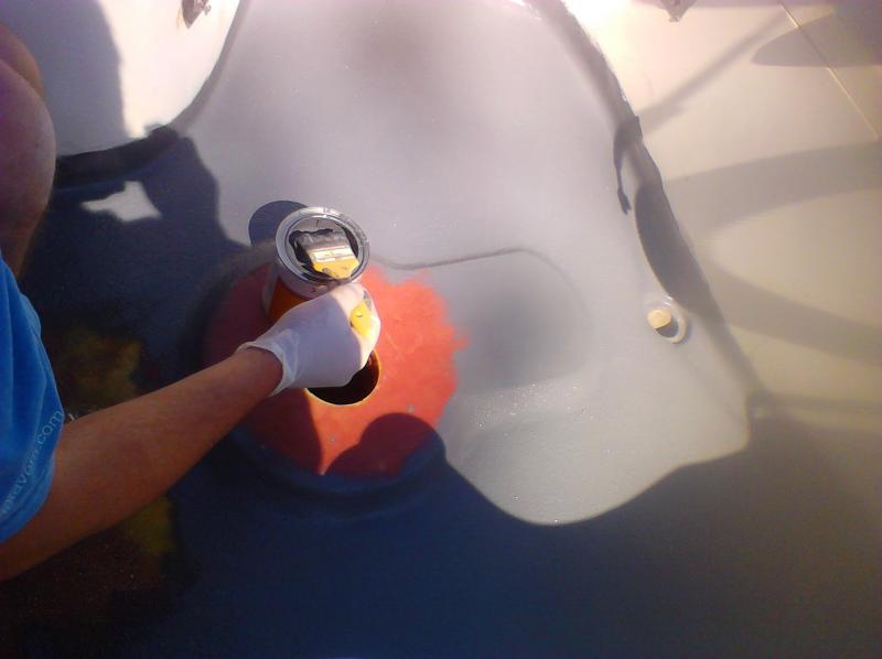

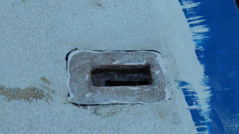

Thanks John, Thats a huge compliment considering how much experience you have in fiberglass work. I have been a fairly skilled carpenter for years but only since getting the boat 2 years ago have I began learning the "in's and out's" of GRP construction. Pretty amazing stuff really, other than grinding I have found it a lot of fun to work with. I too have adopted the idea that an ounce of prevention is worth a pound of cure. I have included some pictures of my project to raise the chainplate covers to achieve the same outcome.
