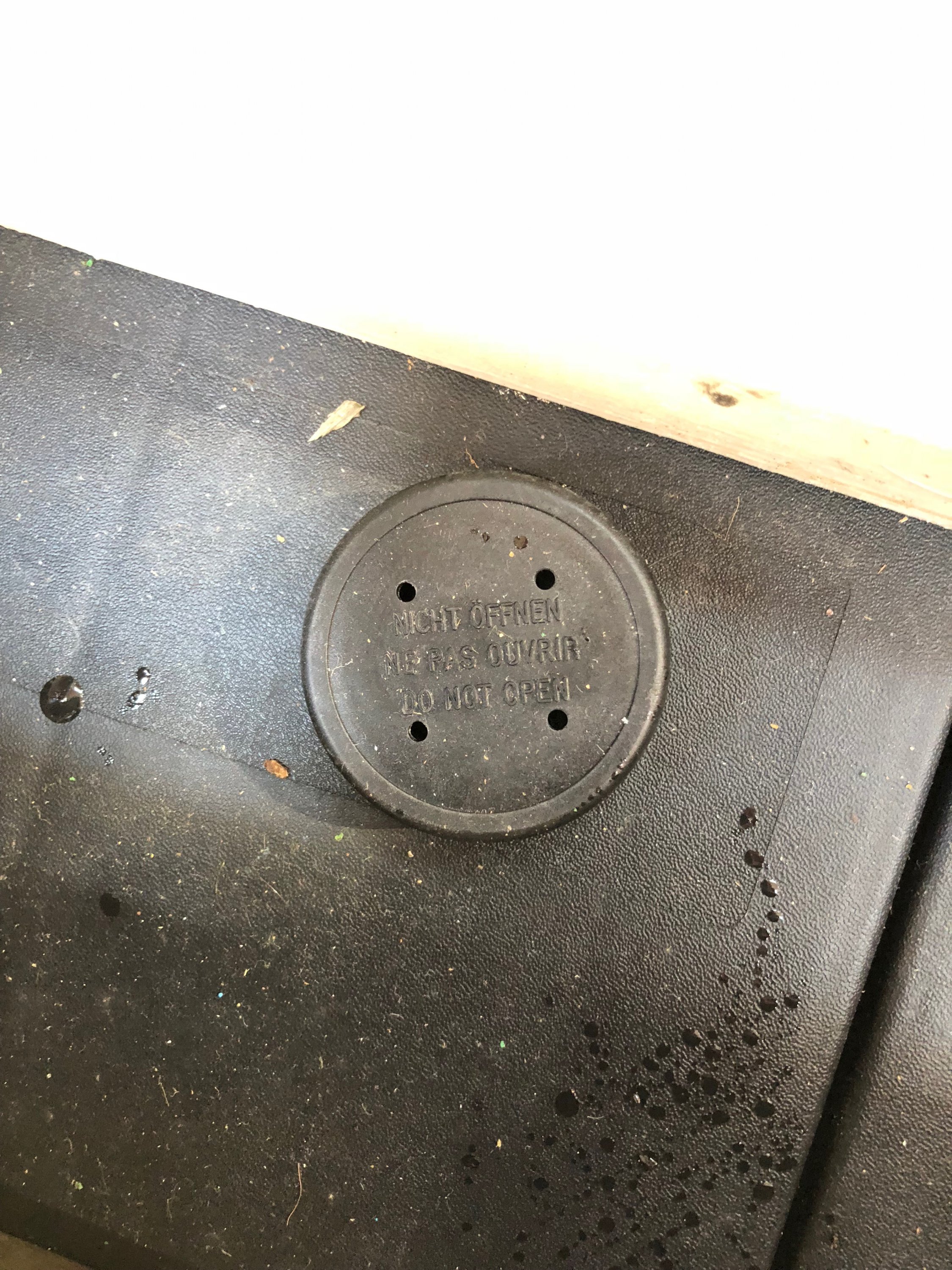

I had no issues over the winter with my (I assume) 4D batteries, but once I launched this season I came back a week later (lots of rain in the NE) and Battery #2 was in the red.
I ran the engine for 30 min and then left (more rain), and the next weekend Battery #2 was in the red. I ran the engine for over an hour, and while it looked initially like it was charged up, the needle dropped and dropped until it was back in the red. So I have 2 questions. First, I have never put water in these because they clearly say not to open.
First, should I have been ignoring this warning and instead opening and putting water in them??

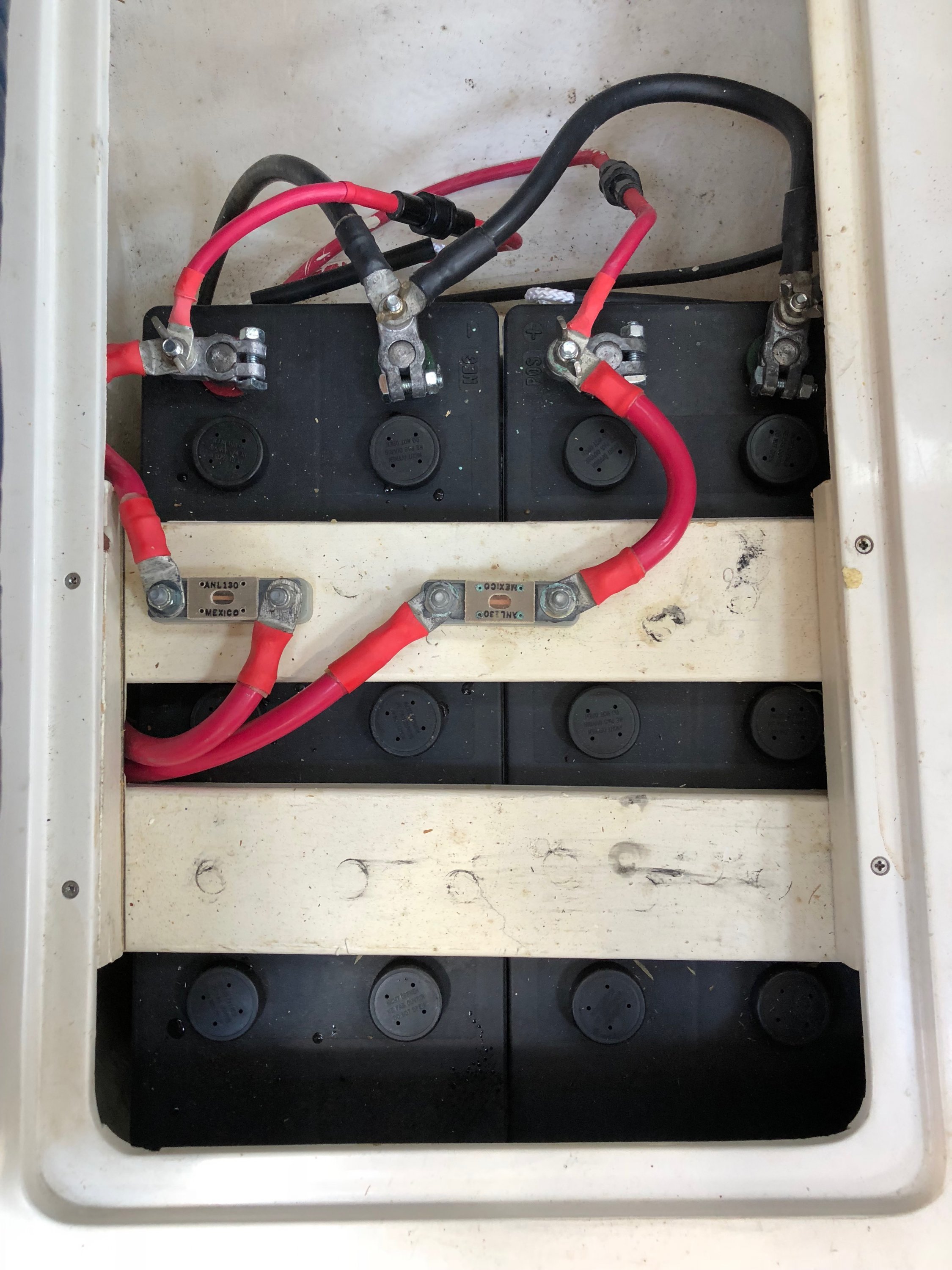

Charge the batteries, disconnect the #2 ground and grab your volt meter. Immediatly after charging measure the voltage. wait 15 minutes and measure again. A slight drop to normal resting voltage is normal. a drop below that is a clear indication of an internal short and the battery is toast. If both are the same age then it is probably time to change that one too but you appear to have the batteries electrically separated so if it goes it will not take the new one with it. You can replace a single battery with the same size (volts and AH capacity)

Yes these look like 4D from the pictures. You can do some testing to see if these are dead but if you had these for more than 5 years it may not be worth it.
If it was my boat, I would pull these two batteries, bring them to a metal recycler (probably get $60-100 each for the lead in your area as opposed to the core fee). Then go to Sam's club and get 4 of the Duracell ECG2 batteries. Then install these batteries in series, two 6 volts tied together to make a 12 volt battery. It wouldn't be the full upgrade like myself and others have done but it would be relatively easy and would get you running with two banks better than you have had before.
