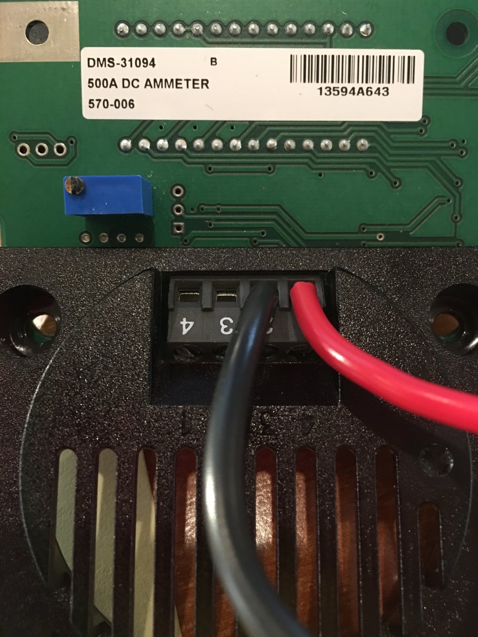

My 500A DC Ammeter suddenly started providing current readings as high as 900 Amps with no decimal and fluctuating between 150-900 amps. The boat and the ammeter are 3 years old and have worked flawlessly until today (typical range was 0-30 Amps, always with a decimal). My system is a 12 volt system and no I don't have anything that would draw anywhere near 900 amps. It showed this reading even when everything on the board was shut down.
I don't think the cause is corrosion as the shunt and connections are pretty clean.
As a first step, I'm trying to figure out the manufacturer of the Ammeter. I think it might be Paneltronics but their part number is 570-006B not 570-006.
In addition, I'm trying to figure out whether there is anyway I might be able to test whether the meter is working properly or confirm that the shunt is working properly.
Anyone know what Catalina put on their 2016 385s? I'm going to reach out to the dealer in the morning but thought someone here might know.
Any suggestions on what might have caused this, which Ammeter I have, and any other steps you might suggest?
This is the label on the Ammeter:

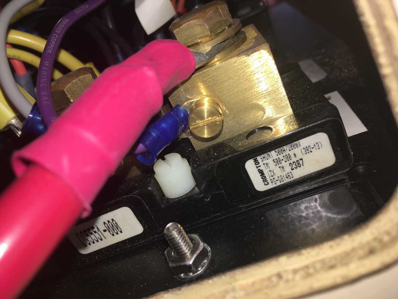

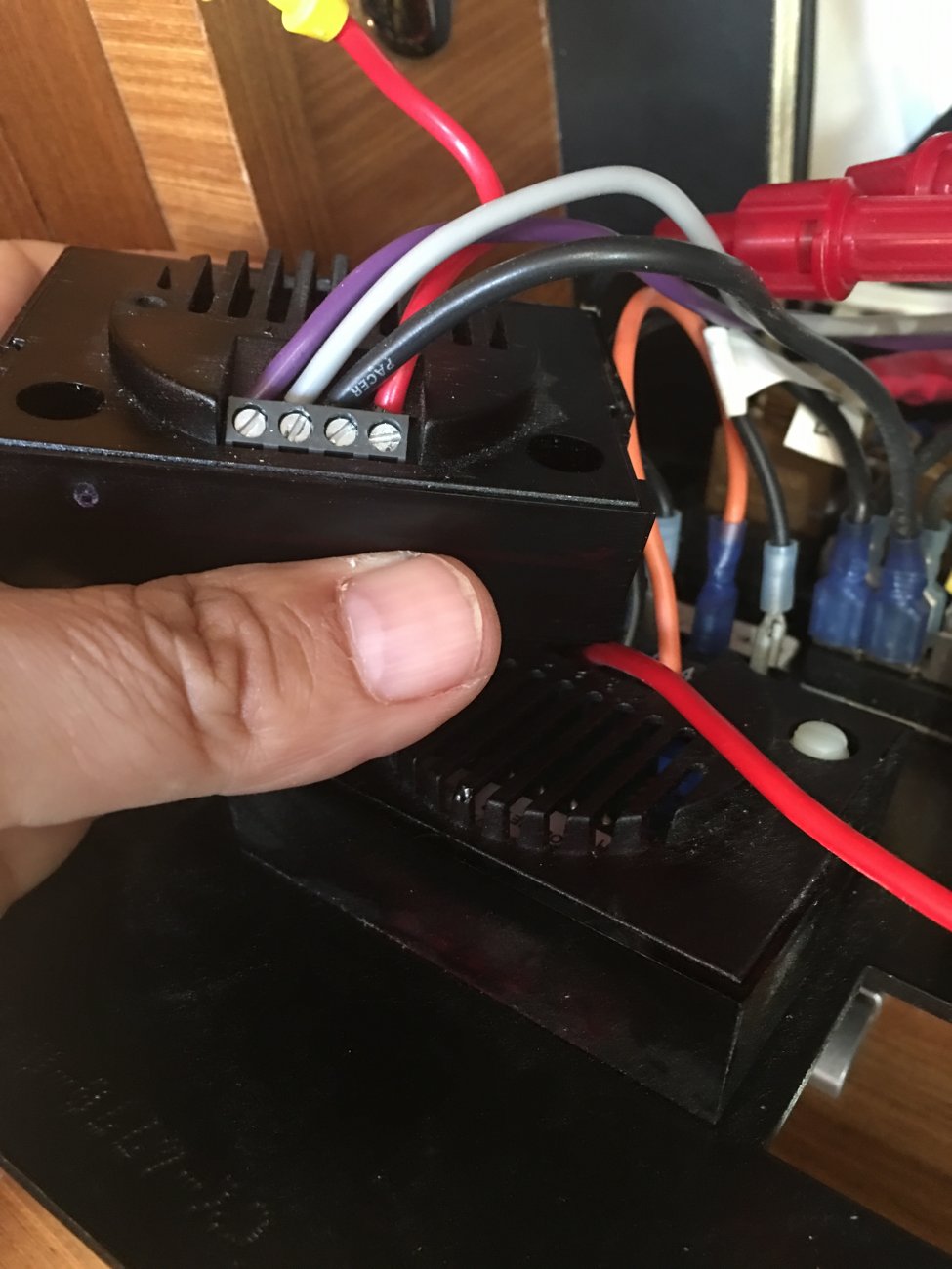

These are the wires going into the Ammeter

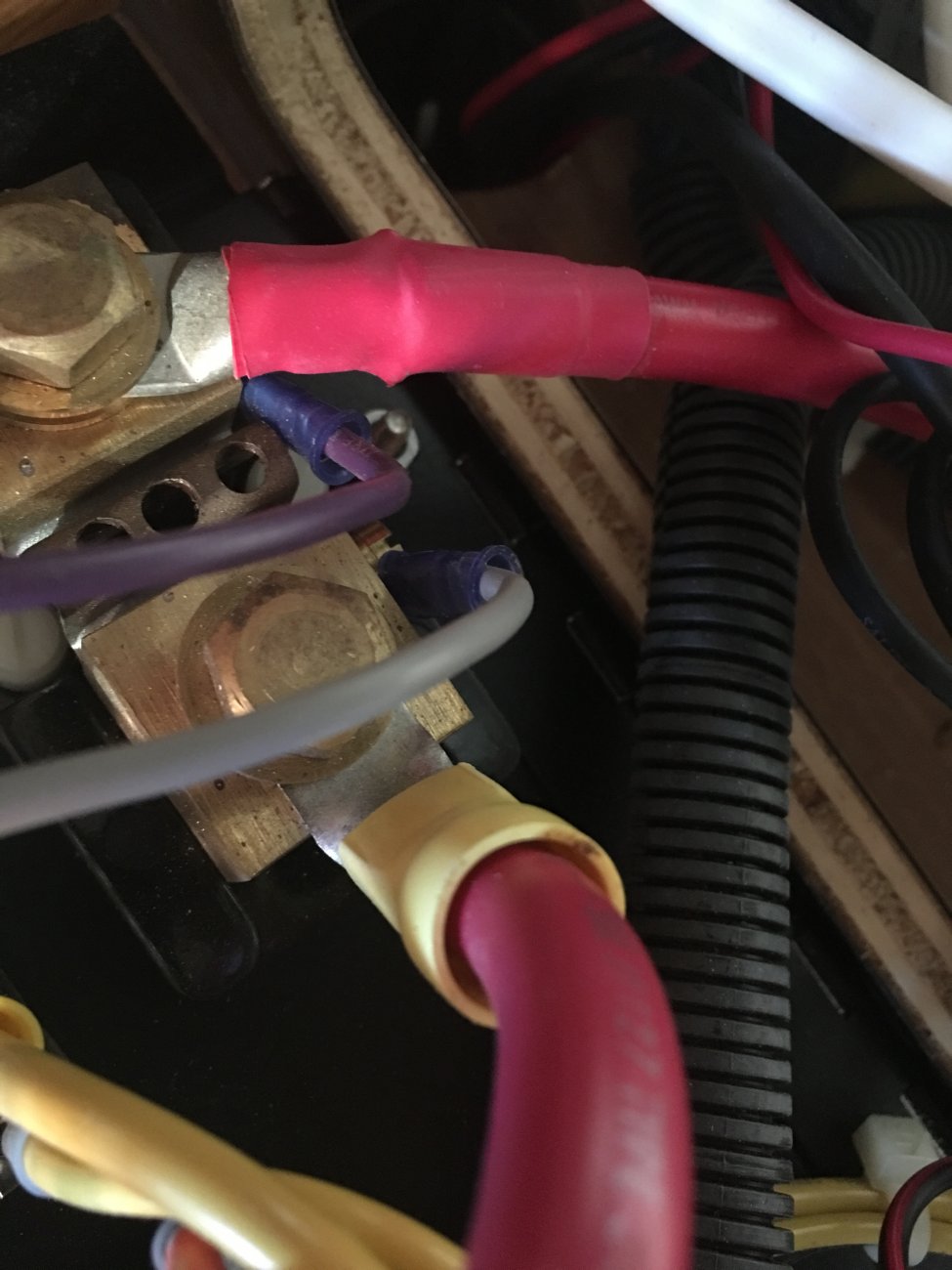

This is the back side of the shunt
Here is the top side of the shunt:

The way the ammeter works is by measuring the voltage across the shunt. You could use a digital volt meter to help troubleshoot that. When you see a strange reading on the ammeter measure the voltage across the shunt. If you get something on the order of 1mV the problem is likely in the ammeter itself. If you see like 300mV then the problem could be a bad connection or failure in the shunt. To confirm test it with the ammeter disconnected from the shunt to ensure it's not putting a voltage on those wires itself.

The label on the shut says that it is a 500A shunt and 200mv. I interpret that to means when 500A is flowing the voltage across the shunt is 200mv. That is pretty typical, but they do vary a bit. My shunt is 500A/500mv.
So the easy way to check the shunt is to turn on some loads of which you know the magnitude. If you can create a 20A load, you should measure across the shunt (20/500)*200mv or 8mv. You need a decent digital voltmeter to make this measurement. If you get anything close to the 8mv, I would believe that the shunt is working just fine.
Then you know the problem is in the display itself. And from your description of the problem, I would think that the display/circuitry to be the most likely cause anyway.

Two Dumb questions on “measuring across the shunt”:
1. Can I use the white and purple wires?
2. Please confirm I’m measuring DC volts and not current
May 17, 2004
5,819
If there purple and white wires are the ones that go to opposite sides of the shunt then yes those are the ones to measure.
Yes, definitely DC volts, with a meter that can measure in the millivolt range. That is basically the same process that the ammeter takes to show amps.
