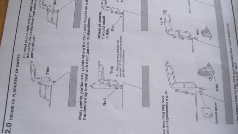

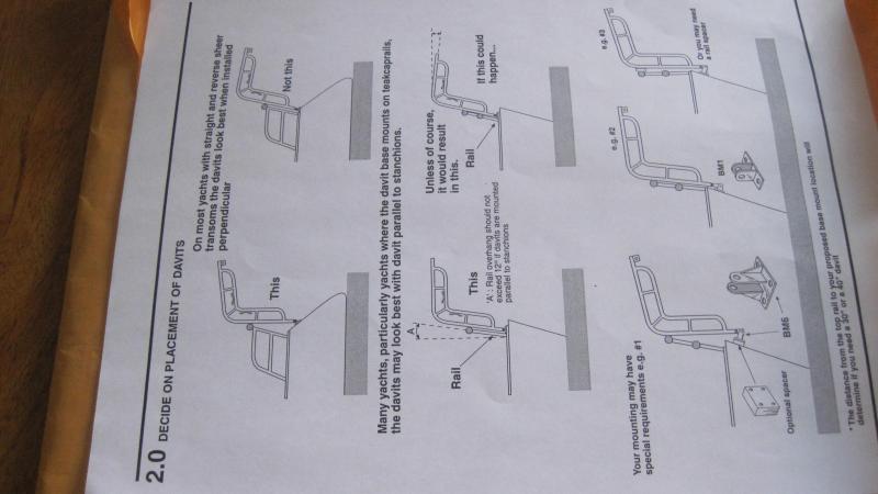

Here we go trying to explain this.
The bottom of the davit post should be bolted to fiberglass part of the stern and than maybe half way up the davit should be bolted to maybe the stern rails.
Don't know if that helps,have you looked at other sailboats that have davits and how they are installed.
I have a newer H-36 with walk thru stern and pretty much as I said is how they are installed.
