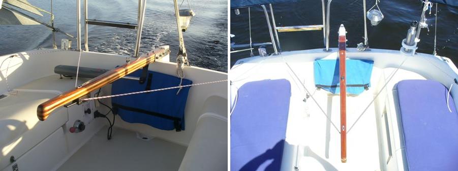

I use a 5’ bungee attached to the stern rails with one wrap around the tiller. It lets you move the tiller off its set position with ease. The wrap lets you position the tiller anywhere you want it and yes it does get in the way but it is easy to work around. When not in use I just hang it form one of the stern rails. The only other down side is that I go through one bungee cord a year, the cover gets worn off at the tiller.

I catch it when handling the motor. Also, I have a Mac 25, so I sit farther aft.

Then your 25 must be built like mine where the cockpit is open all the way back to the transom. You can see on Cuscus's that his does not do that. I'd already noticed his being much different than mine inside the cabin in my thread about keel winch handles.

Voltzwgn; The closed end of the cockpit on the Cuscus's 25 is a mod he did. (A very nice one too!)
I purchased a tiller tamer this summer. I think a bungee would be more suited to my needs. That said, I do use it. But its in the way... either the line or the plastic piece.
It does work. Just not to my tastes. I'll be trying Eric V's bungie idea before I install it on to my new tiller.
