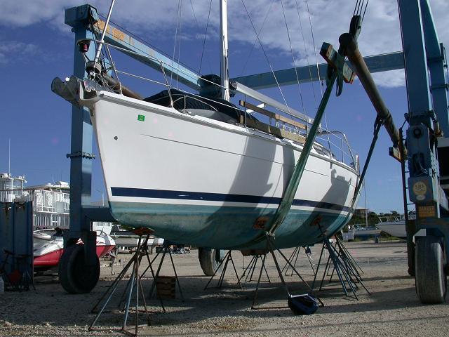

It sure looks like just about every keel bolt was leaking or had leaked (lends credence to Franklin's theory). Multiple groundings and a bad band-aid job probably did her in.
I would like to see the full USCG report and what findings, if any, there were about pre-accident delamination or other hull damage. From what I've seen of previous investigation, it wouldn't surprise me to find that significant questions weren't asked. I was closely involved (although not formally) with one case in which the inquiry concluded that it was God's fault because of "improvements" made to a vessel's stability. The naval architect's claims were accepted without question. You only had to add two numbers in one column, two numbers in another, and divide the result to prove that the claimed stability improvement could not have taken place. This vessel could only be heeled to about 35 degrees by wind before capsizing.
Speaking not to the specifics of this case, since there is a lot of information I don't have, but commenting on the general design for the benifit of anyone with a similar keel connection:
The photo evidence and the keel bolt configuration indicate that there was no significant stiffening of the large and essentially flat panel the keel was bolted into. This would actually have made the design quite tolerant of grounding strains due to its flexibility. The photos I posted above indicate fairly massive deformation at one point but fiberglass is a fairly forgiving material. I wouldn't take the groundings by themselves as proof of the structure being weakened significantly below its as-built strength. If there were any stiffening members, the keel bolts clearly weren't tied directly to them.
I also would not take weeping and minor leaking as proof that there was pre-existing structural degredation. The whole structure appears so flexible that maintaining the seal along the joining surfaces of the fiberglass and metal would have been very difficult. This very flexibility is also protecting the fiberglass structure from excessive strains.
I don't buy the theory that impact load from the keel knocking around on loose keel bolts was a factor. The flexible and relatively unstiffened bottom would have been an excellent shock absorber. I don't rule it out or the possiblility that the structure had been previously weakened. I'm just saying I haven't seen any real evidence of either and plenty of indication that the design was as strong as when built at the time of the accident. My experience with wreck inquiries both here and abroad does not cause me to let the press release influence my thinking very much.
My point in taking time to write this, aside from procrastinating on going out and firing up the snowblower in 35 knots of winter wind, is not to make any claims about this particular vessel. If you have a vessel with a keel and hull connection of similar design that has not been subjected to grounding strains, I don't think the findings of this inquiry should provide comfort for taking her out in conditions like that of the accident night. Failure may not be inevitible but the keel strength should be factored into vessel management and course decisions just as many other vessel characteristics and vulnerabilities should be. Racing is, of course, not very conducive to appropriate decision making about such things.
Bottom line: Keel / hull connections of this type may be adequate for normal use but NOTHING about the press release and information available in this forum should be considered as adding any weight to that proposition.

It sure looks like just about every keel bolt was leaking or had leaked (lends credence to Franklin's theory). Multiple groundings and a bad band-aid job probably did her in. Someone obviously knew something was amiss due to the obvious attempt at minimizing or stopping the leaking via marine sealant?:doh::doh: IMO that keel should have been totally dropped, and the laminations fully examined and repaired, before a re-set... Note the forward keel bolt it is about three threads short of the top of the nut...:confused:
Even if they did need to repair the keel stub, and or add more glass, the builder left them NO room to do so as the keel bolts are cut flush with the nuts???
Hello all,
I need to check with the powers that be how much detail I can provide. The report would be comical if a man had not lost his life. It's quite obvious the report is one sided and not remotely complete. The fact they are making TAMU use the Freedom Of Information Act to view that nonsense speaks volumes.
I need to make this quick to eliminate timing out again, I'll write a complete response offline and post here and elsewhere as things progress.

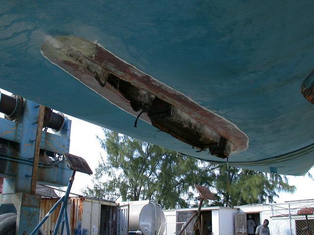

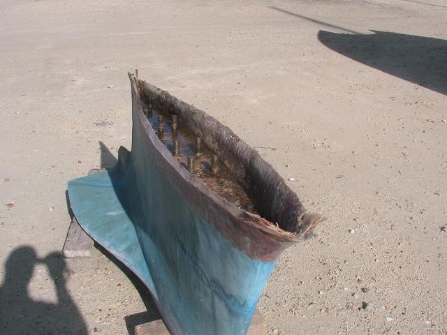

I'm the guy who built Hull #1 (commonly referred to as the "Prototype",) the tooling for the boat and created a boat company for Mitchell. The boat was built by eye, without drawings. They altered an undesigned boat and reinvented the wheel.
Optional keel choices resulted in the non performance barn door lead slab seen in the photos.
The shim is the weak link providing all the errors. The shim allowed massive wagging, the shim (required due to lack of communication between Marek, Mars and CFYW (Mars buitl to the specs they sere give.) More on this later.
The shim allowed water to enter the boat after normal sailing. The shim allowed the keel to wag and eventually saw through the lamainate and fall out of the boat. The shim.........made for lack of showing threads on the first bolt.

Incorrectly sized and shaped backing plates also added to the sawing away of laminate.
The shim was fabricated to hide a huge HUGE screw up. More on this as well, but not to be overlooked.
Hull thickness......ONE HALF INCH!!!!!!!!!!!!!!!!!!! Massive INLINE bolts! No attempt to tie the floors or any structure to the bolts.
The boat was given to the sailing team, one must presume to be part of a sailing/racing program. They did infact enter several offshore events with the boat. I am not exactly certain which rule they raced under, but both IRC and ORC events require a boat to be built to ABS standards. I am not going to site the exact rule but a search for ABS rules concerning hull thickness vs. keel bolt size will yield shock and anger.
"Built to industry standards"? Hope the standards change. Those aren't standards any builder I know or ever worked for would build to. USGC ................SHAME on you!!

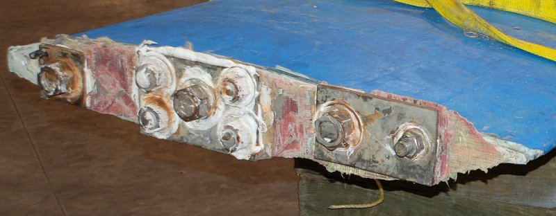

Just curious... but it shows three separate backing plates for the various groups of keelbolts. Wouldn't a single backing plate covering the entire area for all the bolts have been much stronger...since it would have had much greater support by the underlying laminate—where the spaces between the various plates currently exists??
There were floors between the backing plates and they remained in the boat with the students' repairs. Problem was they never tied the floors to the bolts.

If that was the case, why didn't they make the bolts longer, and fill the space in between the floors with solid fiberglass support blocks and then run a single large backing plate for all the bolts, over the floors and support blocks. That would have tied the keel to the floors and greatly reduced the chance of the keel falling off.
From the sounds of the existing design, the only thing holding the keel on was really a fairly thin layer of laminate, which was attached to the floors, but once the laminate sheered, little else was holding it on.
By putting blocks into the spaces between the floors, it would help spread the force of any torque on the keel to the floors themselves—since any torque of the bolt would require the blocks to turn. The single larger backing plate would require the floors—which I am guessing were fairly substantial from the spacing of the gaps between the existing backing plates—to tear before the keel could be lost.
Also, inspecting the damage of the relatively thin laminate between the floors was likely to miss any significant damage that did not have an immediately visible condition, due to the floors being in the way.
Sailing dog, you totally got it. Only problem with the extended bolts and backing plates is reduced standing headroom. Mitchell insisted these boats have over 6 ft standing headroom.

Seems other boat makers also believe small individual backing plates is better then one big one because Hunters are also made with the same type of backing plates and I've never heard of a Hunter loosing it's keel and yes, many Hunters have beaten the same path as other boats.
The main difference I see between my connection compared to there's is that I have 8 keel bolts and they have much less then that, so I guess that means I have more support then they do with the keels weighing about the same. All my bolts have about an inch of spare threads and they are about an inch or more thick.
I guess my point is, I don't think the design of the backing plates is wrong, but maybe that they didn't have enough bolts with a backing plate for each giving them more support.
Anybody know how to determine thickness of glass without dropping a keel?

Seems other boat makers also believe small individual backing plates is better then one big one.
Better for what, the customer or the bottom line?
There is certainly nothing wrong with individual backing plates though but, you are missing the point. There was nothing wrong with either the bolts or the backing plates on this keel. That's the essential ingredient in the USCG consulatant's whitewash.
Put that keel onto an appropriately thick and stiffened fiberglass structure without a compressible shim on the outside and it probably would be fine (except the bolts would be too short in this specific case). Run longer bolts up through proper structural floors on a hull bottom of the same thickness and it probably would be fine.
You are looking at the wrong end of the horse:)
Franklin,
How about a Hunter loosing the entire keel stub?? This is more in line with the failure experienced on the Cynthia Woods. The backing plates held but the glass did not. The backing plates held in the photos below but the glass did not..
P.S. I did not take these photos and am only re-posting them.

Do you know what model that is? Everything looks the same as mine except on major thing...that stub is supposed to be 2' deep. Did they fill in the stub to add weight to the keel or was it made that way?

Something just isn't right about that picture...besides the keel not being on the boat :) Where are the nuts? Are they below the water? If so, why are the keel bolts so long? Is that all metal? If so, it seems like it would be way too heavy.
