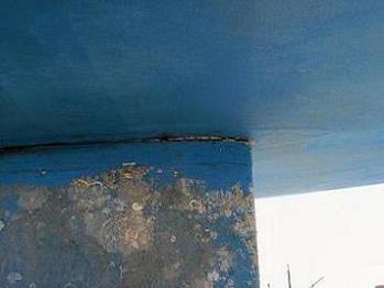

Good to have information straight from the horse. Would you mind adding to our understanding of this incident by answering some additional questions?
I see in the picture posted above that the backing blocks remained on the keel and the keel bolts are intact. As the inquiry found, the keel was clearly strong enough. There must be remnants of the fiberglass hull attachement left between the backing plates and the top of keel. I think I can even see them and their sheered edges.
Do you think this was a failure of the hull supporting structure?
How did loose keel bolts contribute to this?
If they were loose, all I can think is that the motion of the slight slack created impact loads well in excess of the design conditions.

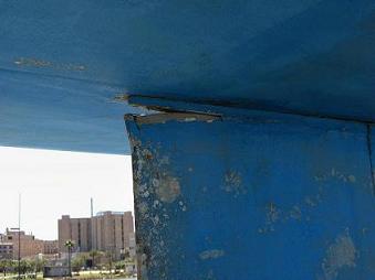

The two pictures below were taken after the grounding and published shortly after the accident. Note the extensive crushing of the fairing block at the trailing edge and the tension separation evident at the front. Do you think this can be explained other than by significant deformation of the bottom structure?
Do you think simple retorquing of the bolts would have been sufficient to restore a fiberglass structure deformed to this extent to original as-built strength?
You say your backing blocks are the same size. All forces on a structure like this are translated into vertical strains. The backing blocks appear to be just about the same size as the keel so the fiberglass hull is sandwiched between them and the two clamping surfaces put the fiberglass skin in sheer. I can't see any evidence in the picture previously posted of the bolts and backing blocks being above any floors or other structure to spread these forces out into the hull instead of concentrating them at the edges of the backing plates.
We now know, courtsey of the USCG, that the entire structure was adequately designed so can you explain how the hull bottom was reinforced to stiffen it and carry keel strains out from the keel?
You report your keel backing blocks being the same size. Are they in essentially a flat bottom panel as seen in the photos below or is there a molded stub so that the fiberglass skin quickly turns 90% close to the backing blocks stiffening the area locally, bringing the major stress in line with the skin, and minimizing the secondary panel flexing that can take place right around the backing plates?
BTW do you note in the pictures the outline of an original, larger footprint, keel evidently contemplated at the time the hull mold was constructed?

Roger, here is another shot of the keel top.. Pretty high res.. you can zoom in pretty tight to look at it. The pics are from the Texas A&M website.. Look at how the aft backing plate is dished.. Assuming it was straight when built, this pretty well shows that the keel had been doing a pretty good transverse wobble.. I don’t doubt the Coastie’s statement that it was designed properly.. I did a thumbnail calc with some rough assumptions and it has plenty of glass to hold it IF everything is in great condition.. The first picture I posted shows the forward plate is dished too. Man there is a lot of 5200 on those center bolts!
Nov 22, 2008
3,562
Endeavour 32 Portland, Maine
Wow. Talk about putting your dirty laundry out in public. Those are great and detailed shots:
www.tamus.edu/.../cynthiawoods/keelphotos.html
This one in particular:
http://www.tamus.edu/offices/communications/cynthiawoods/images/keel2.JPG
I can see the very slight dishing but I'm not sure it conclusively shows wobble. It's similar to the dishing you might see if the material under the plates was crushing from the initial bolt tensioning. More indicitive are the apparent attempts to stop weeping and leaking. I can't see any other explanation for the white stuff smeared all over every bolt. If someone torqued these bolts after the grounding, and it's hard to imagine they didn't, I find the dishing much more suggestive in terms of that not stopping the leaking than as an indicator of wobble.
This is worth reading:
www.sailinganarchy.com/article.php?get=1738
You will note that, at least according to the press release, the USCG is careful to say that the KEEL met industry standards. This doesn't necessarily mean anything but the omission of AND HULL is the kind of careful hair splitting often found in such reports. There are some fairly clear and simple standards for keel bolts that the keel could easily be checked against. Supporting structure is a much fuzzier and difficult to area to get into and there are lots of reasons why the USCG might just not go there. They like to close cases and move on.
In the theoretical perfect engineering design, everything lets go at once. In a weight critical structure like a racing boat, that tells you that you weren't carrying around anything extra. That isn't achievable in the real world and second best is having the failure mode be least catastrophic.
If a keel had come off of one of my designs, wobble induced forces not withstanding, I would like to find broken keel bolts. I would then know that the supporting hull structure had been compatible in strength with the keel. The bottom of the hull is the least weight critical portion of the boat from the performance standpoint so a lot more strength could have been obtained here with little penalty. If this result had been achieved, the hull bottom would have remained watertight. This might have only extended the floating time slightly due to hatches and other topside openings but only a very short time period could have greatly increased the chances of survival for Roger Stone.
