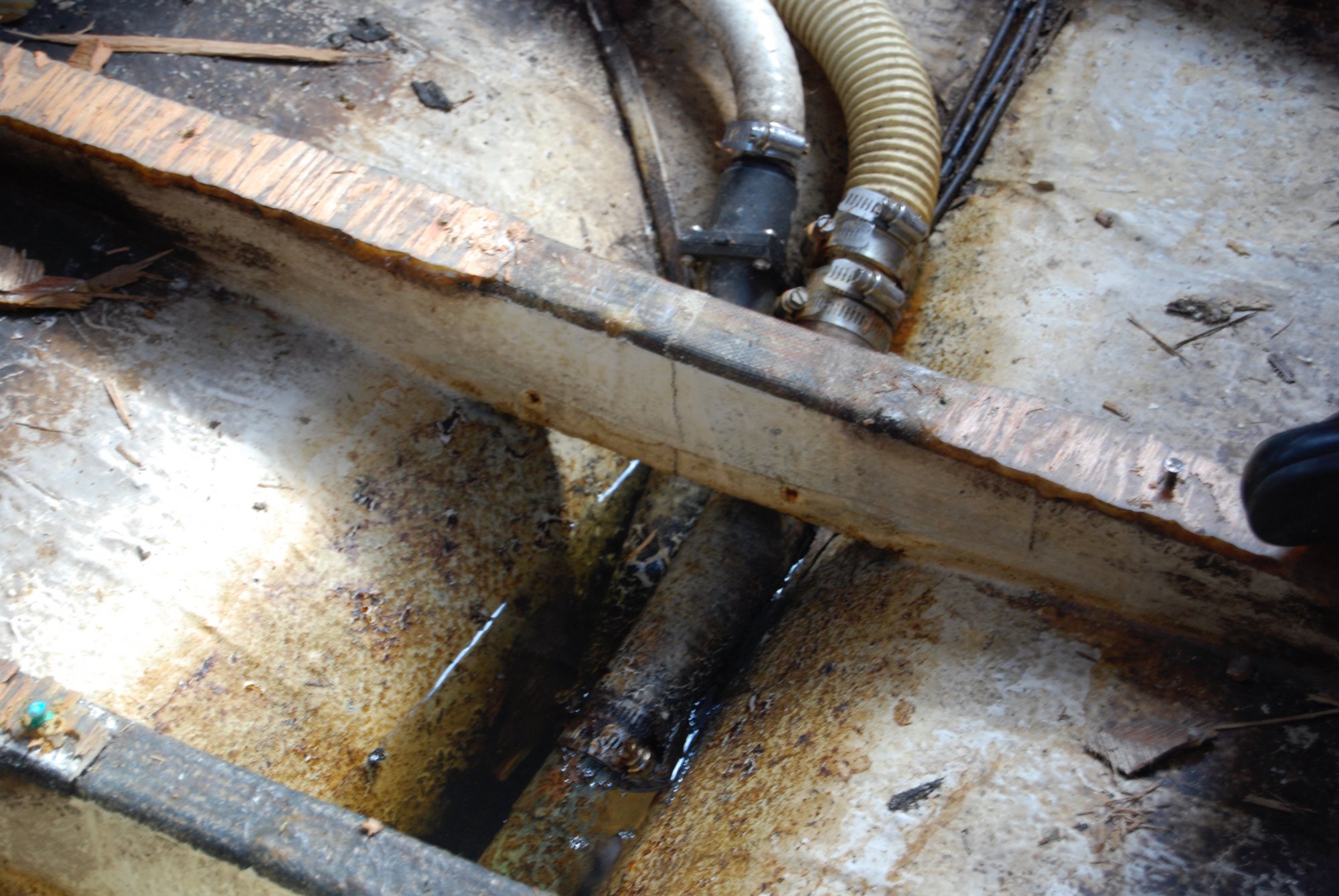

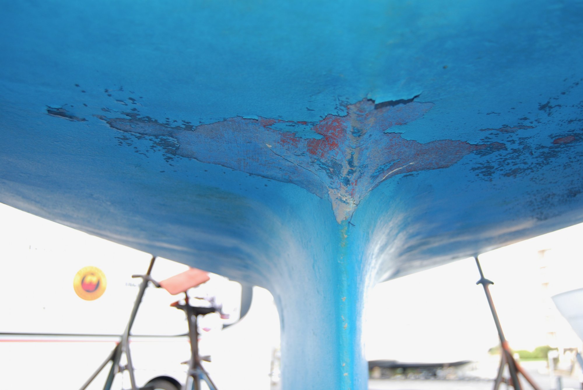

Here are a couple of photos of a boat that went hard aground. There is a crack in the middle of the floor timber. This is the aft most timber, the keel was forced up in the back causing the crack.
The bottom paint is falling off aft of the keel. This is due to the hull delimitation caused by the grounding. The force of the grounding pushed the aft end of the keel up. It was compounded by the leverage created by the keel.
It is my understanding the boat has been repaired and is now actively raced south of Boston.

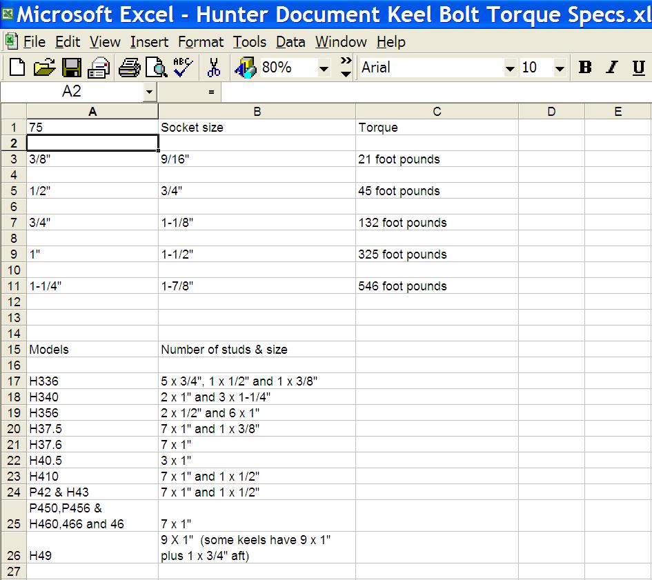

I had my boat surveyed in June 2019 for insurance purposes (20 yrs).
The surveyor called in advance to advise me that he would be checking the keel bolt torque with his torque wrench but it was my responsibility to ensure I had an adaptor for his torque wrench with 1/2" drive. If I did not have one, he would be more than happy to supply a fabricated one for a reasonable cost. Looking into my bilge, I could see exactly what he was getting at.
The threaded portion on that one bolt is 6" long and a radial space of 2-3" to swing a cat. Not ideal for a torque wrench given that the bilge is 12" deep.
Given some welding gear and a few spare sockets, I fabricated a 16" long adapter with a 1-1/4" pipe in between the two sockets and then promptly forgot to photo the thing for my records :banghead:. Next project.
Required torque values came from Marlow Hunter which were also the maximum allowable for that size of SS stud.
I was then able to show the surveyor that all six bolts withstood the required torque without movement. I was able to get under the table easier that the surveyor so I was elected to the job.

Sounding the hull near the keel should have given an indication the laminate was damaged. Looking at the bilge and looking for cracked or delaminated floor timbers would also be a clue. Furniture in the boat that is out of alignment, yet another clue. Carefully inspecting the keel for damage or repair would also be helpful.
View attachment 173523View attachment 173524
