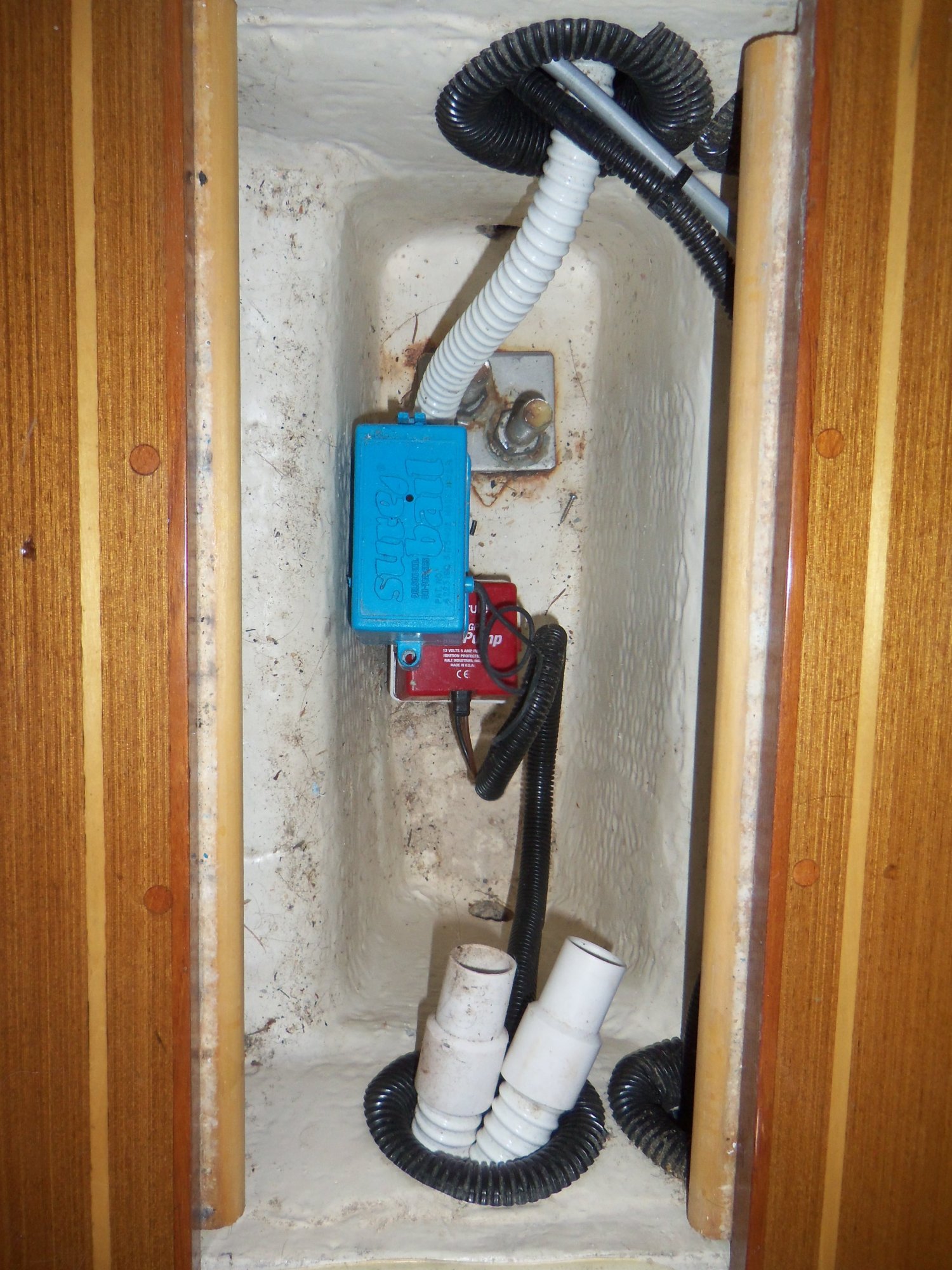

The surveyor called in advance to advise me that he would be checking the keel bolt torque with his torque wrench but it was my responsibility to ensure I had an adaptor for his torque wrench with 1/2" drive. If I did not have one, he would be more than happy to supply a fabricated one for a reasonable cost. Looking into my bilge, I could see exactly what he was getting at.
The threaded portion on that one bolt is 6" long and a radial space of 2-3" to swing a cat. Not ideal for a torque wrench given that the bilge is 12" deep.
Given some welding gear and a few spare sockets, I fabricated a 16" long adapter with a 1-1/4" pipe in between the two sockets and then promptly forgot to photo the thing for my records :banghead:. Next project.

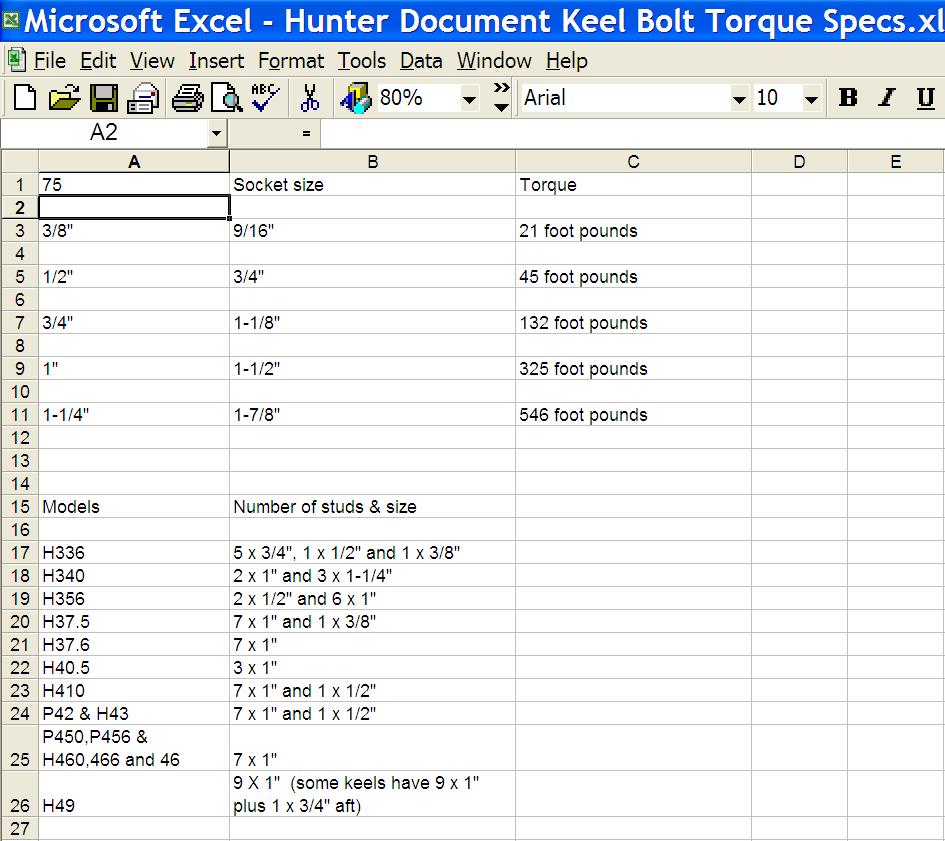

Required torque values came from Marlow Hunter which were also the maximum allowable for that size of SS stud.
I was then able to show the surveyor that all six bolts withstood the required torque without movement. I was able to get under the table easier that the surveyor so I was elected to the job.
