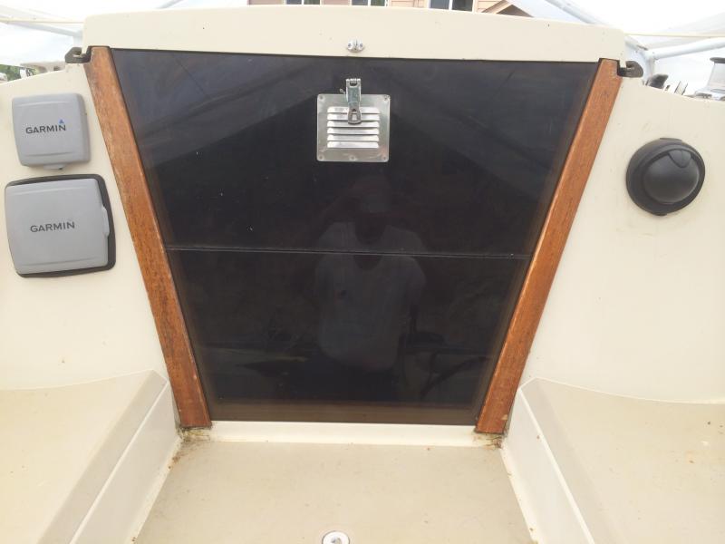

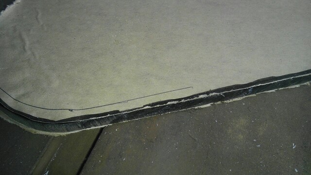

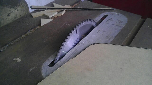

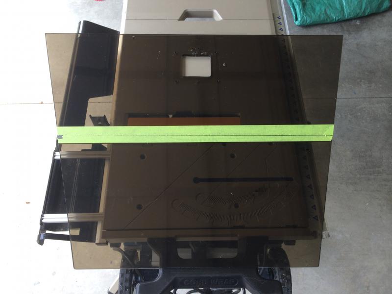

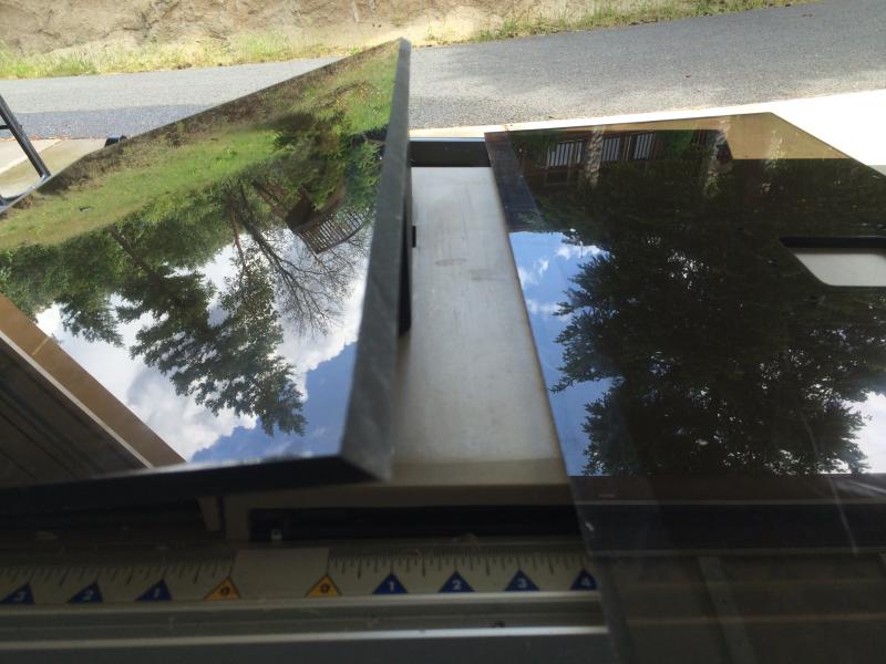

Thanks for all of the suggestions. Using parts of several of the responses, I successfully cut my companion way hatch. A couple of pictures are attached.
The cut was made on a table saw using a Diablo 7 1/4" 60 tooth "ultra finish" carbide blade set at 45 degrees. (Home Depot, under $20.) The acrylic was taped on both sides before making the 45 degree cut (Thanks, Brian). After making the cut, and removing the tape, I sanded the sharp edge of both pieces, just a little, to slightly smooth the edge and, hopefully, prevent future chipping.
The selected blade, in addition the relatively high tooth count, is extremely thin kerf, 1/16", so minimal hatch material was lost from the cut. The result, when the hatch is in place you can't notice any change in fit or height.

Nice clean cut. That should make it a lot easier to handle. Those plexiglass hatches are heavy.
