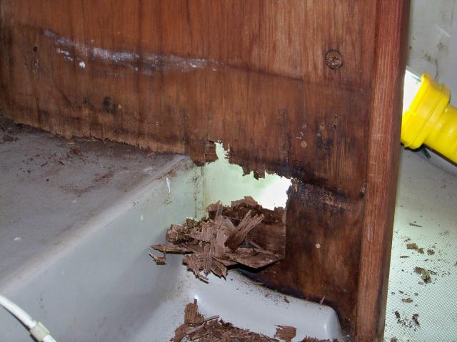

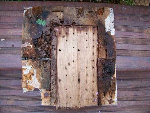

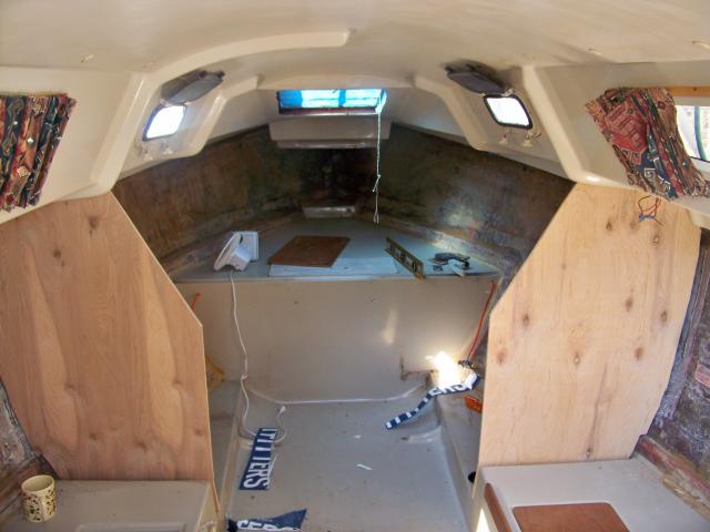

As many of you know I am in the process of rebuilding my Oday 26. It began with redcognition of an oddity: I had a sag under my mast tabernacle. So I innocently posted a question under trailor sailors: "Sea Trek: trouble with tabernacles" As i came to recognize the extent of the problem, I started a new thread: "That sinking feelin..trouble with compression post.". I found out, thanks to all the good advice,that the core of the deck under my tabernacle is rotten. In addition, with all the digging around I found that the forward bulkheads were rotted out along with most of the wood in the head and lavatory, and of course the fabric liner of the cabin is molded. I had many leaks from various areas.

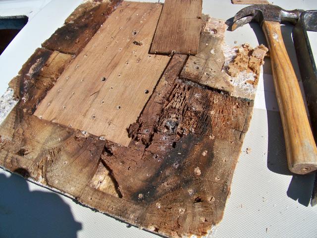

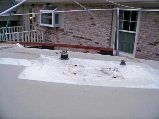

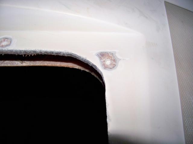

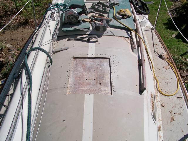

No wonder the PO was anxious to sell. I was a starry eyed dreamer who saw only the beautiful lines of "MY Girl" and had been dreaming of buying a sailboat for years. So, not one to be afraid of DIY projects, I have almost completly gutted her and am in the process of repair and rebuild. So that brings me to the reason for starting this New Thread: I have cut out the top skin and removed the rotted core under the tabenacle. I still had bad ecge, so cut away to away some more try to get to mostly good core. There ARE still a FEW areas that are soft along the edges but no much. I was beginning to get a fairly large area and was afraid to cut more.( I have don casey's books, but sometimes the advice is a little sketchy...i.e. all repairs are on flat surfaces, no edges of wood are "iffy", what do you do if you screw up, etc. ) I would like to get opinions on how to cure the edges so that the wood that is still soft will not weaken the repair.
Also, a big question is "How do i finish the surface?" I want to use west system epoxy and glass matt, but some say (don caseys book) you cant put gel coat over epoxy!
