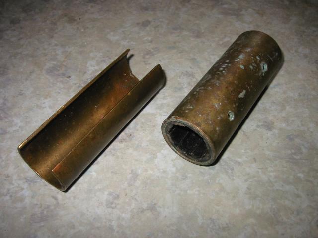

You Need One of These.
I made mine from an old bearing - found in the yard's dumpster.
Lust saw a 1" wide slot out of one side, slip over the shaft, remove the existing coupling's grub screws and tap the sleeve along gently.
Note:- Only works if existing bearing has decent thickness of metal sleeve. Cheapo tuphnol sleeve types don't have enough strength to be pushed out!
Pic below shows before and after cutting.
Good luck.
