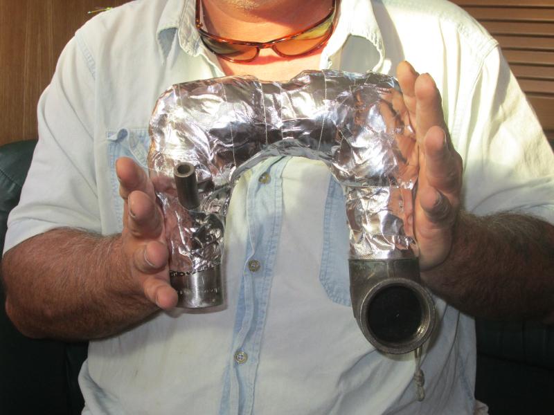

Got the new riser/mixer from the fab shop early this morning. It looks nice and is heavy and solid feeling. All stainless. They re-used the coupling for where it connects to the exhaust manifold and they cleaned and re-used the nipple for the raw water coming out of the heat exchanger. The cost for the parts and for the shop to weld it together was $260.
We wrapped it in an off-the-shelf exhaust wrap from Advanced Auto ($23 for 1" x 15') and then wrapped that in a foil looking exhaust tape ($12 for 1" x 15'). May have to get some stainless safety wire to wrap it up as that foil tape seems to be coming off.
It only took about 10 minutes to wrap it and install it. Worked perfectly!!!!
Very happy to have this working.
Pictures attached.
