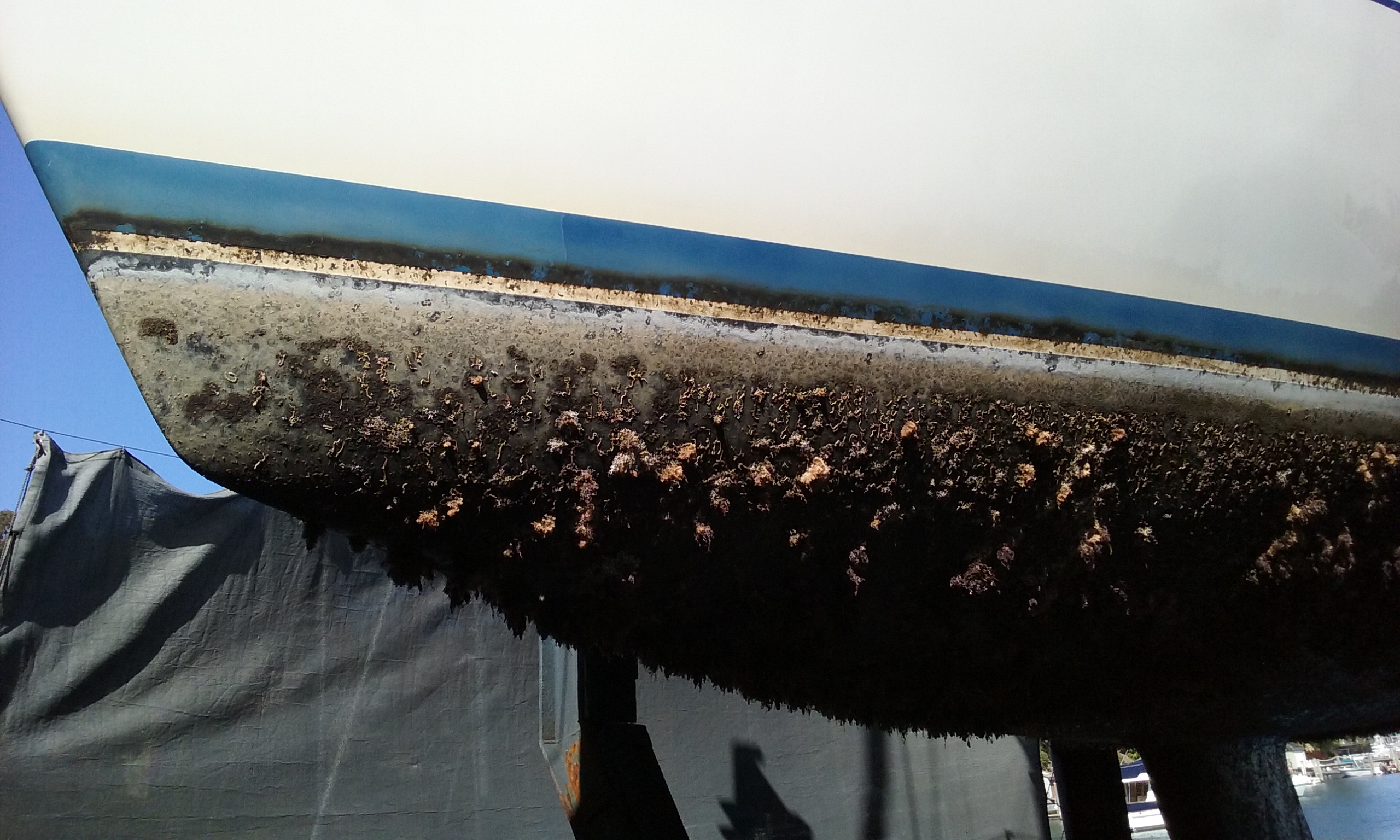

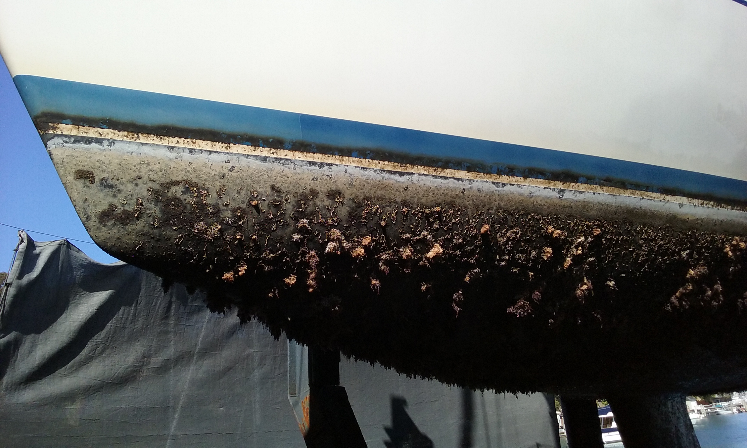

I normally haul the boat once a year. The hull is usually quite clean still, but the prop and shaft always foul substantially. The exception was 1 year ago, when the antifouling had been done by some ‘professional’ that obviously wanted to save on antifoul paint – see attached pic.
However, whilst any of those conditions reduced the speed by ½ to1 knt, the engine has never exceeded 160F. It is a 25XPB – some specs say it is 26hp, some say it is 25hp.

First a fouled bottom and prop as has been suggested. Find out what the diver is going to clean and if not too late get him to take pictures or videos of the finished cleaning. Make sure he cleans the thruhull as well. It is small on these boats and easily fouls over time.

Diver reported running gear was in desperate need of cleaning. Cleaned prop and shaft and added a new zinc. Reported hull was clean with only a few barnacles and they came off easily.
