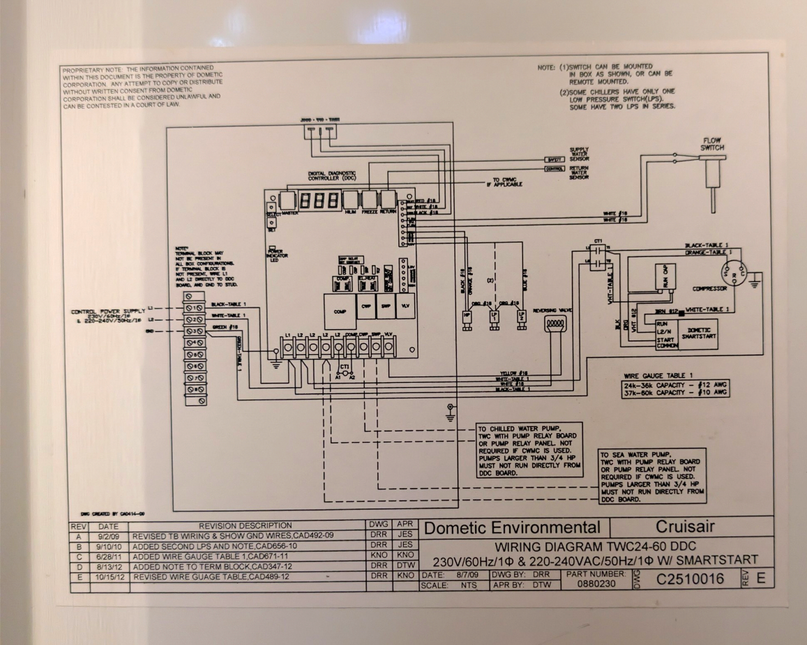

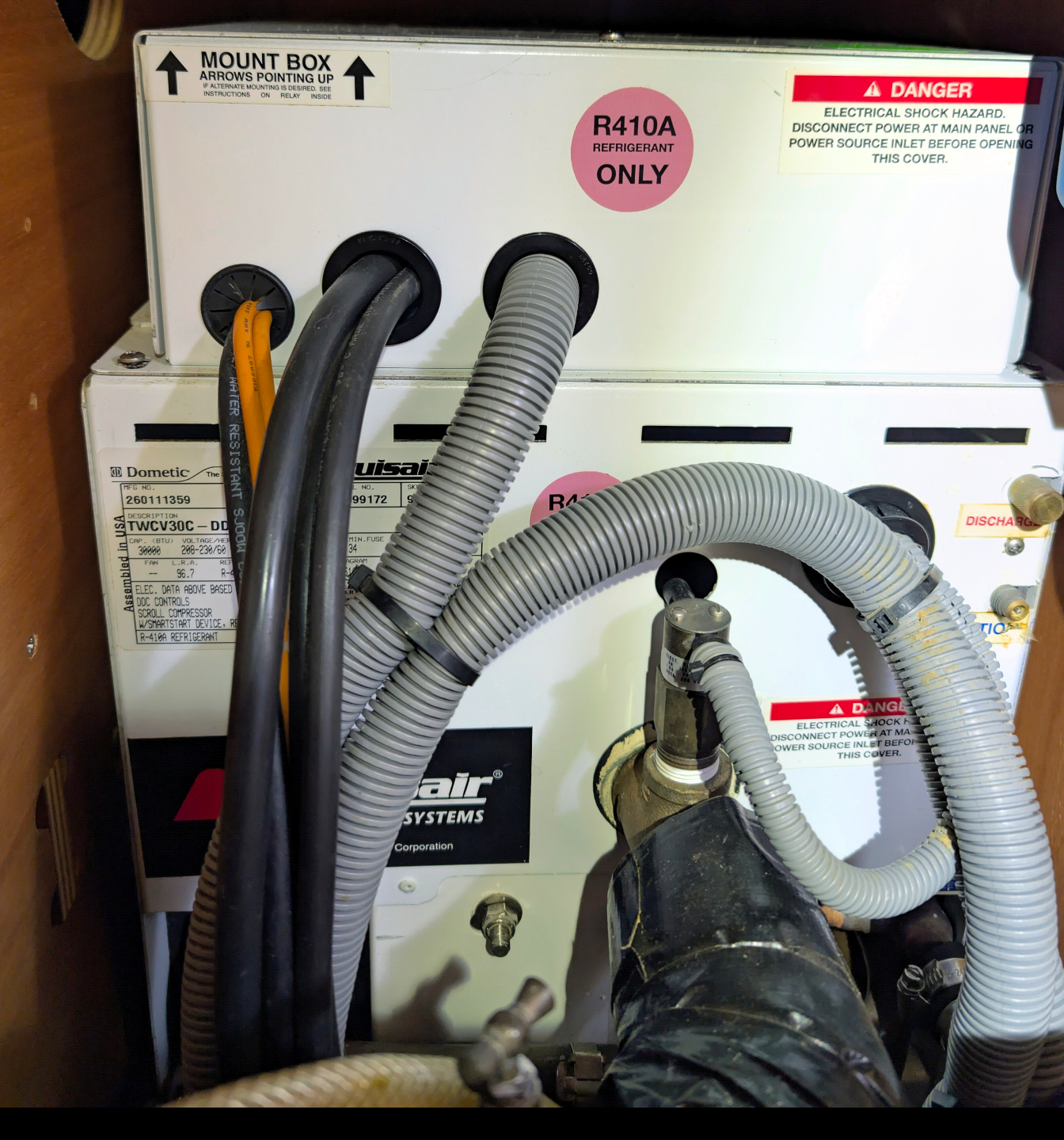

It does not start up at all. Acts like there is no power.
I believe my unit experienced an error, and shut off. Power cycling didn't restart the unit, but then I realized it has an incredibly large capacitor. I left the power off for about an hour, and then the system cleared the fault, allowing the system to turn on when switched to cool.
My new question is: Is there a way to manually clear the faults? Attached is the wiring schematic off of the cover.

Hi Jim,
Yes, it's the only unit on the boat. This unit supplies 4x air handler units throughout the boat. All running the SMX II control pads.
What I don't understand, is the fact that if there's a fault in one mode, it will still start up in the other mode no problem. The logic computer is setup weird for sure.
Heat Pumps are weird.
I am guessing now, but you may be low on refrigerant 404a.
Heat pump reverse cycle may be the KEY. :huh:
