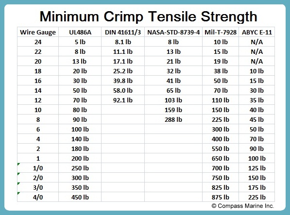

The ABYC minimum recommendation is for these terminations is to hold 35 pounds tensile force. :doh:
WARNING: I DO NOT agree with the ABYC E-11 tensile strength standards and find them pathetically low. It should be noted that the Mil Spec MIL-T-7928 tensile requirement for this same terminal is actually 110 pounds!!!!! I use MIL-T-7928G for my own tools as my baseline/bare minimum. You need to choose what you are happy with..
The ABYC's 35 pounds is pathetically weak in comparison but it is what it is. I personally want to beat MIL-T-7928G NOT the ABYC requirement. I strongly suggest aiming for MIL-T-7928G not ABYC E-11 standards.

Only two crimp tools hit or beat the Mil Spec MIL-T-7928G standard and those were the Ancor and AMP tools.
Here's a chart that breaks out varying standards including MIL-T-7928G:
Please keep in mind that this test is not really about how much it takes to pull the wire out, though it may appear to be that way. Your wire & terminal should NEVER even be subjected to 5 pounds of load on a boat let alone 190 pounds +. This is just how crimp testing is done and performed by all standards organizations world wide.. This is how the Aerospace and Military rate crimped connections along with other measures such as salt spray, vibration, heat, voltage drop and amperage tests.
When researching this the engineers I spoke with at Tyco/AMP, Molex, Rennsteig etc. suggested that the amount of strain required to pull a wire out of a crimped terminal is in direct correlation to the quality of the electrical connection made when crimped. A higher pull strain reflects more wire to terminal surface area interaction and a properly formed crimp that will be near air and completely water tight (gas tight is the industry term) will have a very high pull out number in pounds of force required..
A low pull failure number means little wire to terminal surface area interaction and paths for air & water to migrate up through the crimp and begin corroding the wire.
