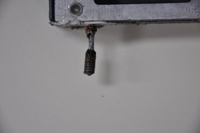

Keels are not the only thing affected by crevice corrosion. I replaced all the clutches on my cabin top this weekend and here is one that I found with not much bolt left. This was the clutch for my main halyard. The core was rotton so I removed all the wet wood and potted the holes. The new clutches(Lewman D2) are very nice and the admiral loves using them.
